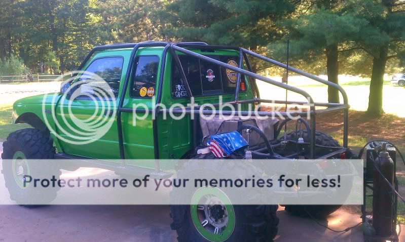

More cage work...
With a bed side sitting in place...what do you guys think??? I kinda like it

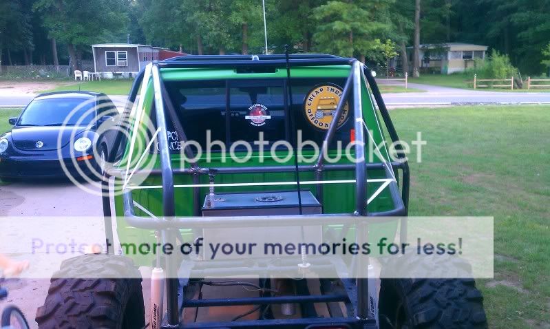

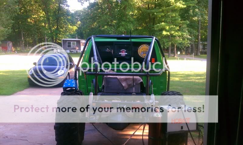

Then the plan for more tube, kinda gonna resemble the tape
Thoughts, concerns, tips?
Second to last pic, the bars against the rear window, where the two come down on an angle, I would add one more on each side and meet at the top bar where the 3rd brake light is (to complete a triangle) for more lateral support incase of a flop/flip. Other than its going good :icon_thumby:
Looks frickin awesome! I like it with full sides better, but these will do until you get those done!

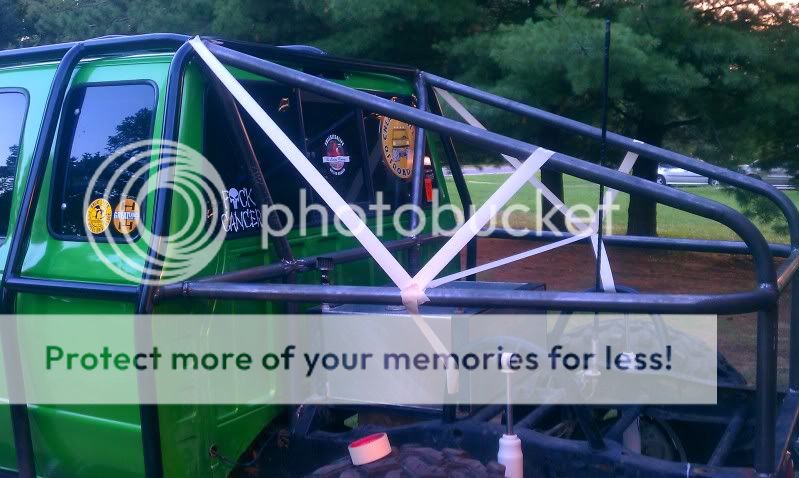

I really like the design. What tube are you using? DOM or HREW?

I am using ASTM 500 GRADE B 1.660 od, .140 wall structural pipe

How much does that stuff run a foot? Will it take a hard roll? Not flop, roll...
