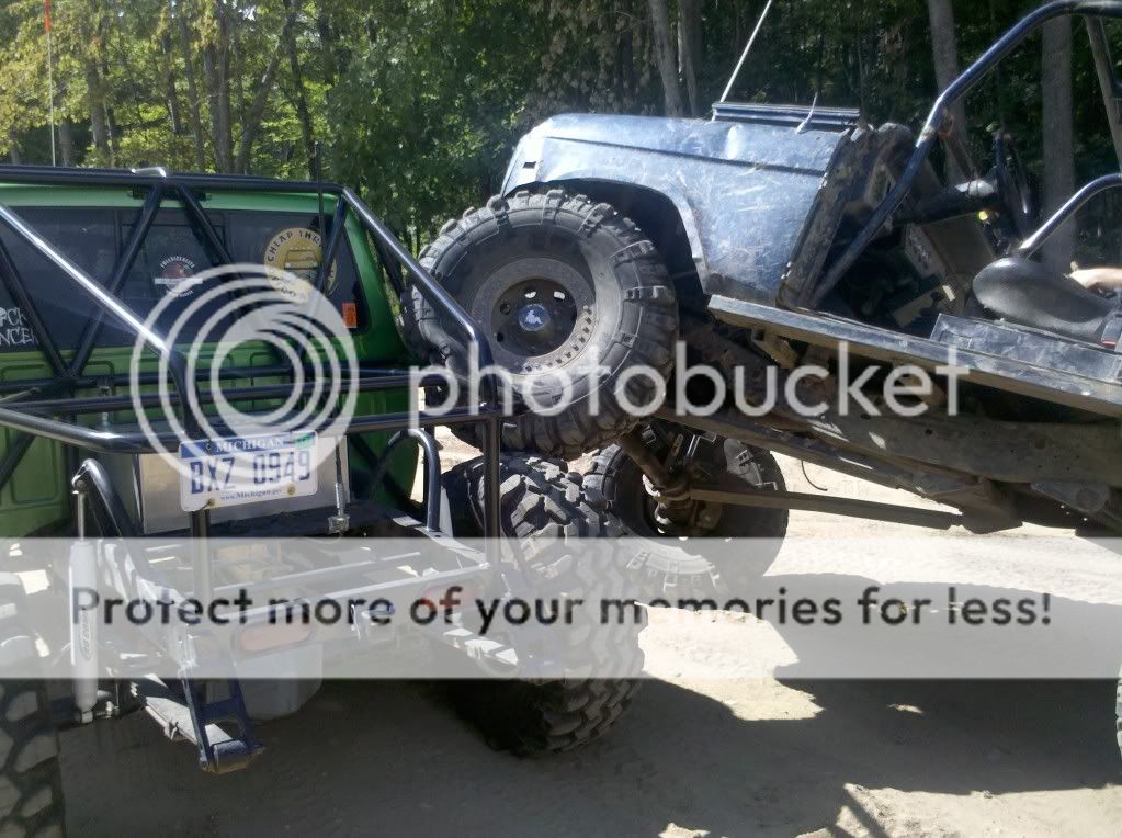

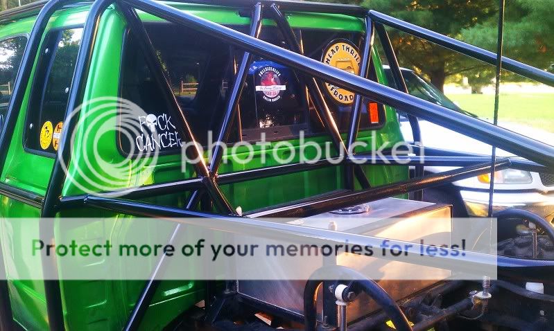

Will it take a hard roll? Not flop, roll...
The cage strength is in the design, not necessarily material strength.
DOM will most likely be ASTM A513 Type 5
80ksi Tensile, 70ksi Yield
http://www.amcastle.com/pdfs/carbonandalloytubing.pdf
ASTM 500 Grade B falls a bit short, but will work if built properly:
58ksi Tensile, 45.7ksi Yield
http://www.eaglesteel.com/download/techdocs/ASTM_A500_Grade_B.pdf
I used ASTM 500 Grade B for the rectangle portion of my sliders. Reference my build thread if you want to see the analysis work that shows how design affects structural strength.

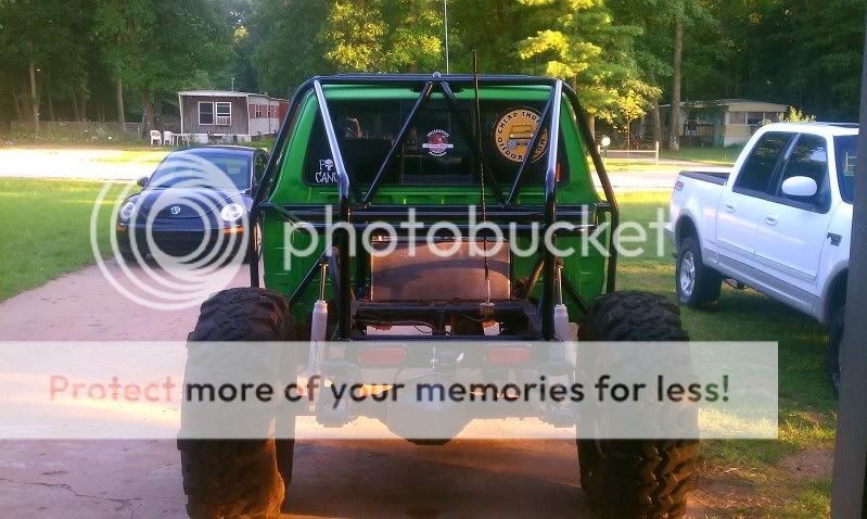

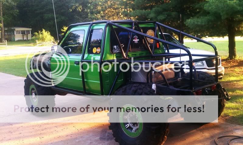

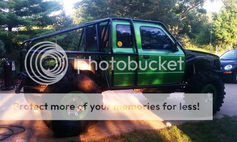

Done for now. Still have to figure out a spare tire mount and do a little more tube work on the upper portion of the bed area and tie into the frame a little more.

looks too pretty to wheel. You going to run rear bed skins?
Lol, thanks.
I'm gonna do bed sides. Just gotta decide on a clean mount. Any ideas?
Aluminum angle for structure to the skins and tube clamps with wing nuts to the bed?
Tube clamps and wing nuts? You mean like exhaust tube clamps?
mount the bed side like they did the sheet metal on Extreme 4X4 with the blog buggy, use those funny looking taps that are welded to the tube, then bolt them on, that way you can remove them easily when they get messed up.
Also I agree with -Nathen-, it's too pretty to wheel, be bad to make look that good, then get it all messed up on the side of a tree, or rock.

There ya go! How was the body roll, is it very top heavy now?
