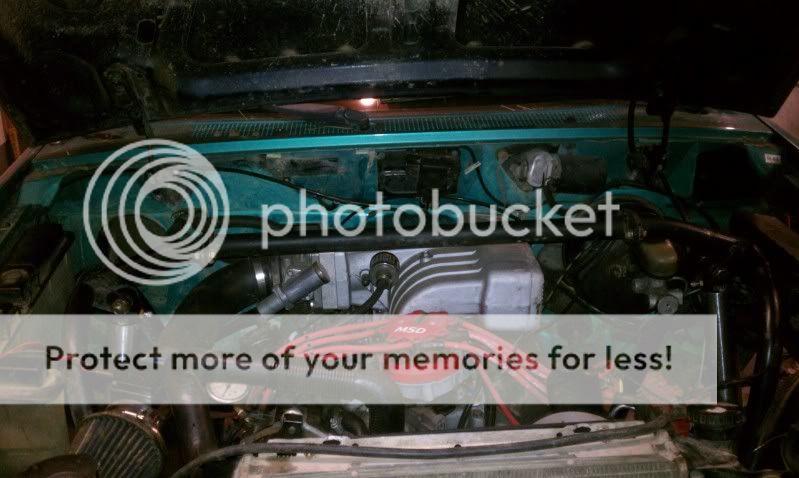

Pic of the motor about wrapped up...looks nice in there

Looks good man. Can't wait to hear how long your shit lasts now. haha. That engine will be fun. :D
Now it will be auto so he won't have to be as hard on it.

I know what you're sayin, but I think his driving style will be similar regardless of transmission. haha
It'll last just fine lol.

mmmmmm
errrrrr
mmmmmm
uhhhhhh
errrrr
mmmmmm
hmmmm...ehh....mmmm:icon_confused:
no.......
.....no that wont last......
do something about that.
and hook the blower motor assembly back up....
He made 1/2 tons last on 38's with tons of abuse (granted v6).
Now with a v8 and tons with 4d's, I think he'll be fine. He wheels no different then me. I have been running the same axles, with the same parts, with the same tires, with the same drivetrain other then he has a 5.0L and I have a 5.8L. I think he will do just fine keeping everything alive.
Pulley to rad clearance... I have the same issue.
There is a solid 3/8" of space, I don't think it will be that big of an issue. If it is I guess I will do something different.
Side note, drove the Ranger last night onto my trailer open headers at 9 at night....it was loud lol
Getting exhaust put on today
3/8 for a normally sprung rig. is not even close to enough.
if you leave power close to what you have now you should be ok for cooling though...
in your case, with the wicked suspension and tied up chassis i have to take back my original assesment because you may just be ok. i would slightly tension some chains pulling the block biased to the rear though.
looking at your current avatar made me think...hell theres no way for the frame to twist the motor and radiator together...i simply forgot how well you had this thing working previously...
my ttb setup needed an inch and a half...my current setup with leaves does as well...i rely on frame twist to some degree...on road handling is solid though. my experience with airshocks left me with the impression they would be off the table for my needs. i still use mine as a truck 95 percent of the time...when its not trail riding or being a snowmobile or ice shanty...
regardless countering the pulley bolts is worth the time if you get a few minutes...but i really dont think permanant damage will occur from the perspective of that pic when they eventually self clearance a bit. grind itself cozy is all...
and they will. unless you chain em back smartly.
my preferred cooling setup is much quieter and runs the fan less and nets more room depending on how you mount the winch. run what ya got and go from there is what i would do as well. if you do run into cooling issues i do have some shit you can try out....so you dont have to waste any money:icon_thumby:
