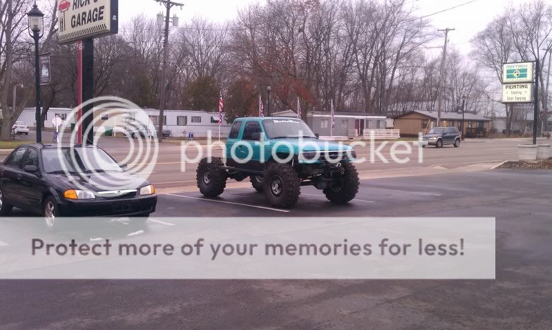

Truck runs and idles now. Exhaust is way to loud, gonna get a different muffler.
Next on the list is shifters, seats and a skid plate. Here is a picture if it at the exhaust shop
I'm in love. :wub:
Any exhaust clips with the current muff? I wanna hear it. :D
