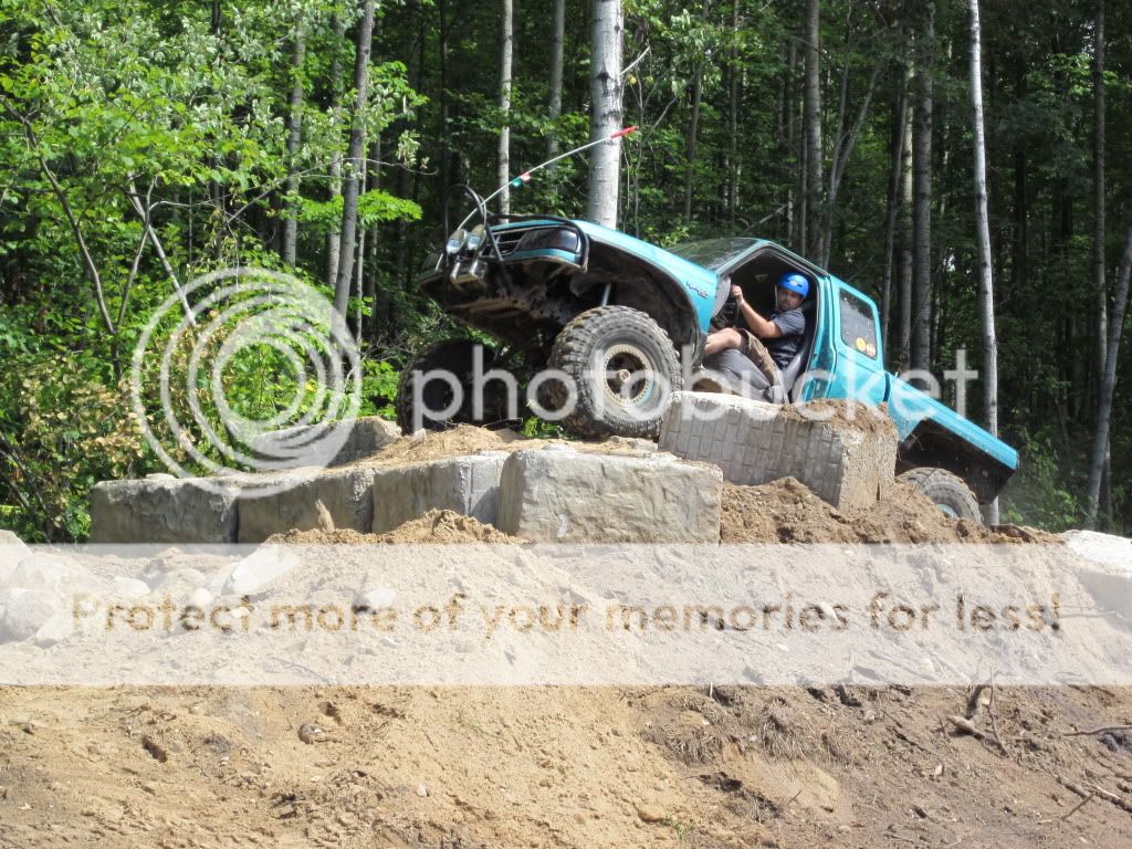

Truck worked great yesterday, gave it the worst/best (you pick) beat down of the year. We ran a club comp at a local off road park. We didn't win, but lets not go there haha.
Here are a couple pictures, hope to have some video later...

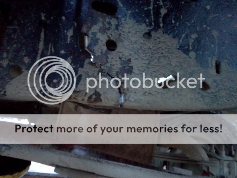

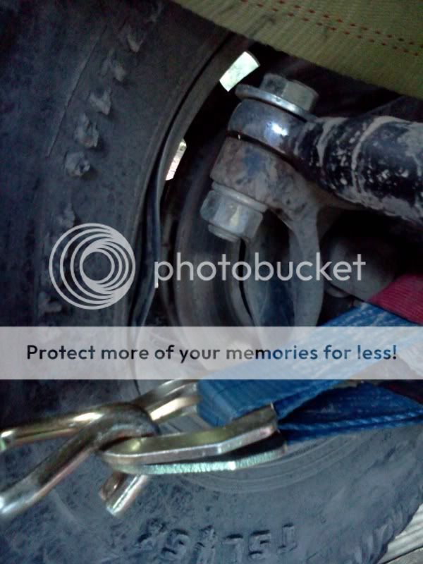

Then the damage I found so far, I bent my front rim, the inner lip, easy fix and cracked the rear frame just behind the drivers spring hanger. It was an area I knew I was gonna have to work on, I noticed it buckling a few weeks ago. From the factory there is a lot of holes in the frame there. I will either plate it or chop it all off and start over with rectangle tube.

bent rim

cracked frame

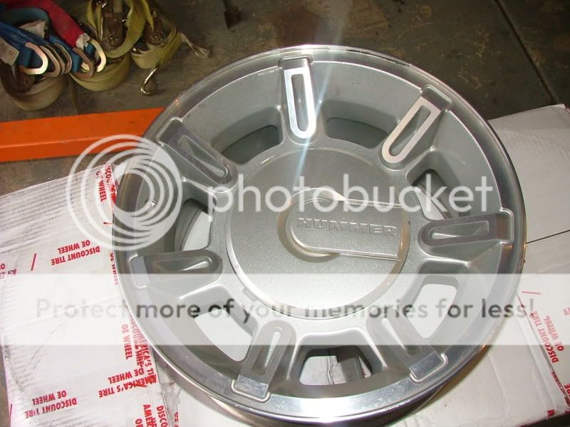

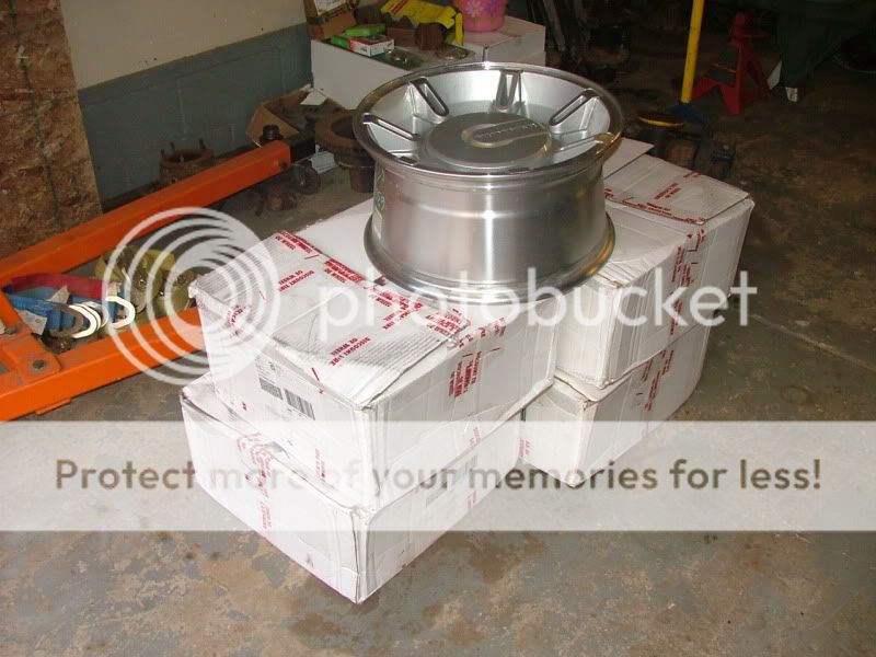

Got my wheels today.
Kyle M's Ranger Rebuild
Just gotta machine the centers to clear the 6D hubs and figure out what I am gonna do for protection. Some sort of rock ring, maybe thinking of getting some steel ones and screwing them to the rim. Guess we will see.
Gonna use inner air locks
