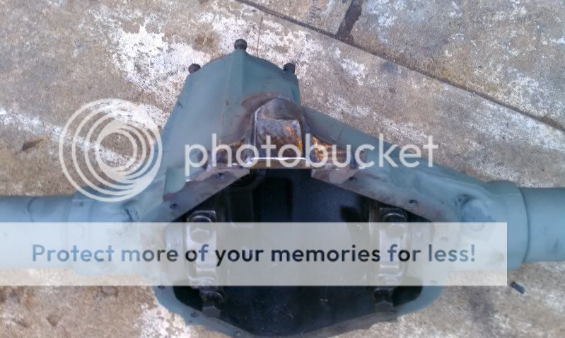

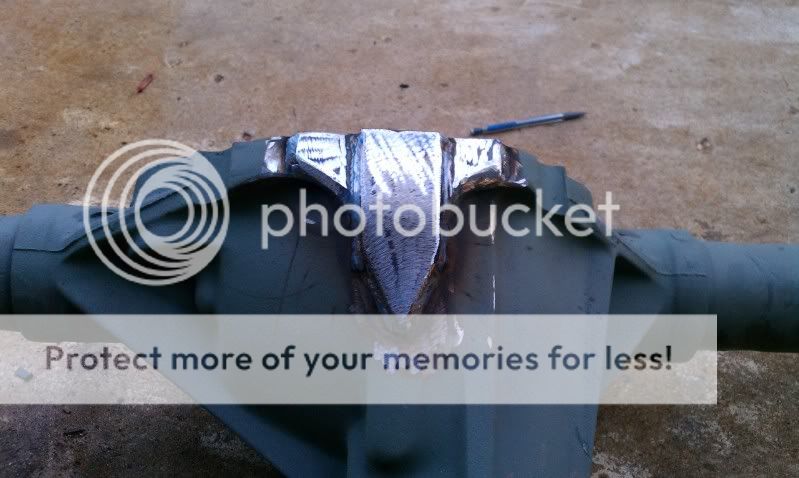

Then I skined the bottom of my 14 bolt to get it ready for gear install. I used 1/4" plate layered, so it is 1/2" thick.

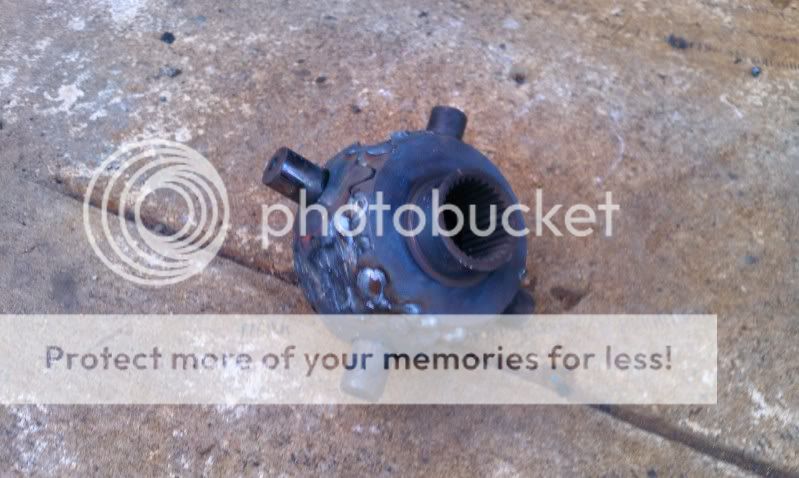

Then made my very own orb-o-traction
Still need to clean it up after it cools, prolly wait till the morning.
why weld a locker? i keep seeing this orb of traction
That isn't a welded locker, that is welded 14 bolt spider gears.
