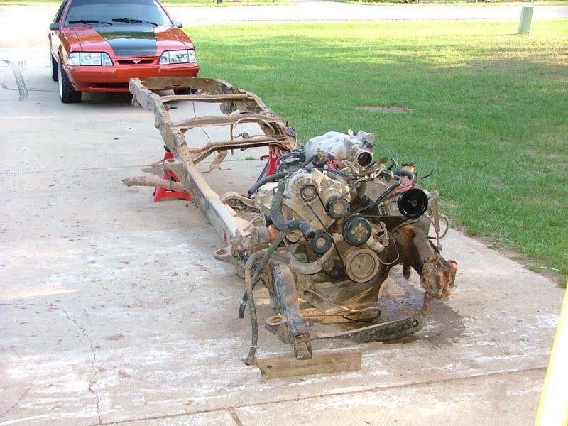

Got my X cab frame looking pretty lonely...
got a HUGE nasty mess going on....need to do some scrappin

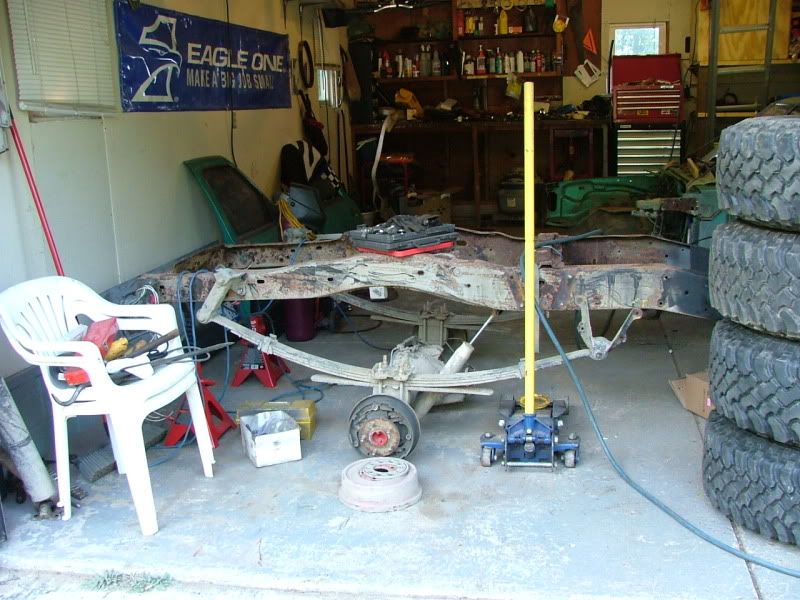

And slid the axle under the truck....
Gonna get the motor and rear axle in this weekend, then on to the radius arm crossmember. As far as ride height, I'm gonna put the rear axle on, then level the frame and call that a starting point. :headbang:
