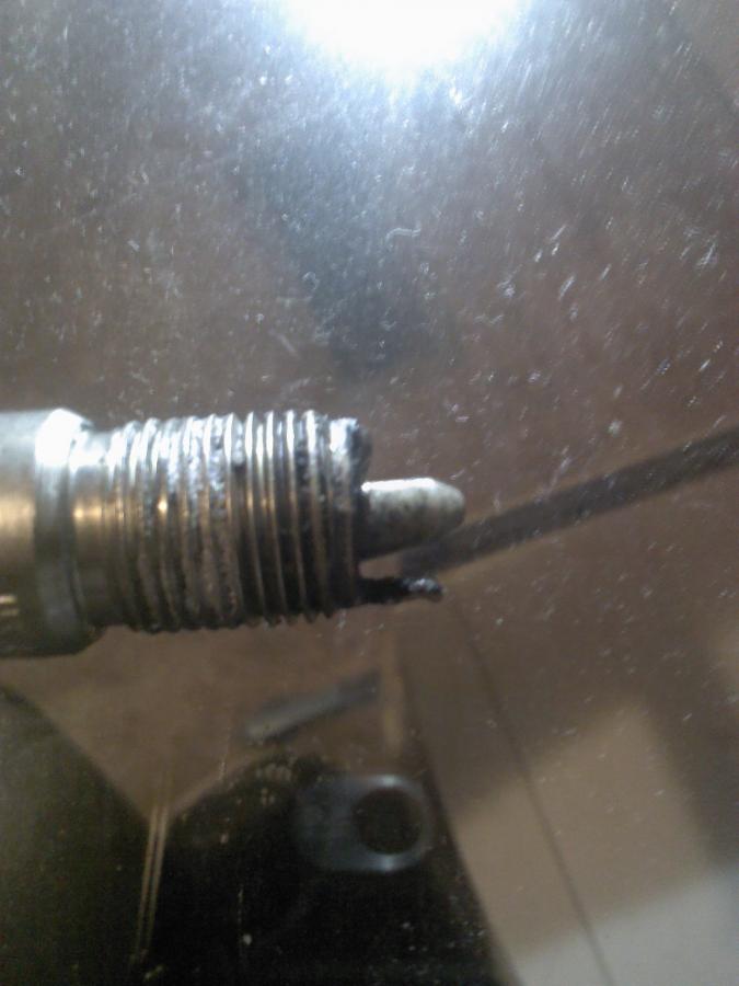

slight update, tried the vacuum trick, with no results. Then it occurred to same cylinder is on the other side of the engine. Figured I'd try the magnet over there. Pull the plug and this is what i found.... I've pretty much accepted I've got to pull the head.
  • Knocking
also, all parts of that plugs are smushed but accounted for.
A shot in the dark, but if you feel that you've retrieved all of the debris from each cylinder w/ the magnet, why not just put in new Motorcraft plugs and see what happens. You say that both the old and new plugs were the same length, but your engine obviously disagrees. I'd try the 6 new Motorcraft plugs first. Hopefully there's no scoring in the cylinders, valve damage or piston damage. Good luck.
What Kowboy said. You got nothing to lose. If it is broke, it is broke. It won't get "more broke". I have seen small washers dropped into cylinders. Sometimes they bang around in there until they are small enough to get past the exhaust valve. Sometimes not. I would say at this point don't pull the head. Just put the correct plugs in it and see where you are.
