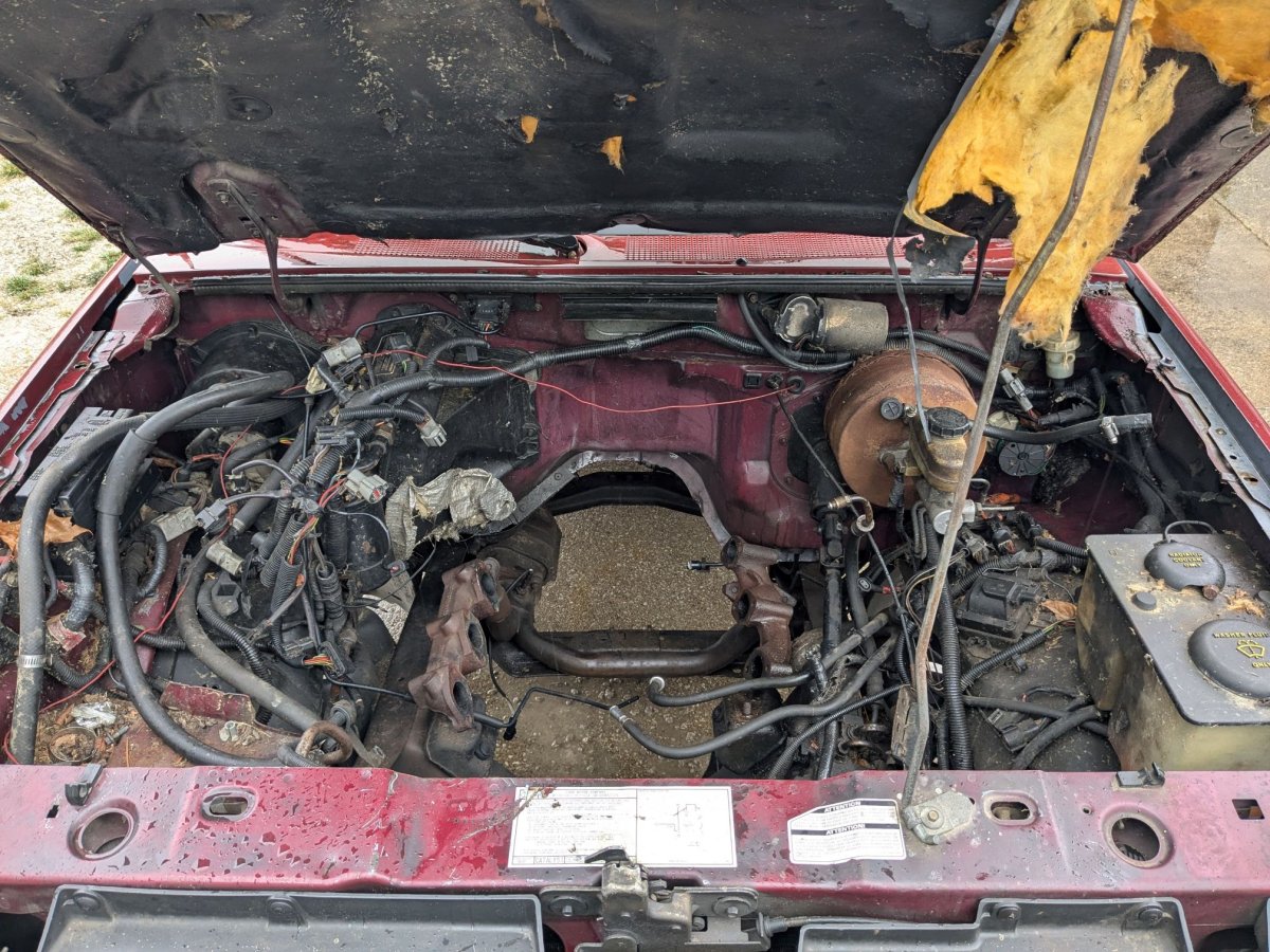

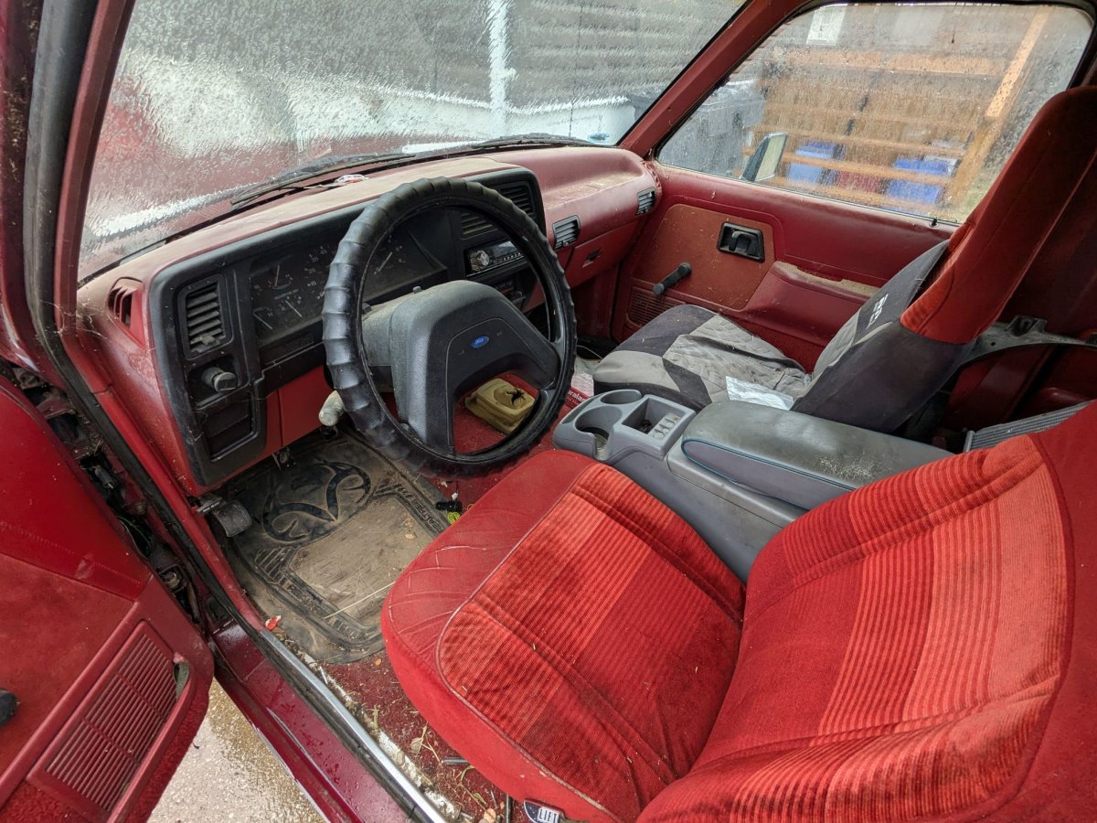

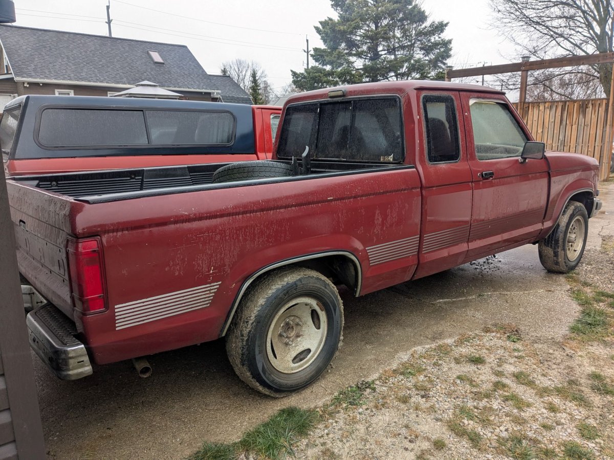

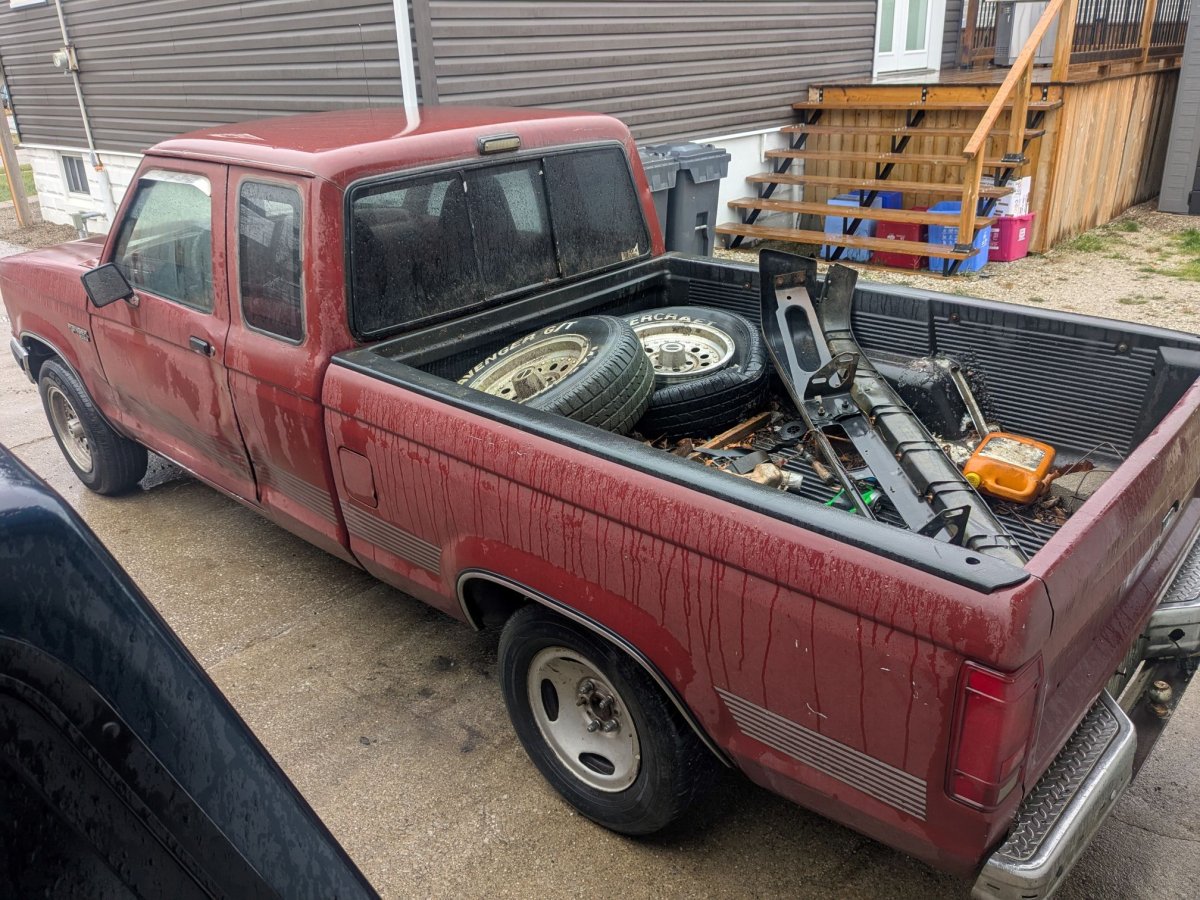

This is a 1989 Ranger XLT Super Cab with 87k miles. It was built with a 2.9L V6, a manual transmission, and is RWD. It has a 7.5" 3.45:1 open diff, same as my current 1985. It has come to me without an engine or transmission installed. Story is, this was a daily driver, but the rad let go and it overheated. A new rad was put in, but it became apparent that there was a cylinder head issue as a result of the overheat, so it was parked. A 2.9 auto 4x4 regular cab short box parts truck was purchased, but when they tore into it, they discovered it also had a cracked head(s), which resulted in both trucks just sitting for a while. They were listed for sale but had no bites, other than someone who wanted the disassembled 2.9 plus trans out of this truck, which is how it ended up with no powertrain. A substantial handful of parts from the parts truck came with this one - fenders, doors, front bumper, and front bumper filler panel.

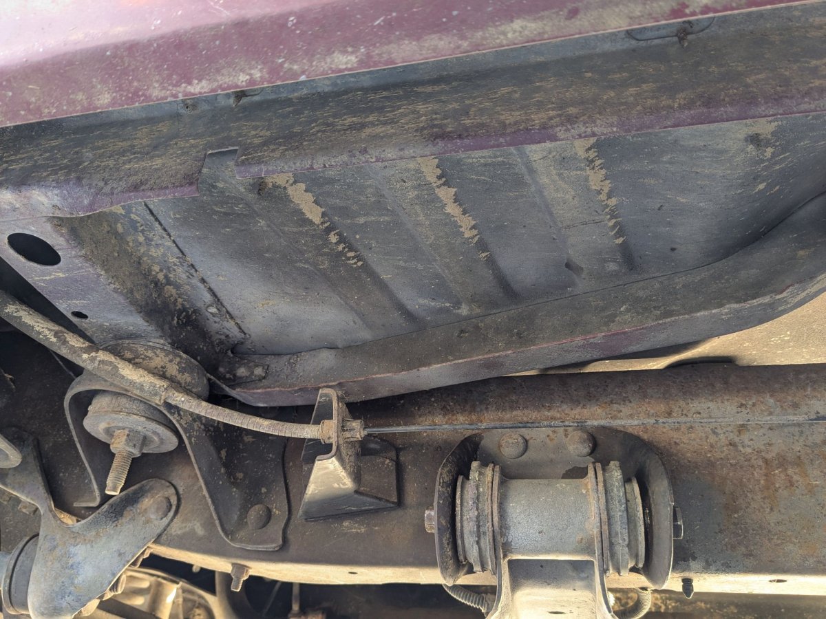

This truck spent its life in places where the roads aren't covered in a crusty layer of salt for a third of the year, so despite some cosmetic problems, it is astonishingly clean underneath - at least by my standards.

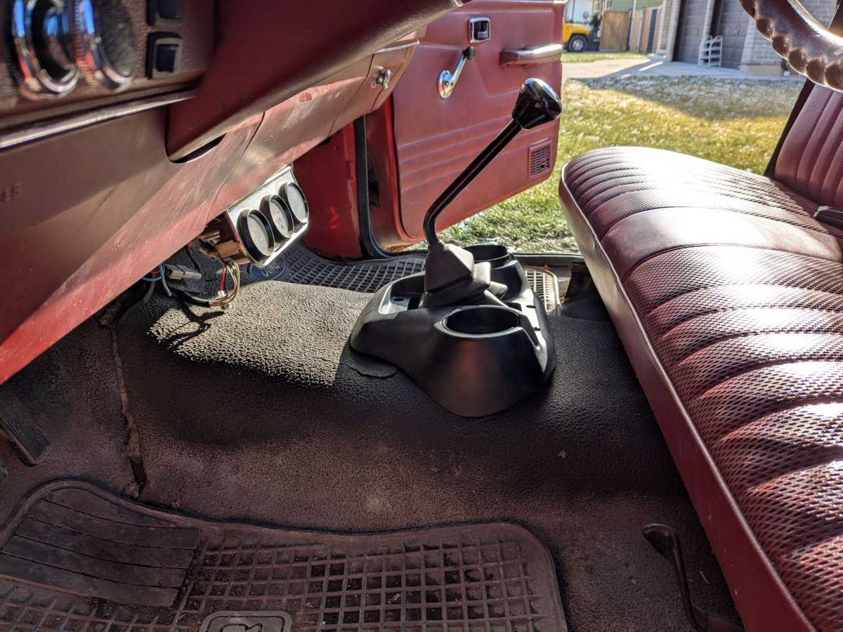

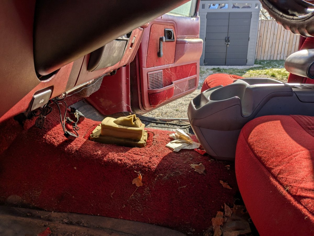

    • It appears the shifter hole in the floor for an M5OD-series trans and a TK-series trans are in different locations. My hope is that the metal panel around the shifter hole in the 1985 can just be swapped into the 1989 and the hole ends up in the right spot, but we'll see.

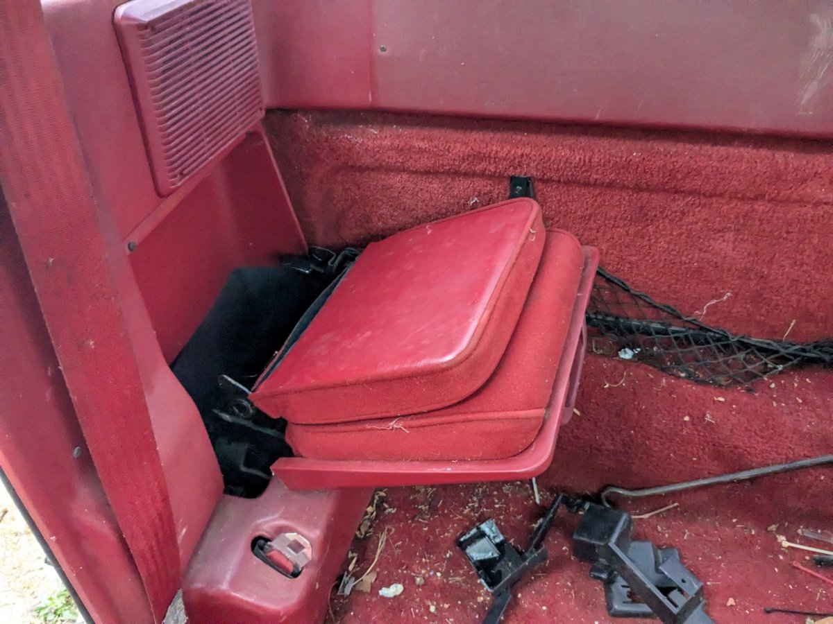

    • One of the jump seats is not operating correctly and can't be put in the stowed position, nor actually used as a seat, as a result. Need to take that apart and figure out what's gone wrong with it.
