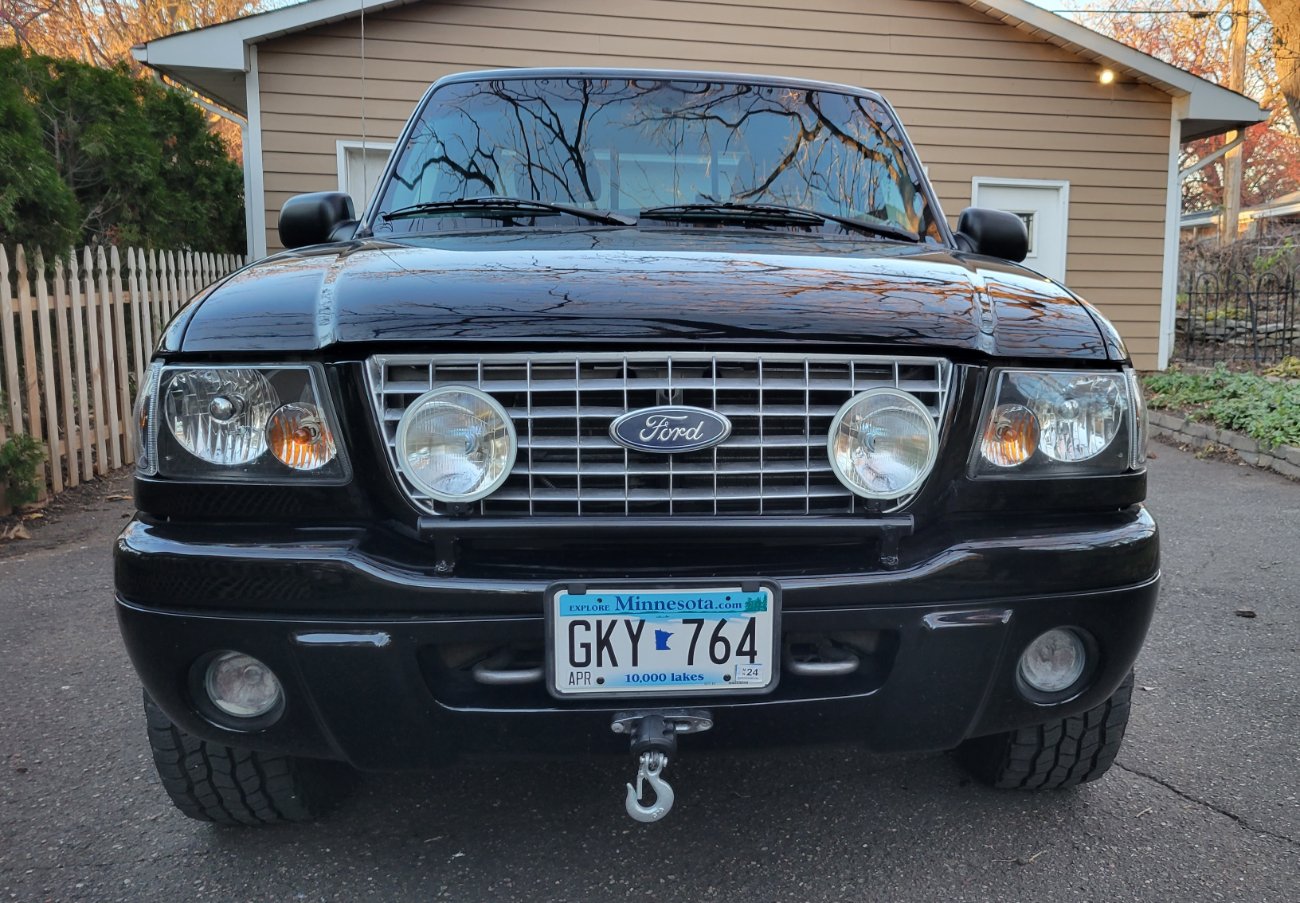

Very good point. I aimed mine according to specs on my garage door. Now all I need to do to check is just turn them on when I pull into the driveway. And if you're not sure exactly, just turn on your regular street legal truck low beams. The hot spots of the fog lights should be slightly lower. Those KC Hilites are no doubt very similar to mine. I dare say they will probably work as street legal if mounted inside of the headlights and at the same height or slightly lower. My set came with an electrical relay which come on and off with the high beams. I felt that was just too much so I just have a separate control, a push button mounted on the dash near the radio. I bought halogen. It was old school like my truck and on sale. Visibility is great. We drive through woodland roads in the darkest of night. We can see deer and wildlife easily. That's why we have them.

Yes. Looks familiar. I made a small light bar with some brackets. I've never really liked bull bars. They are expensive and break the naturally good lines of the Ranger grill.

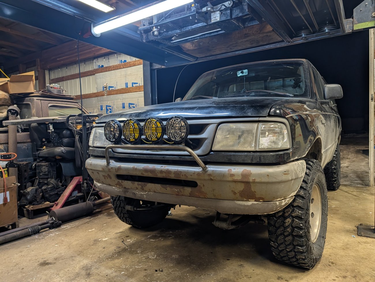

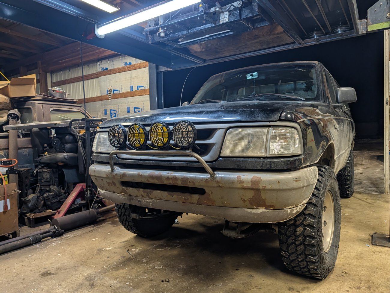

I didnt read anything...but the Daylighter lenses fit in the 6" Apollo housing if you want to swap from spot, driving, or fog pattern. The only cover that fit the Apollo are the soft covers...also you can put the 130W bulbs in them. I like that that they are a plastic housing for a winter beater. The metal ones rot out too quickly.
I have 130W in the outer spot beams and 100W in the driving beams that I wrapped yellow for snow and rain.
KC HiLiTES 6" Round Apollo Pro Driving Lights
Not if they have the 100 watt bulbs.
Or 130watt. Nice and bright though. Also 20 amp per pair. For run length and alternative uses I've run 8 gauge to mine.

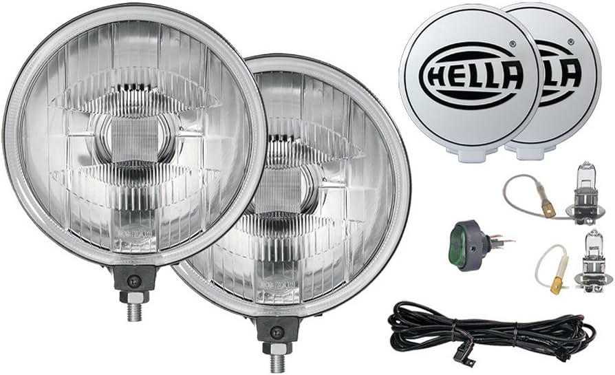

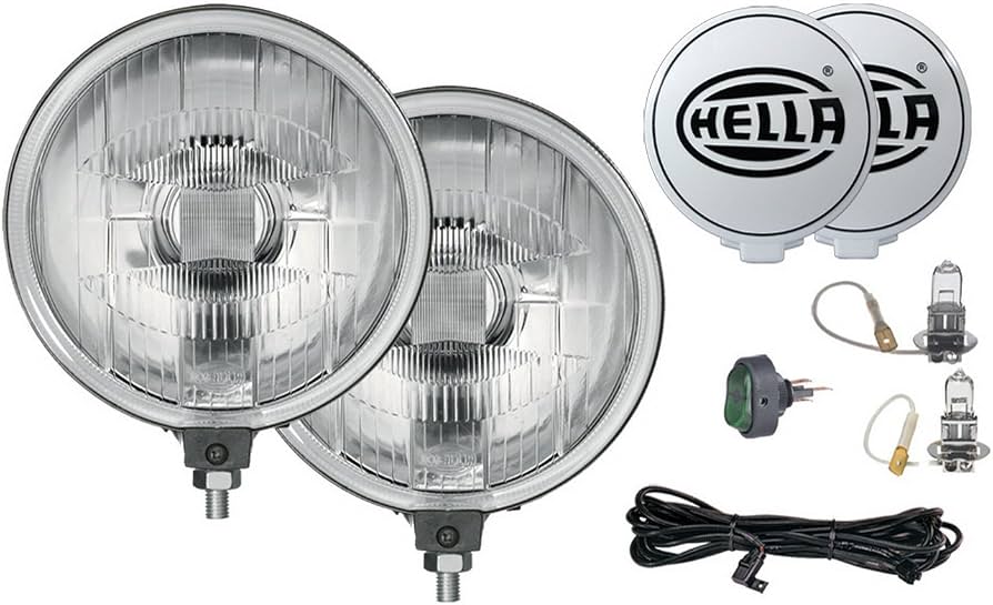

Those should be a good choice as well.
I have Hella 4000c lights on mine (wired on a relay w/hi-beams), they are quite impressive for having just a 55W bulb.
