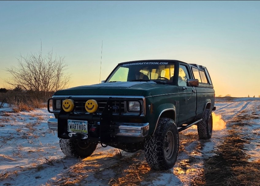

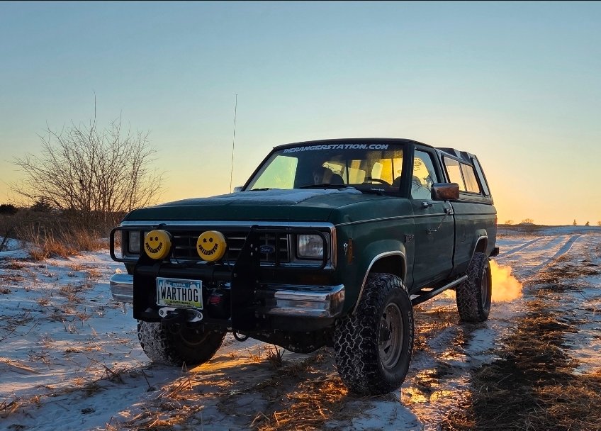

My daylighters are bright and can see a mile out. Not legal for road use. Especially not where I have them.
That doesn't mean I haven't turned them on with the high beams on occasion. I had a set of "baja" lights on the front at one time. Those worked well on the road. I'm not entirely sure if they were legal here or not...

Notice the KCs look below roof height? They are. 1/3 of the light goes into the cab. Yet another of the things I've gotta fix...
