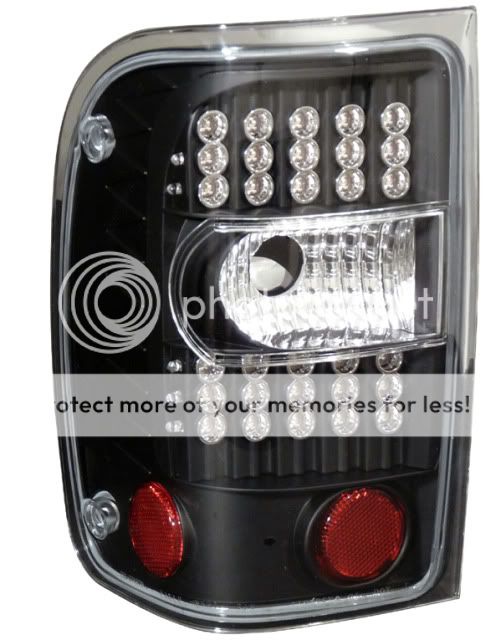

Ordered a set of eagle eyes? Led tail lights from eBay. Same ones you have.
Got tired of no one having lights for a ranger in stock, and to boot cost more the double what they do on eBay.

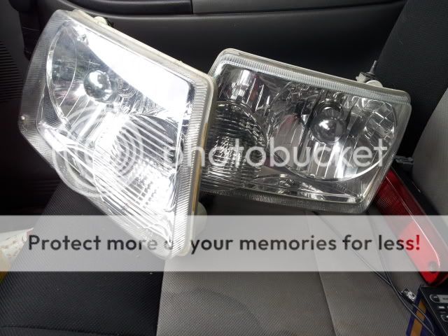

Friday is going to be paint my headlights black depending on weather.
i love my tails, (other people hate them, so bright!) also, the black heads will look sick on your truck... the trick to it is get them hot the first time so you can get them apart first try, if you have to heat them up several times, they get all cracked looking... if you take a close look at my passenger side headlight, it looks like cracked, tempered glass, i had to heat that one i think 4 times... the drivers side is crystal clear, it was only heated once
I'm going to take my dremel to them. If for some strange reason that still doesn't work you'll get a text that well contain an offer of beer haha.
a dremel? dude... that's not going to end well!
just bake them like you're supposed to, leave them in longer than you should... 2 butter knives and a flathead screwdriver is all you need... i used a beach towel so i didn't burn myself on the metal bitties... nothing was even close to melting when i did mine
corners are a different story, watch them carefully, if they start to turn white, pull them out... i think right as they change would be optimum, but i've not tried it at that point...
mine were both done pure white and melty they both were misshappen and one doesn't fit on the truck any more

Also got another set of headlights incase anything bad happens when taking them apart to paint black. Also got the 3rd brake light too.

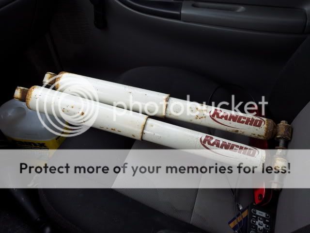

Finally got some rear Rancho shocks, they are suffering from some rust so I plan to repaint them.

I tried pulling apart a spare set of headlights and couldn't get them to come apart to save my life...ended up breaking one. I am just gonna have to break down and buy a set from ebay....
That's the only reason I picked the second set up. If we cant make these work iill just bite the bullet and get some off eBay.
Speaking of eBay my tails should be here Monday!
What tails did you get? Been thinking about getting some to match my light bar and third brake light.
Eagle eyes. I think with shipping to Canada they where about 170?
