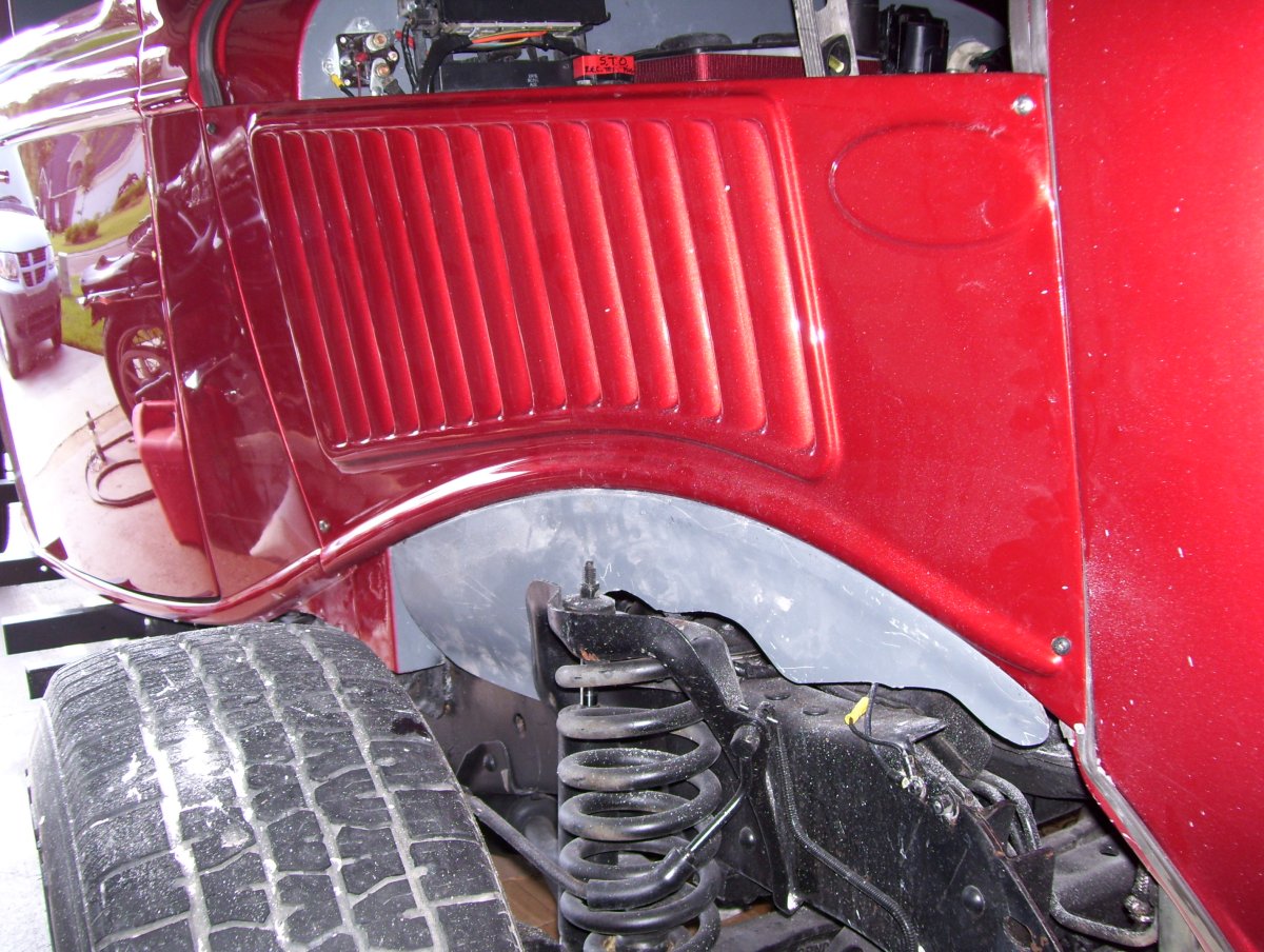

EDIT: :annoyed: Well, it's about time......4 days of piddlin with the front end pieces and finally got the seams/gaps straight!
the passenger side engine panel with the grey splash-shield attached to the bottom of it.....

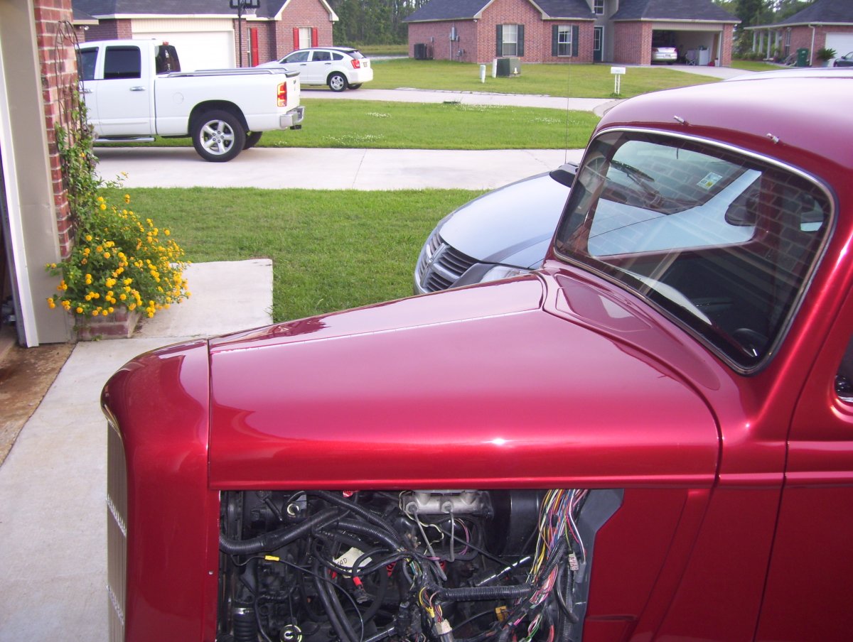

:icon_surprised: the hood actually closes all the way this time !!!

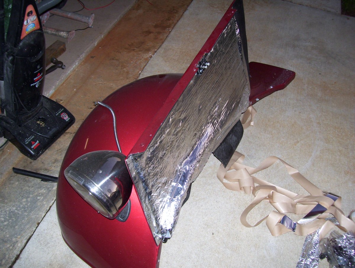

Back in the heat.....maybe I can attach the fender........hopefully this afternoon!
EDIT: Monday nite.........It's did.......it's dusty but bolted on......

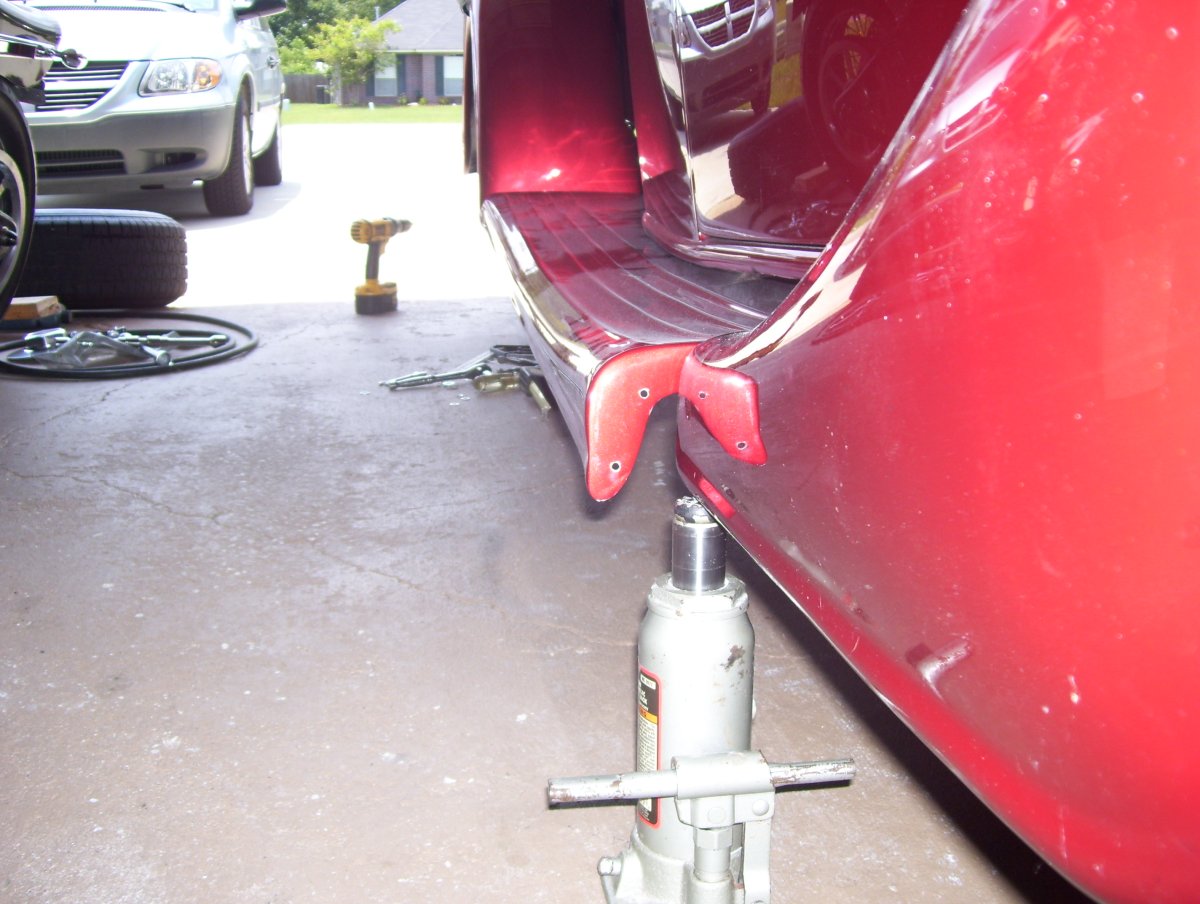

EDIT: Installed.......errr....ahhh..mocked up running board & rear fender....
Installing passenger runnin g board.......

Another small problem.......
Now to study the sit-tiation in some a/c for a while....I gotta move something??? 2 inches, OR move 2 things one inch, OR move 4 things 1/2" without moving anything else at all !!!!!!!

At least I can locate the rear fender in the correct position, drill holes & mount it to the bed will I'm burnin up some brain cells thinkin bout the alignment between the running board & front fender....
If there was only a smiley with gears turning in his head & smoke coming outta his ears..........
hmmmm...........cut 2 inches outta the inside of the runnin board?
Normally, that would work.....and the cut wouldn't be noticeable because the running board fits 2" under the side of the cab....
BUT, the running board & the fender won't butt together completely.....there would be a gap that would increase to about 1/2" where the two pieces bolt together.....it's an old truck/running board phenomenon (wow-big word)....
I quit at 9:30 tonite after shifting the left-rear of the cab 1/2" toward the chassis, & shifting the right-front corner forward & left 1/2"....
Weird, but it worked.....old truks---go figure....Somehow...1/2" left & 1/2" forward&left 1/2" X's 7' diagonally equals 2" of adjustment at the front of the running board (ought plus ought is ought////ought x's ought equals double ought)!!!!!!!!
