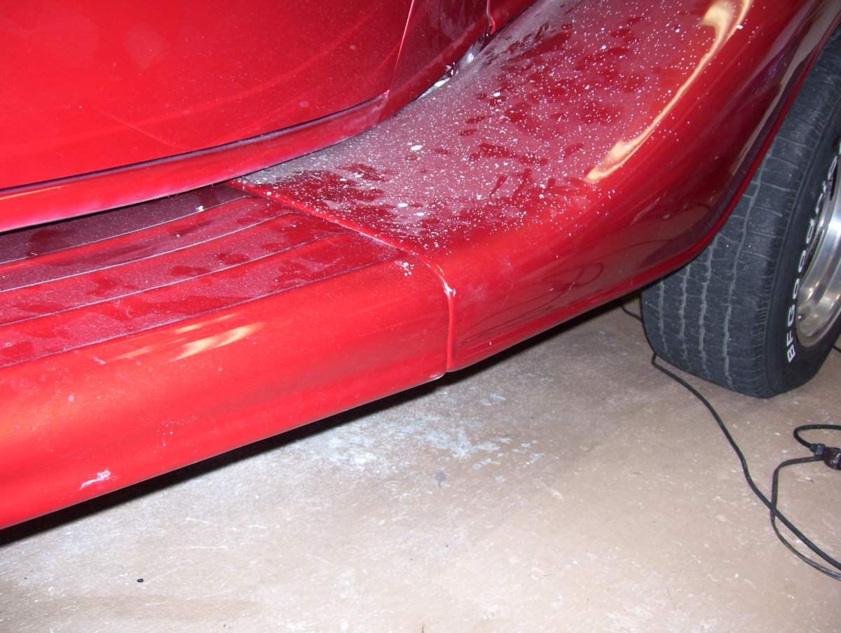

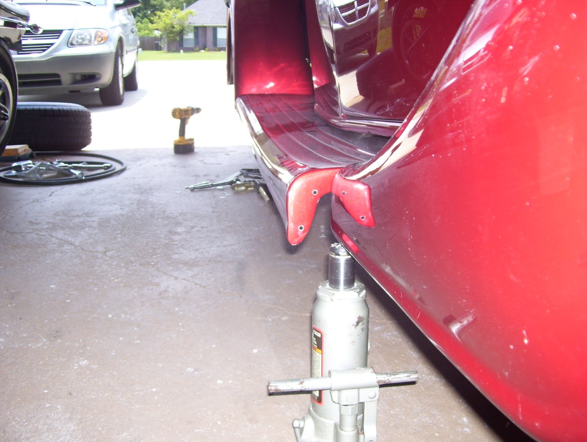

Update: fender (mis-) alignment.....
B 4
Just Plain  Stupied
Just Plain  Stupied
AFTA.......( 4 hrs. later )
Just Plain  Stupied
Just Plain  Stupied
Yeah...looks like your fender was off a titch...or two.
Good to see you got it straightended out!

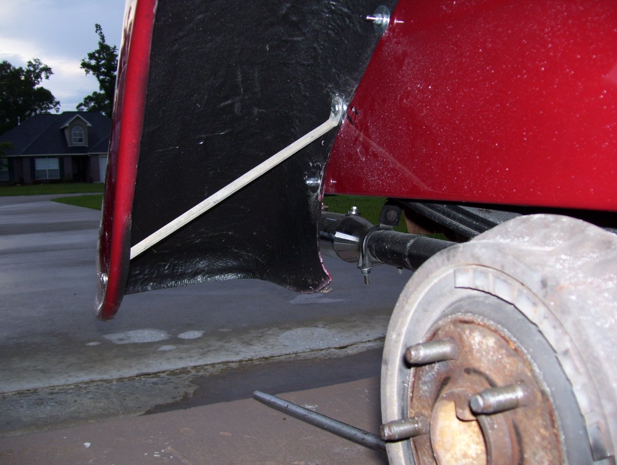

Anybody recognize the rear fender brace ????????:icon_confused:

Hint: It came off a certain 1989 Ranger XLT & fits perfectly on the 1936 Ranger XLT !!!!!!!!!!!!!!!!!!!!!!!!!!!!:icon_surprised:
Imagine the chances of FoMoCo doing that twice in 73...yep....73 years !!!!!
The '89 front fender braces fit just as good on the '36 front fenders too!!

how did you fix the running board?
Just Plain  Stupied
you'll halfta trow some black on that so it dosn't stand out so much, good thinking most people just would have fab up something new.
73 years? almost as old as its builder looks!
.....it's an old truck/running board phenomenon.... shifting the left-rear of the cab 1/2" toward the chassis, & shifting the right-front corner forward & left 1/2"....
Weird, but it worked.....old truks---go figure....Somehow...1/2" left & 1/2" forward&left 1/2" X's 7' diagonally equals 2" of adjustment at the front of the running board (ought plus ought is ought////ought x's ought equals double ought)!!!!!!!!
:icon_bounceblue:
Now I gotta go roll it out in the sun for a few hours....let it simmer in that 100* heat so everything will flex ....then slide the cab back over the body mounts reversing the above formula.....hopefully!
QUOTE=Ranger;109876543210you'll have to trow some black on that so it doesnt stand out so much....
I thought about that, but I left the 20 yr. old dirt on it so it wood show up better
