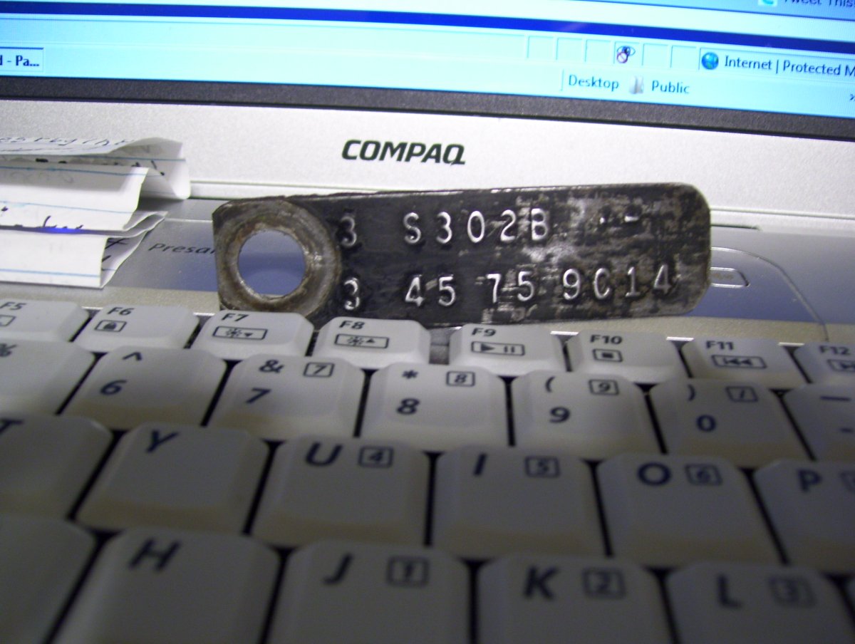

Let me go find the axle-tag....be back in 5......
I found it! It was on the axle......
according to my Tech Library lesson.....It's a 3.45(I musta measured wrong when I spinned the driveshaft to count the revolutions/ratio to the rear wheels)! 7.5" '89 March de 14th........Somthin/Somthin......I don't remember the drum-to-drum distance...will measure tomorrer....
Just look for a 90-93 with a 4.0, it should have a 3.08 and will be the same width as your 89.
