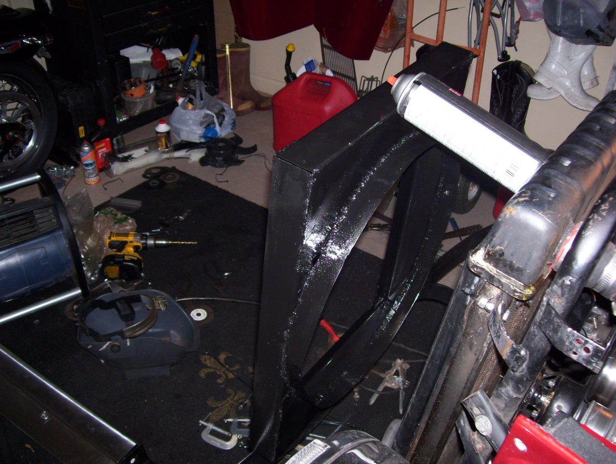

top & bottom sheetmetal is bent for radiator shroud.....(because eee-lectric fan won't fit with long-nosed water pump in the way)...
the back-porch brake is assembled & the upper/lower shroud ends are cut to size/bent......
fabbed pieces are clamped to radiator.....upper piece first.....
Just Plain  Stupied
Just Plain  Stupied
Final bends are made to side pieces......it's now a frame....
the sheetmetal is cut to width & length.....now it needs to be laid on a 18.5" diameter cardboard cut-out & welded into a circle.....that's the strip(s) laying next to the 36" metal yardstick......

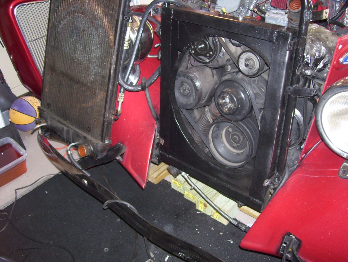

The ring is made and welded to the shroud frame...upper & lower sheetmetal is added to fill in the gaps above & below the ring....
Just Plain  Stupied
Front view......and yes...the 5 coats of gloss black are not for rust prevention...they are applied to hide the welds....RHS !!!!!!!!!!!
Just Plain  Stupied
I'll let it dry overnight....then pull the 4 mounting bolts outta the radiator/frame and install the fan shroud...the the grill & hood goes back on!
(The truck never overheated all winter, but 95* temps daily with the new A/C kep the temp at 195*....I prefer 180* or less during the summer....that way if the temp. spikes.....195* on a really hot day still won't overload the cooling system)
Man.....that's a big air hole....the fan didn't look half that size....the radiator/shroud brackets had to be modified to fit around the fan shroud...bad pic.....
Tomorrow.....hoses get connected....coolant.....transmission cooler connected.....95* test drive!!!!!!!!!!!!!!!!!!!!
