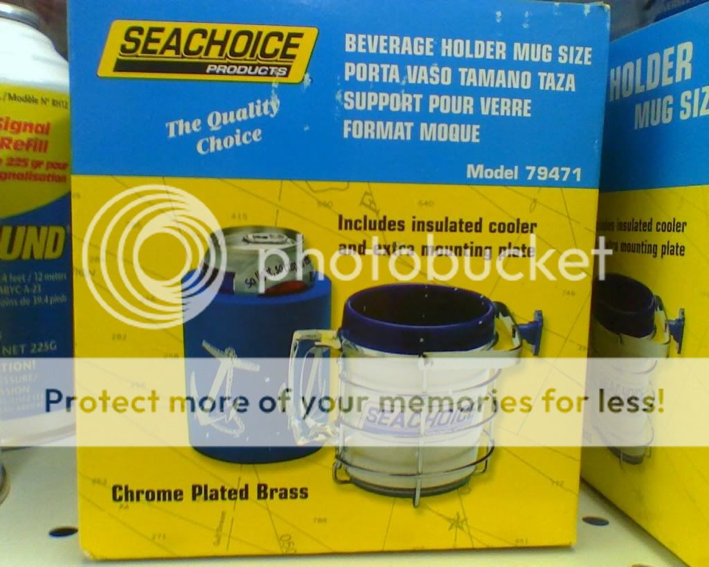

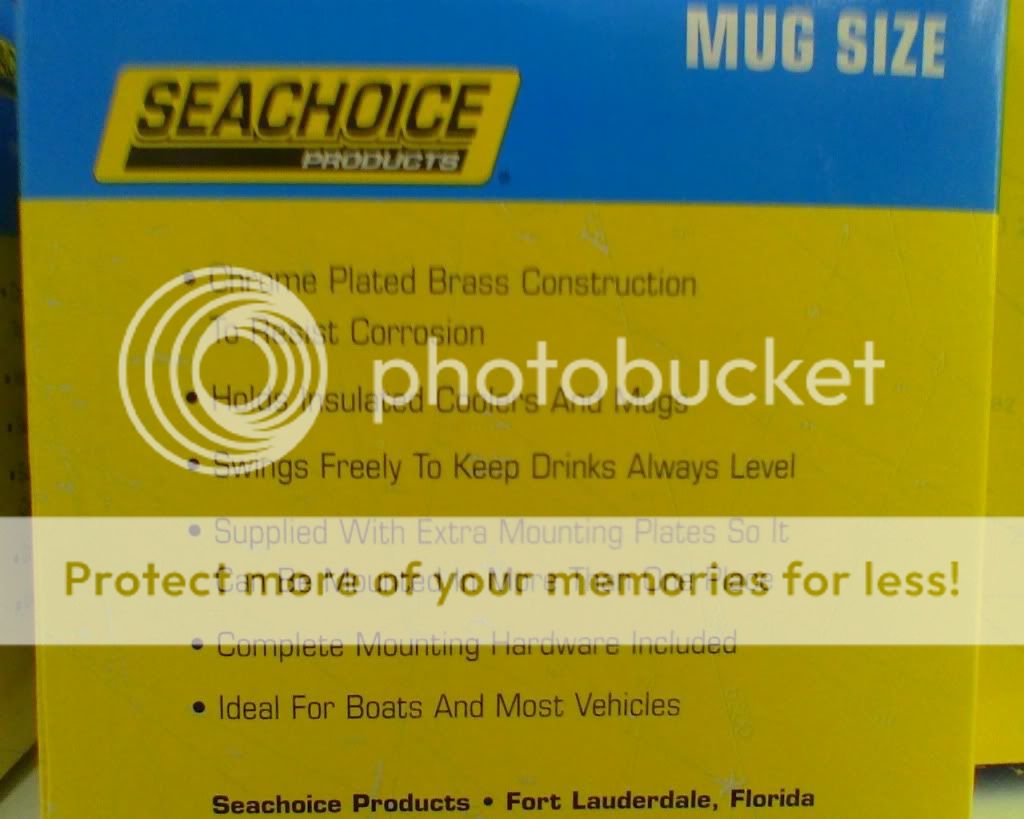

Dont forget the cup holders! say that boat have them? if not i might have an idea for you:icon_idea:

interesting cupholdrs....

DG if you like i could pick up a set of them cupholders if you cant find them down in teh big easy

Ima go to a boat dealership to get the swiveling cupholders....in case I decide to climb a few levees (you know...to get to higher ground)
