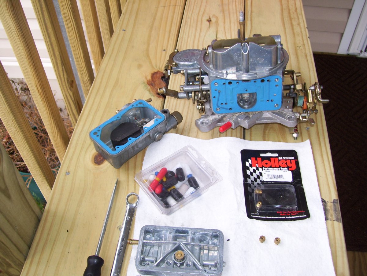

re-jetting the 4-barrel....
What size jets did you end up going with?
It had #64 original main jets........I replaced them with #60 jets & got 4mpg better on the highway & I can still burn rubber when I feel like it........
I'm gonna try smaller jets until the engine stumbles on accelleration....then I'll increase the jets size by 2 sizes.....I'm lookin for good gas mileage on long trips....I'll check the gas mileage soon & let you know what it is...(350 cu. in. bored .030 oversize...flat-top pistons....medium-rise intake....holley 600 4-barrel.....700R4 with 3rd & 4th gear overdrive....OEM 3:21 rear end....225-70R-15 B.F.'s on rear end)
