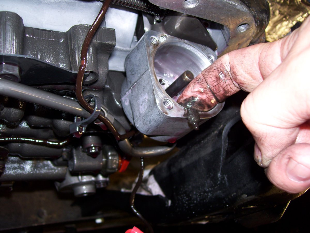

EDIT: I replaced the xmsn governor & speedo-drive gears......speedometer works again....it shifts really good 1st thru third, but still won't go into 4th until 65mph........the pressure in Reverse/First/2nd is up to 150 psi with the new governor......but only 55 psi in 3rd & 4th.......time to look at the troubleshooting manual again......in the A.M......
Just Plain  Stupied
Just Plain  Stupied

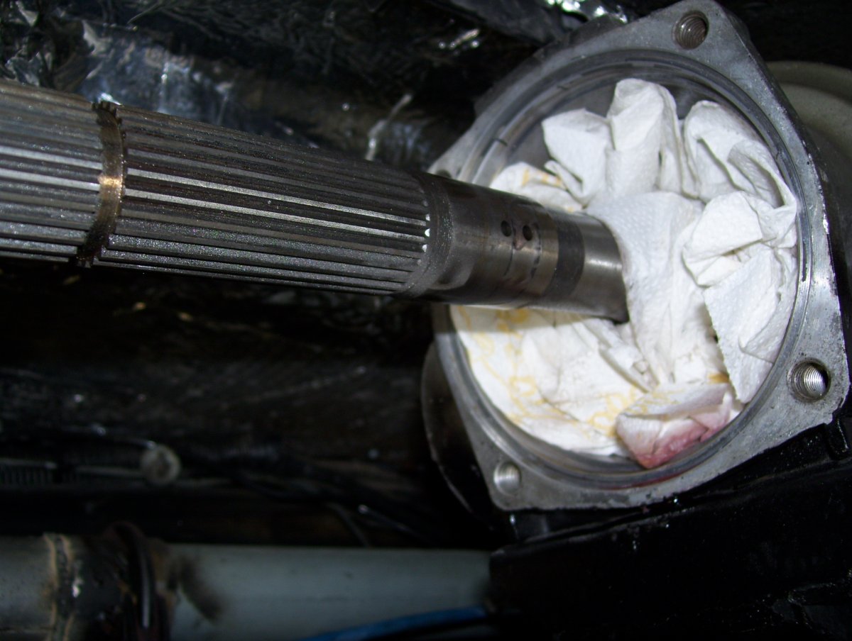

I'm cutting the steel gear off that worked with the OEM GM computer/speedo
Just Plain  Stupied
Just Plain  Stupied
steel gear removed.....now the output shaft is ready for the new mechanical worm-gears.......

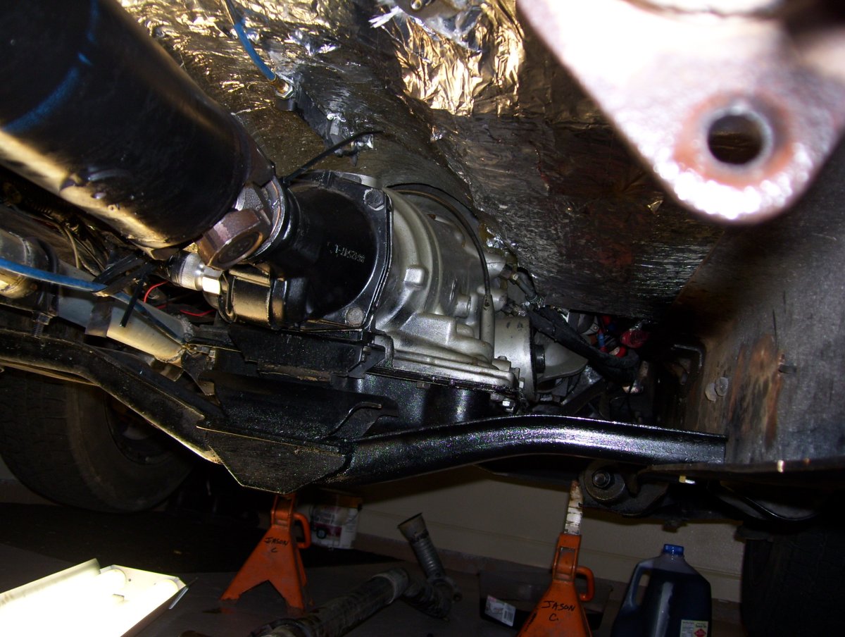

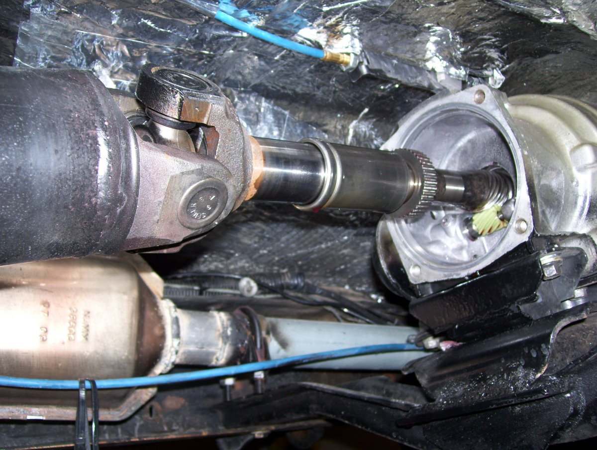

Guess What?????????????
Some dummy forgot to take a pic of the new speedo-gears installed before he put the xmsn back together!!!!!!!!

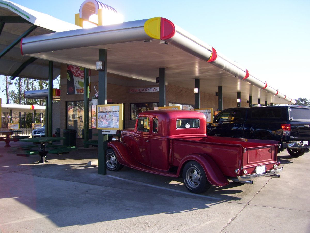

Dining out at it's finest!!!!!!!!!!!
Just Plain  Stupied
Just Plain  Stupied
doesnt get any better than that!!
:woot: shame that fugly tundra is messing your picture
beware of those... they have evil accelerators...
Funny, I stopped by Sonic for lunch today and thought about posting about it while I was waiting for my food, then I come home to find a picture of the '36 at sonic.
