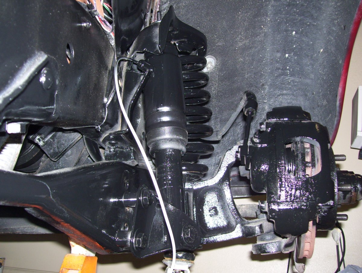

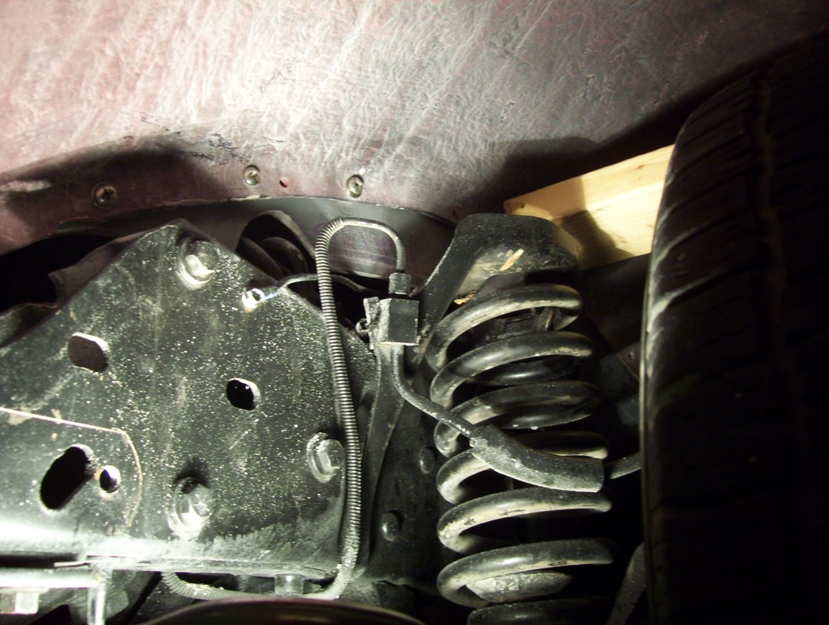

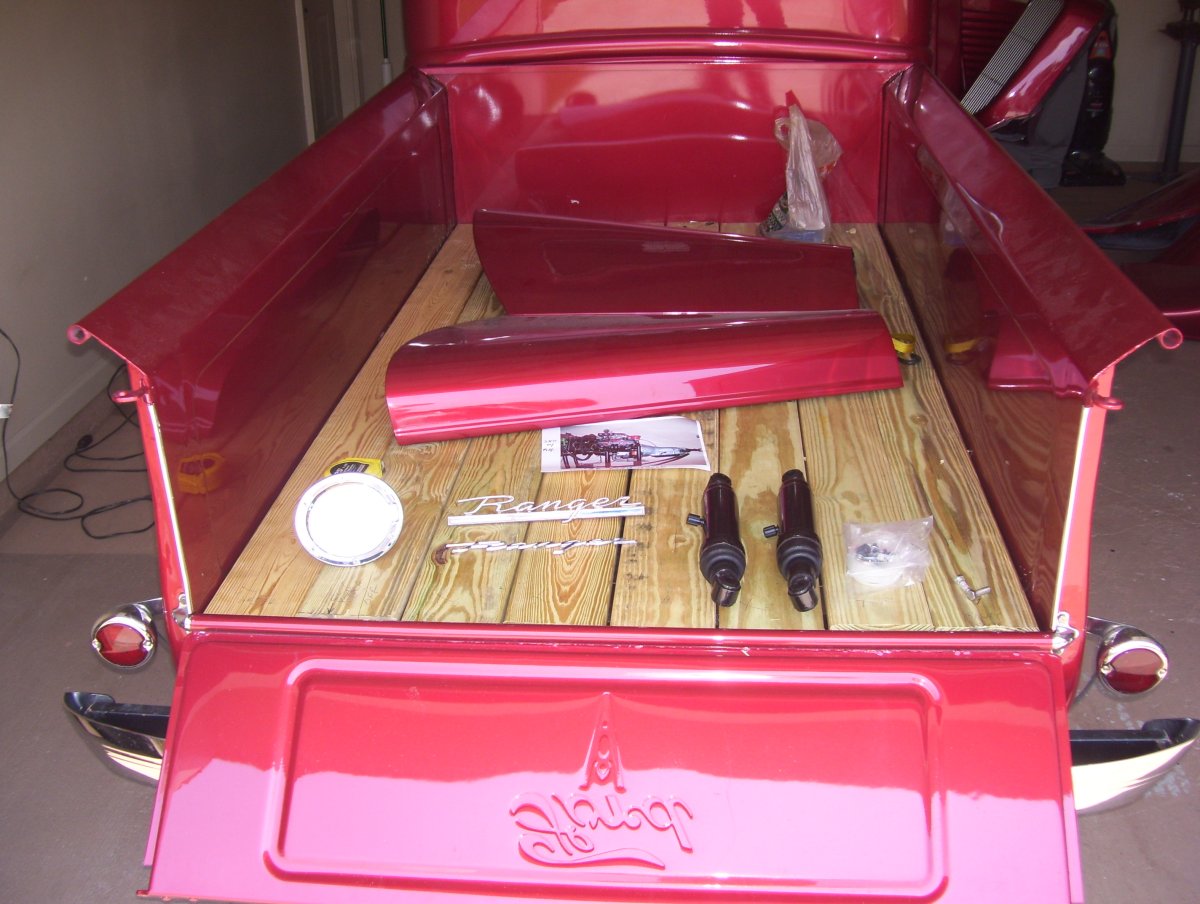

Converting front shocks to air shocks.......................................
One might ask one's self...."Whhhhhhhhhhy is he doing that!?"
It's the V.A.drugs.....

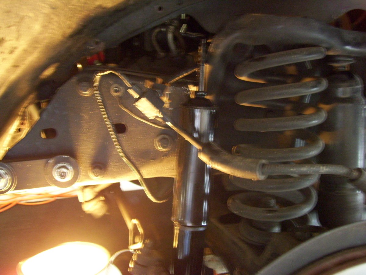

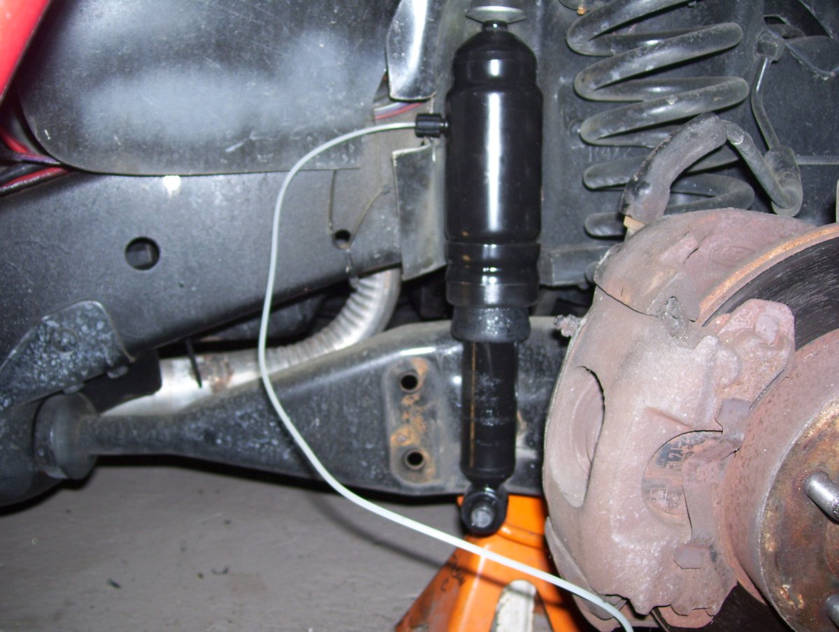

I removed the lower shock mount bracket......set the shock length for normal ride height......positioned/tilted the bracket so the lower bracket hole would not hang below the brace.....drilled holes and installed spacers to kick the rubber boot on the shock away fron the suspension braces.....bolted everything together.....and getting ready to put the wheel on/air uo the shock....
be back in a hour or 2....Waaaaaaaaaaaaaaaaaaaaaaaaaahahahahahahaa
that thing outta ride like its on air :icon_twisted:

I took the truk on a test run with the new air shocks.......at 70 mph it feels like its about a foot above the pavement....smoooooooooooooooooooooooth !
