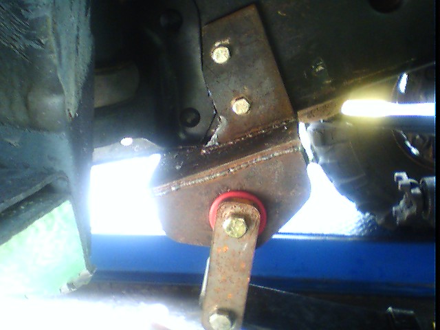

Here is some pics, Before during and almost the after. All I have left is brake lines, steering, shocks, drive shafts and some small stuff
The truck has a total of 16 inches of lift with the 3 inch body lift.
Dana 60 in the rear, Dana 44 HD in the front in a few months it will have a divorced case also
My buddy Alan welding
