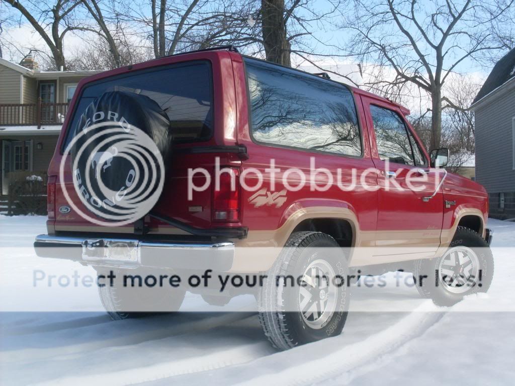

The quality of your work looks excellent.
I keep seeing trucks online that have those visors installed over the windshield. I never see any trucks on the road here in Colorado that have those. What purpose do they serve? Keep the sun out of your eyes? One thing I love about my BII is the big, big windows, great for checking out scenery on road trips. I feel like those visor things would encroach on that a bit. Not a criticism, the truck looks great.

Thanks man! On the visors, I wish I could give you some profound reason for having one but really I just think they look cool. Ever since I went to Silver Lake Sand Dunes and saw them on those 1970's lifted trucks I've wanted one. On a side note though my visors are broken (the PO put snaps on the ends so they're always up) so this visor should help some with the sun.

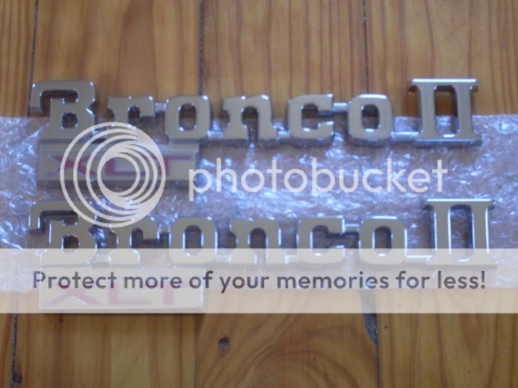

I also have the Bronco Horse emblems, are those standard on all models? I'm missing a Bronco II emblem on the passenger side so I need to find one to replace it. The Bronco Horse emblems have me scratching my head though because I don't see them in any pictures of others' bronco 2's on here though.

I think the horse emblems were standard in the early years but have never seen them on one newer than '86.
Is this what you need? Just send me a PM with your address and they're yours.:icon_thumby:

I have the pain non-chrome emblem on the driver's side but PM sent.

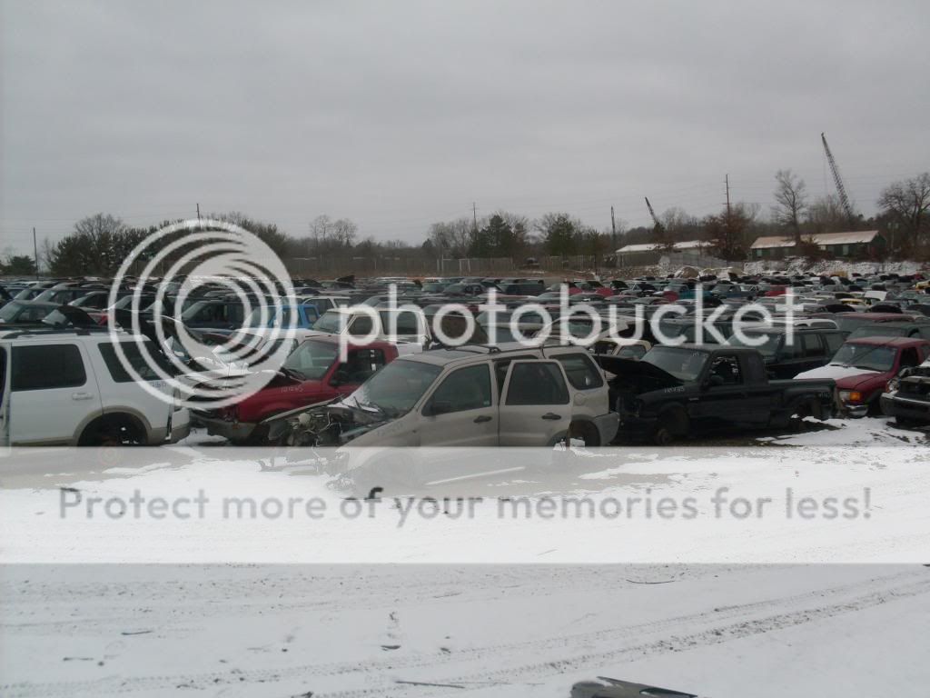

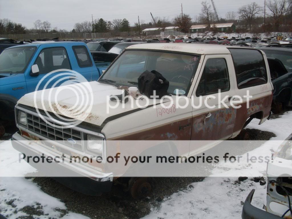

Just got back from the junkyard. They only had 1 Bronco II in the whole place. Not sure what happened to the other 2 they had but luckily this one had everything I needed. Radio wiring harness, OEM jack and jack cover. I was also able to find some parts for the wife's Taurus.
Josh's Bronco II Body Restoration Thread
Plenty of Rangers though.

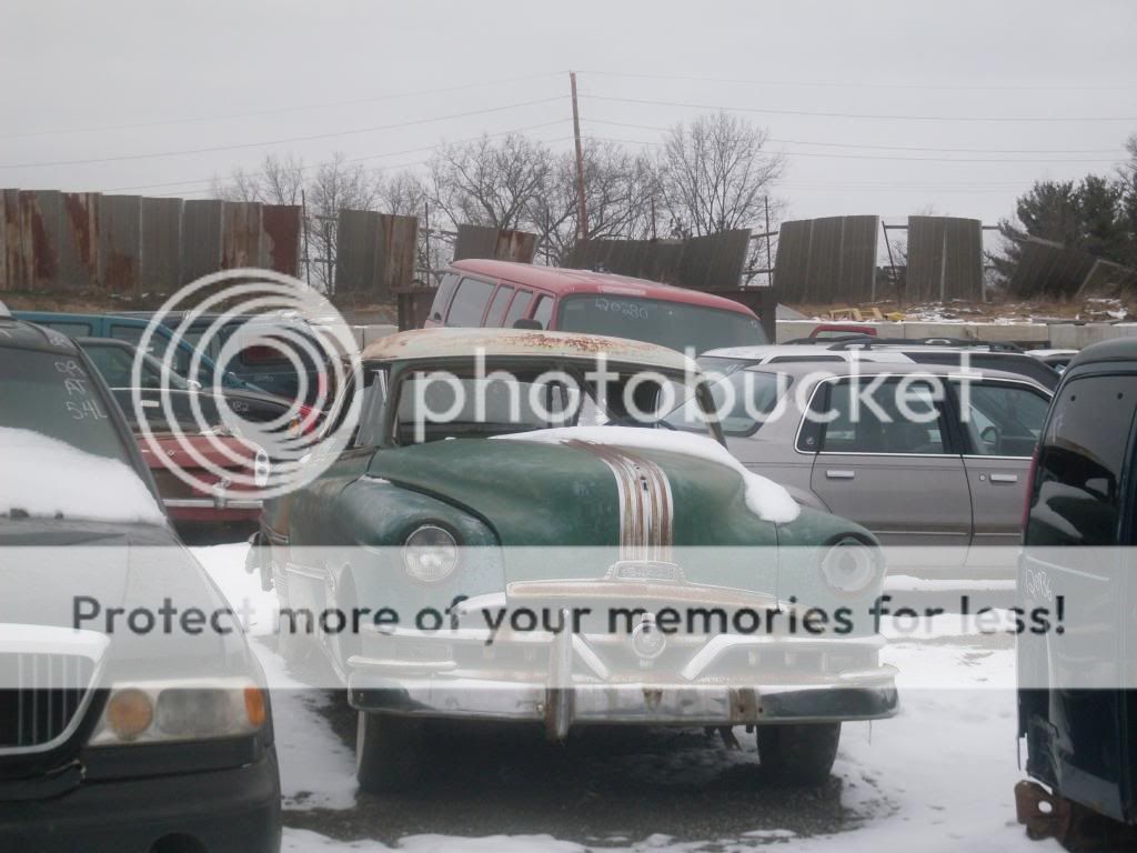

An old Pontiac, maybe the oldest car in the place.

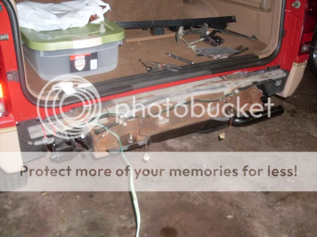

The trailer wiring has been soldered, shrink-wrapped and all buttoned up.

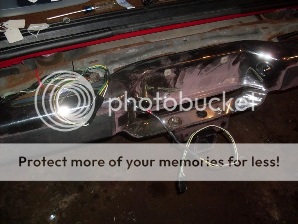

Here's with the bumper installed. The connector seen over the bumper will make taking it off much easier than last time in case I need to in the future. That goes to the (what I think is stock) round connector mounted in the bumper itself then a plug-in adapter for my trailer connector.

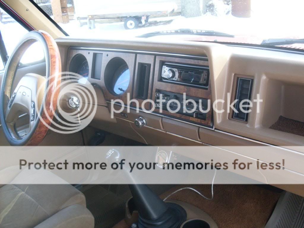

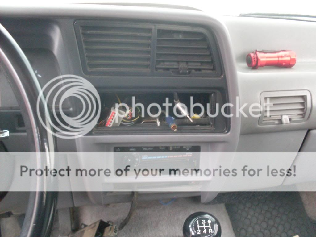

I pulled the Pioneer deck out of the Ranger to be put in the Bronco. Somehow "This is for your own good" just didn't seem fitting and I felt a little sad stripping parts from the truck that's been so dependable for me over the past 11 years. It will get its original AM/FM radio back.

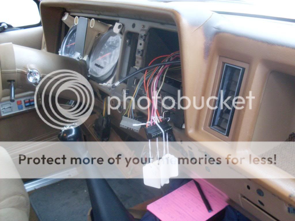

The stock radio connectors from the junkyard are in the Bronco ready for everything to be put back together. I wish I would have known that Ford used different colored wires for Premium vs regular sound systems. I must have grabbed the wrong one at the junkyard because nothing matched up and it took about an hour with the wiring diagrams and ohm meter to get it all sorted out.

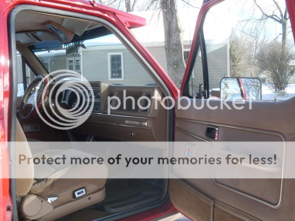

All finished!!!
I want to extend a big THANK YOU to everyone who posted for all of your constructive advice (both good & bad) and encouragement. Without TRS there's no way this project would have been possible. :icon_thumby:
