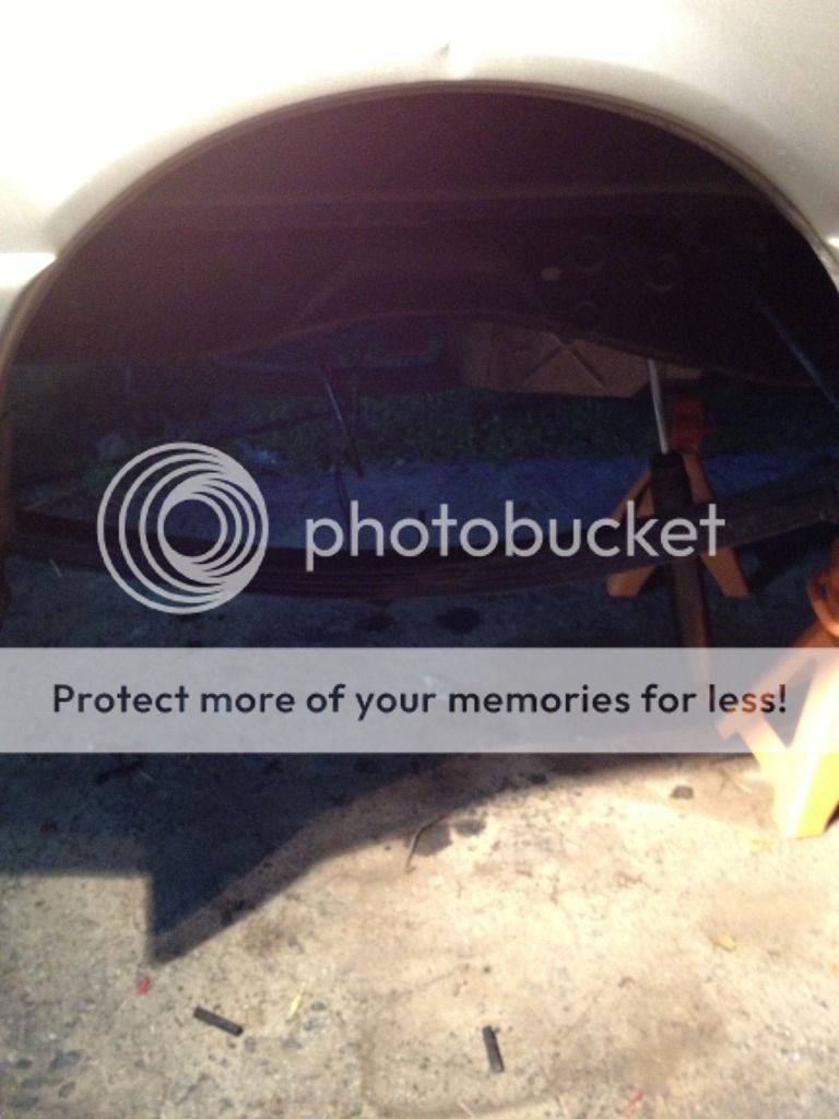

sat the header panel and mockup lights on just so it looks more like a truck. Brought the plasma to the house. Super Duty rear hopefully be installed this weekend. Once I get the little stuff on the rear done, I'll spin her around, and address all the glorious issues on the front end
Cleaned it up
Out with the old....
Mocking up the new
Pinion angle set, and now chasing down the no start. We got it to fire, but no power getting to the fuel pump. Getting close... Should have it running tomorrow. I'll post up once I do
Sitting on her own weight.
Tore it back apart to paint everything. Let it cure over night, final install this afternoon.
As for the running, spoke with Rick last night, and worked until dark chasing wires. Found a bad relay, got the truck to fire again, but then nothing. Fuel still not making it up to the fuel rail. Gonna try and find where I am losing the power again tonight. Really trying to fire this thing up before Thursday when I go back to class.
