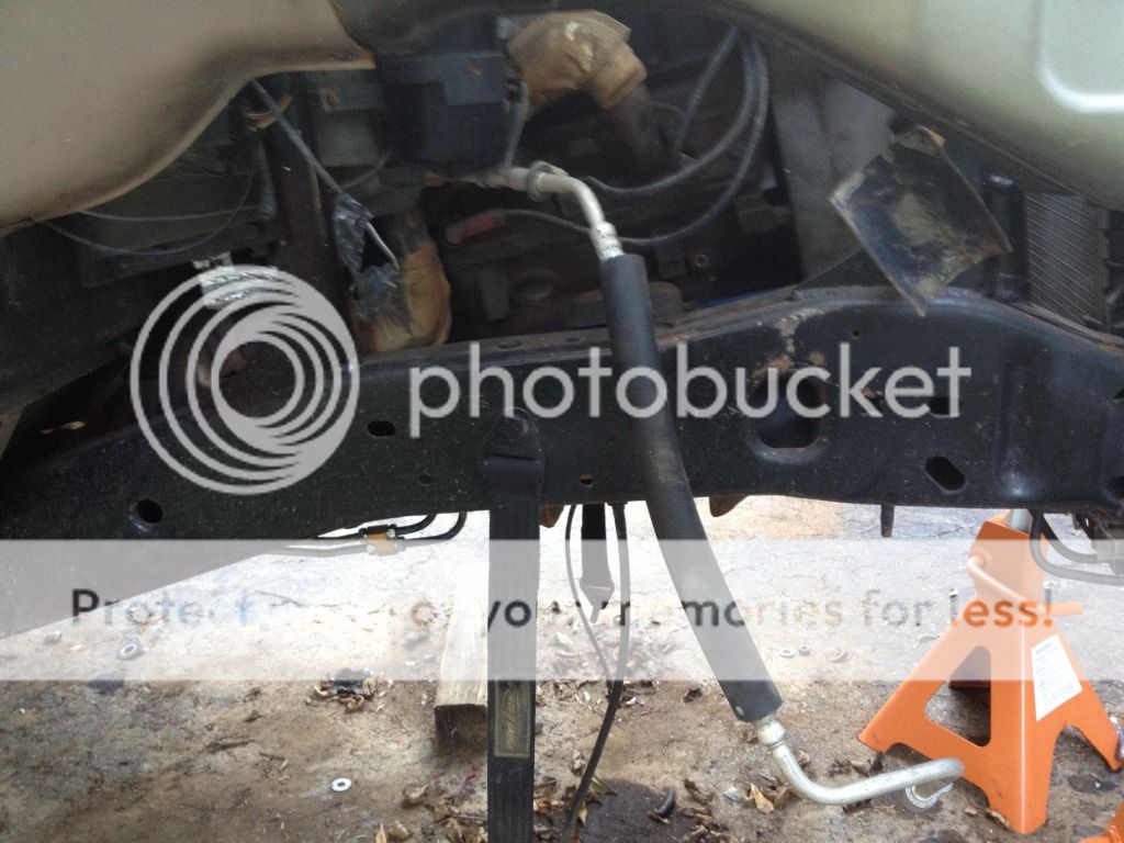

So then I disconnected everything I was afraid of cooking with the torch
Then I went to cutting...
