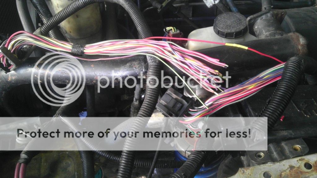

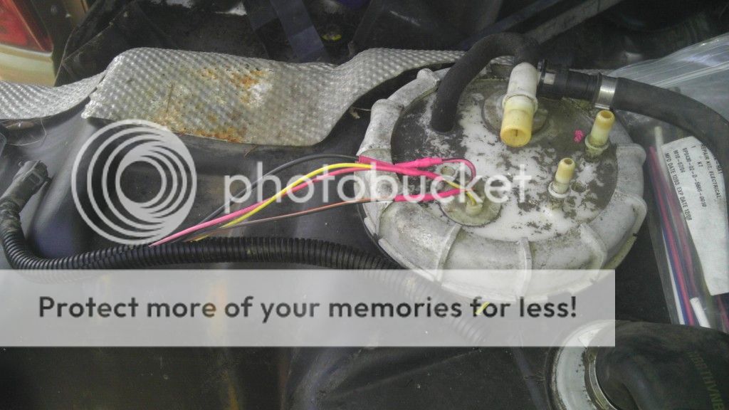

It's Crunch time. D is getting picked up Sunday... Today's morning was spent going to the boneyard again for tranny lines, fuel rail flex lines, and a 42 pin plug with about 12" of wire for the extension. Got back around noon and got to work. I did some research and thinking and came up with a way to use the stock 01 fuel tank, which means less fabwork. So I reattached the wiring harness...

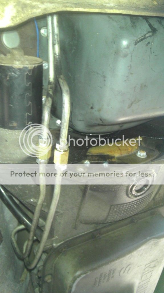

I also got the tranny lines in. This was a pain as I had to bend used line and flare them. I made a disconnect near the starter so in the event the trans needed removal it would be easier to get to the lines. If I had to do it again, I'd get new lines from AutoZone rather than straightening and rebending used line, but the budget is being stretched...

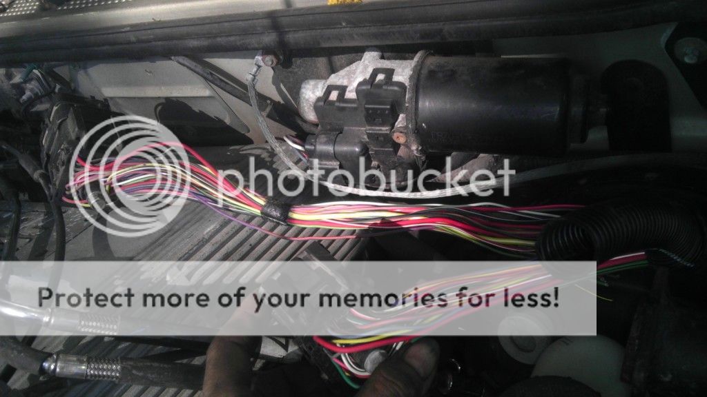

After that, I started on extending the 42 pin plug. Here is the section I got from the boneyard, I had cut it about 6" too long, so I trimmed to fit. Here is the trimmed plug...

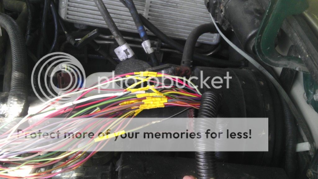

And here starts the long process of extending the harness. There are a few wires that are not just "plug-n-play", so the necessary rewiring will take place during the extension process. In case you missed the first two extensions I've done, here is how its started...
I have about 6 or so connections made, at which point it started getting dark, so I called it a day...

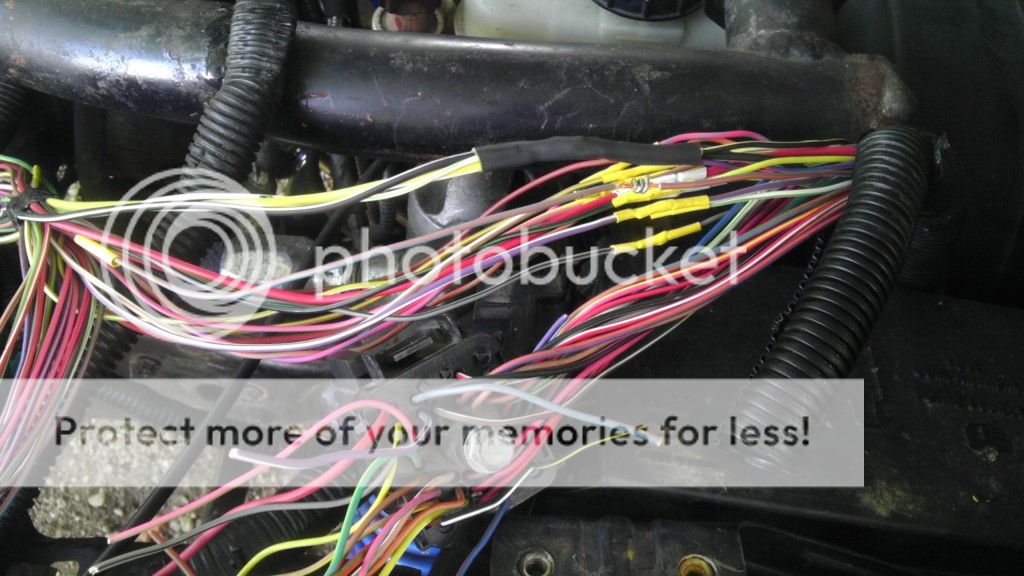

I mounted the fuel tank on the frame, that was fun. Then I continued on the wiring. I'm about half way through...
And after a few hours, I'm finally on the last wire...
Then I fixed the starter harness. The 01 harness was for a 3.0, which has the starter on the driver side. The v8 has the starter on the passenger side, so it has to be lengthened. Got that done, then I swapped out the fuel rail flex lines, ended up having to pull the upper plenum, which was also fun. What's left? Need to fab a new set of motor mounts, need to modify the tranny cooler mount then mount it to the core support, need to install the oil filter adapter hoses, the ones in the kit are a little short, so I'm going to swap em with the ones on my Trac, need to get and install lower rad hose, and lastly I need to fab a trans crossmember...
