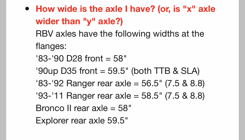

Has anyone done this. I can find a lot of info on using a Dana 30 from a TJ but there not the same. I know it’s probably not the first choice but since I can get one for free it worth exploring. Thanks
