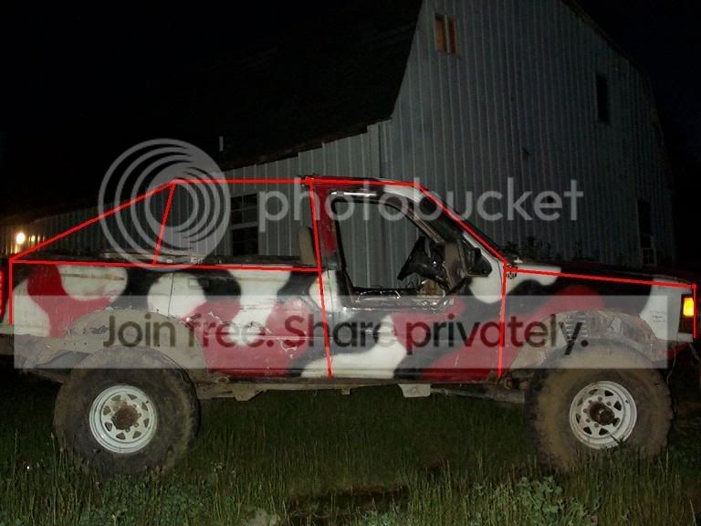

so I decided to ditch most of the exo...run the front tubes inside the fenders and just start building the internal cage...
plans
actual to this point (blue tape is where I need another tube and all the way down to the slider..and the tape on the fenders is the cutline..)

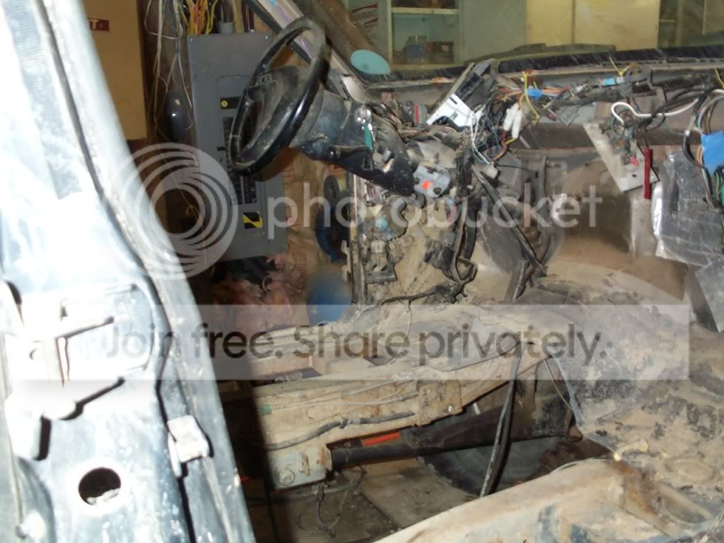

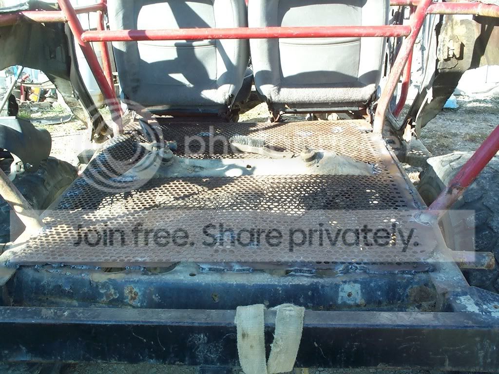

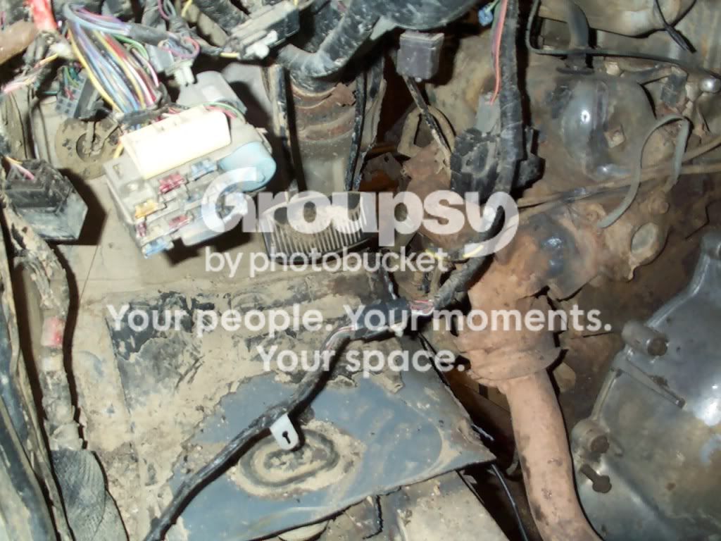

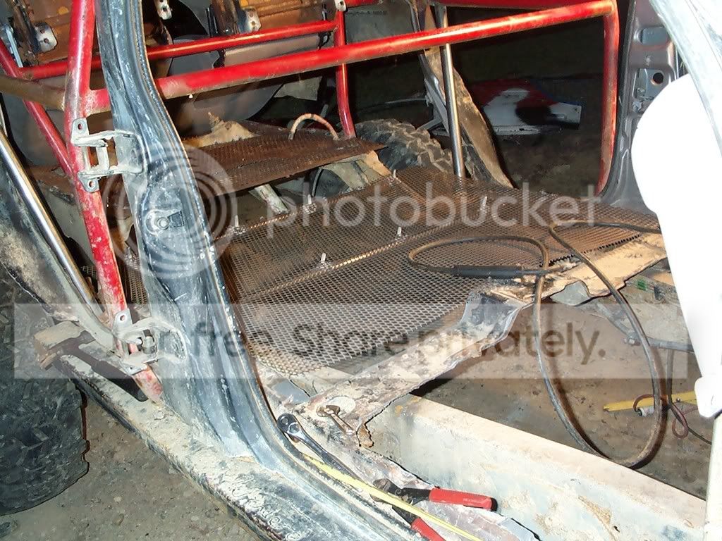

cut the floor out so I can doghouse for the motor move and throw expanded grating down for several reasons..
1.makes it easier to clean out (we mudbog with it too)
2.make it even lighter
3.mount the seats to the cage rather than whats left of the body.
4.so I can monitor the driveline and see tire placement thru the holes. (thanks Billavista for the idea from your truck!)
ditch the back bench..throw in 2 spare buckets I've got..and 4point harness all the seats...

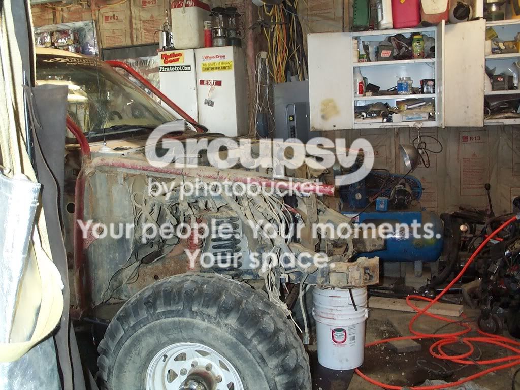

got the motor out and resting...
now time for the plasma...hope it gets home today...been gone getting repaired...UPS says it'll be here today!!

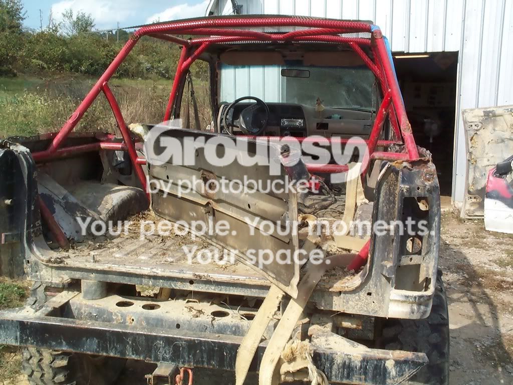

well..aside from having to stop twice on saturday..(to pick up a sidejob..and then to get food later..and many people stopping by to hang out and/or needing something..)...I think I got alot done...was out till 2am cuttin and triming...at 1am the dogs gave up and went to bed....(slackers!!)
at the CRACK of NOON!! (wife and kid took off with my SIL for the day..so I slept in...sue me!!)

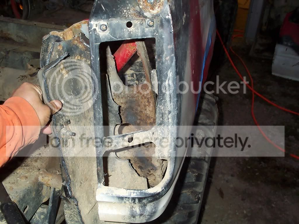

back doors skinned
tailgate skinned..(dam there was bout 60lbs right there!!)
trunk?
and heres the point after all the stops and people swingin by..
(notice its suddenly now dark...)

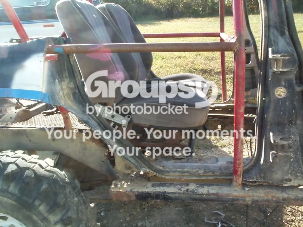

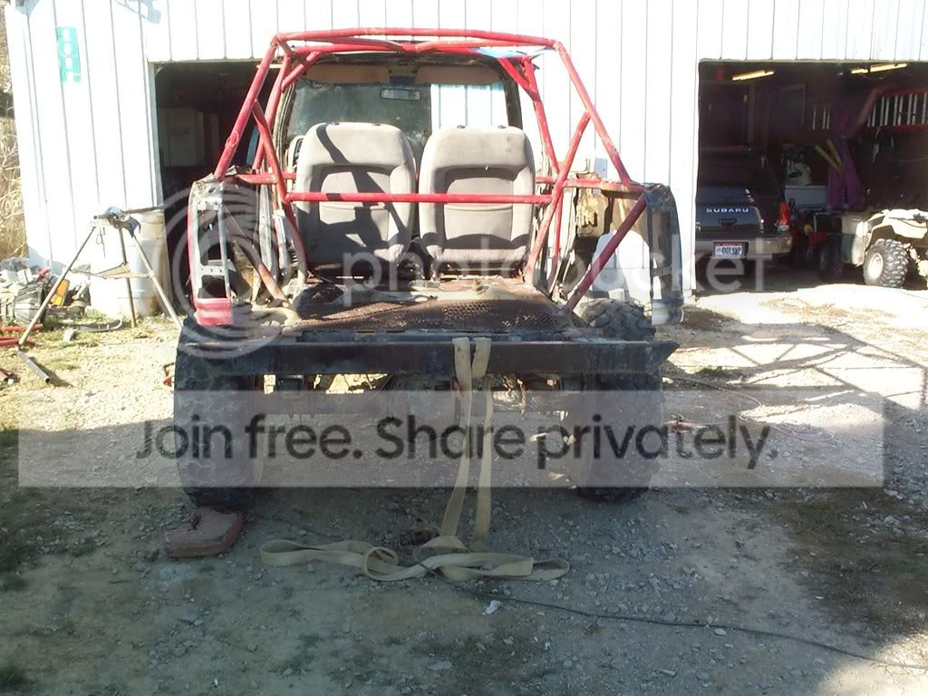

after this point the camera batteries died..I got some crappy cellpix..but heres the finnishd product as of yesterday..still have the firewall to do..but need to get the floor in the rest to keep it aligned till some of the wall comes out...
skins on real quick..not sure how much Im gonna hack out of the front doors yet..so theyre unmolested..(for now..)
MOST (not all) of the pile....easy 300lbs...EASY (per my back)...

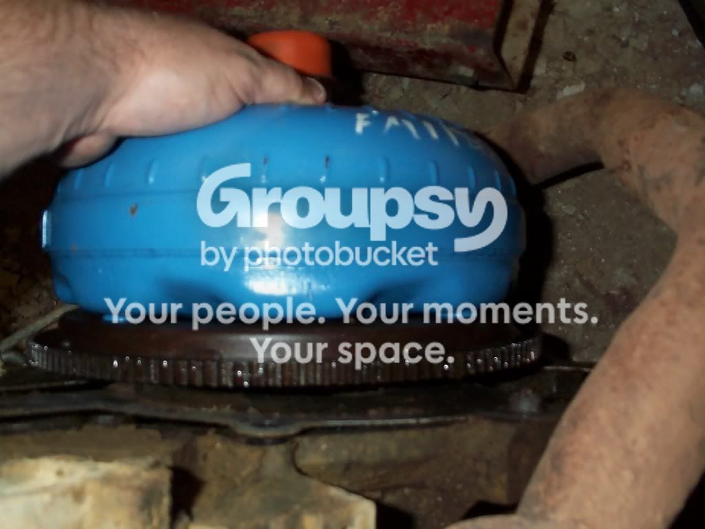

the C4 converter (orileys fm118) fits the A4LD flywheel
A4LD converter
Im guessin SB flywheel..compared to a4ld flywheel..
sb flywheel compared to c4 bolt holes.

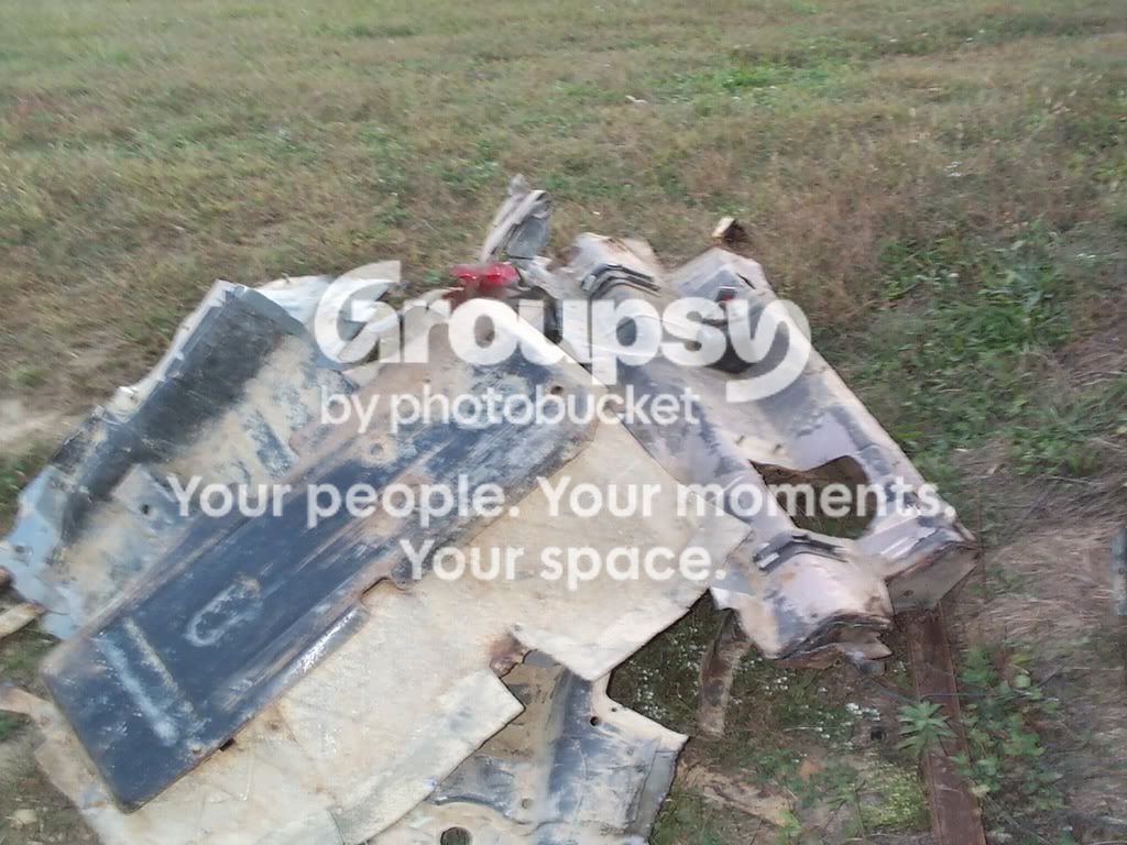

Took scrap in saturday....410lbs of stuff out of the sploder!!...hows THAT for a weigh in???:D

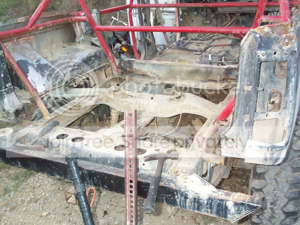

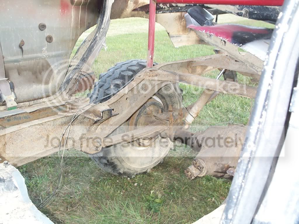

well got a LITTLE work done yesterday...
rear floor in...back seat support in..gottem tacked in for now..(gotta get bolts today)
and an extra upright I wanted for support..:brow:

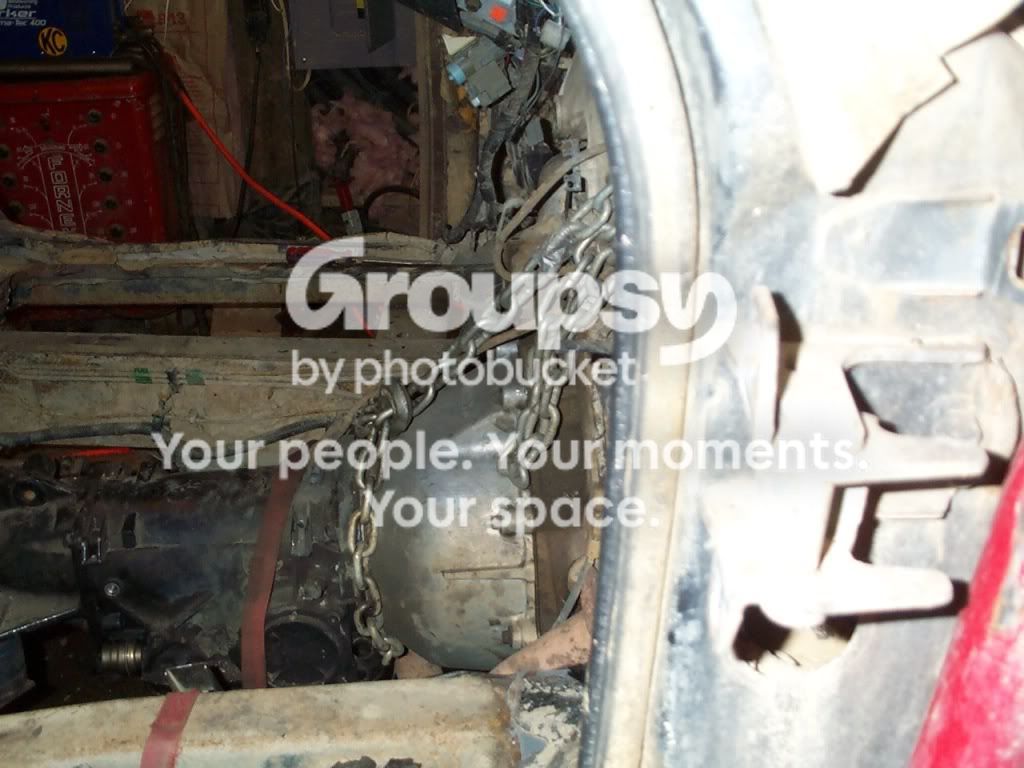

got the bell mounted on the trans..and grabbed stuff to get the cooler lines plumbed in..and vents plumbed...
mocked the motor in...lotsa choppin...but as it sits now..14in back from stock and 6 down..gonna pick it up about 2 more to help the belly...
