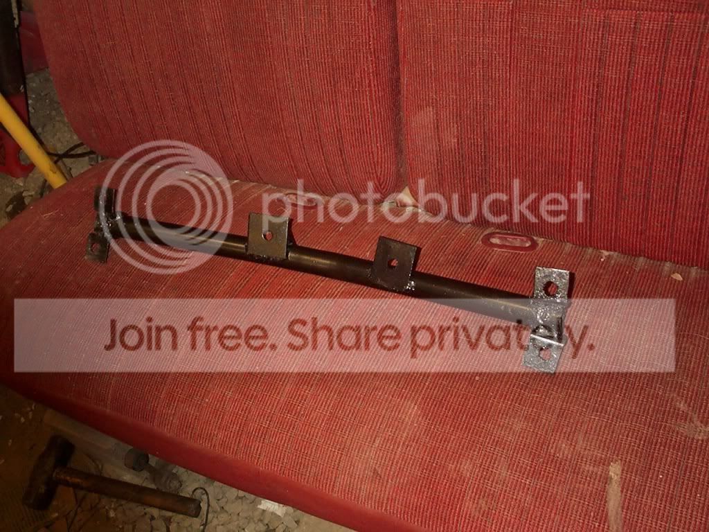

mounts made..some of the tunnel made..and back of the front seat hoop bent..and some LOUSY lookin welds...

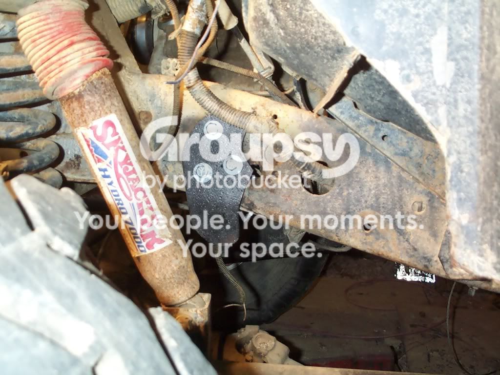

I know yall loved the gunrack buckets..how bout some wings to match the radius arm mounts!!

(dont mind the unbolted shock)

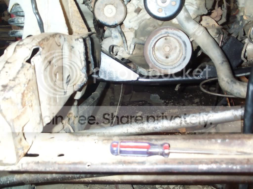

oilpan height..

front seat mounts in and tacked...dash bars in and tacked..center console in and tacked...

Looking good, I like the custom cross members.
You oughtta take a pressure washer to that entire thing!
Maybe it's just me, but I hate working with grease mixed with oil and dirt, it's like the worst combination.
Are you using pipe or is that a type of structural tubing?
1.5 .120 Dom tubing...
its acually fairly clean...most of the dirt is from inside the frame rails..and the grease is from the powersteering pump leaking..
