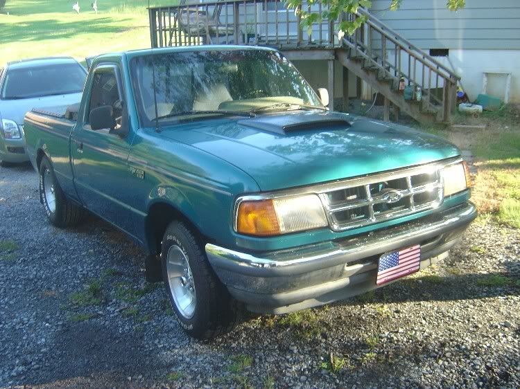

Aftermarket wheels should fit fine, the factory aluminum wheels such as my Canyon 15X8 wheels have to be machined out.
Here's pic of BEFORE:
After with push-thru centers:
