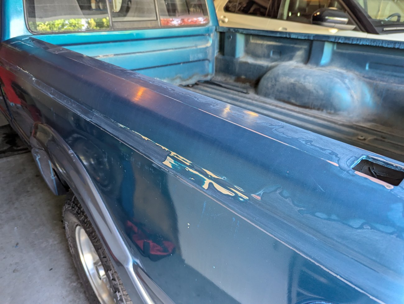

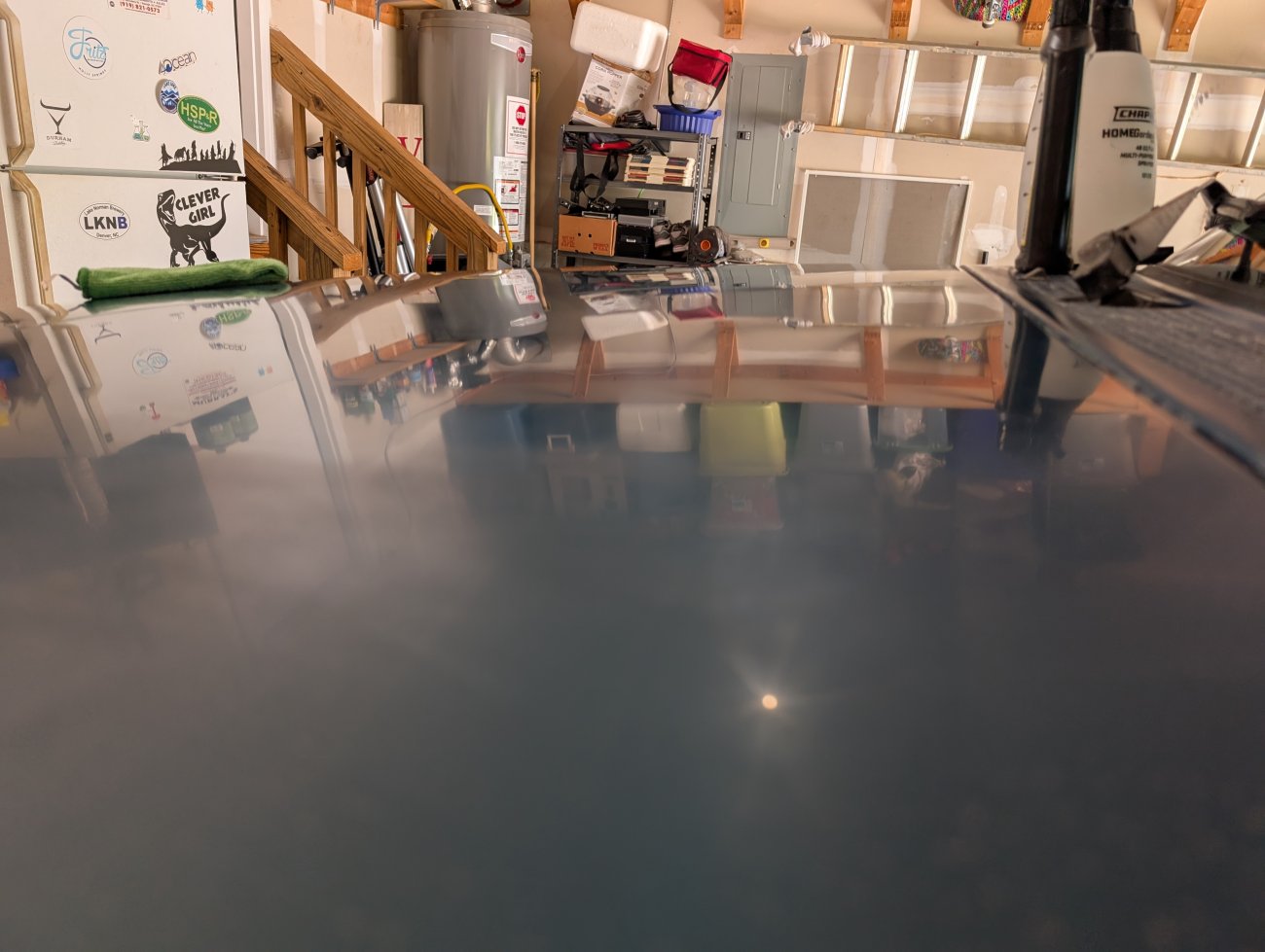

Had the day off from work today and did bodywork from 9am-4pm. I got the bed sides sanded down to 2000 grit in hopes of just clear coating them, but now I'm on the fence if I should paint the spots where I burned through to primer.
Will have to think on that. Here's a couple pics. I'm open to opinions

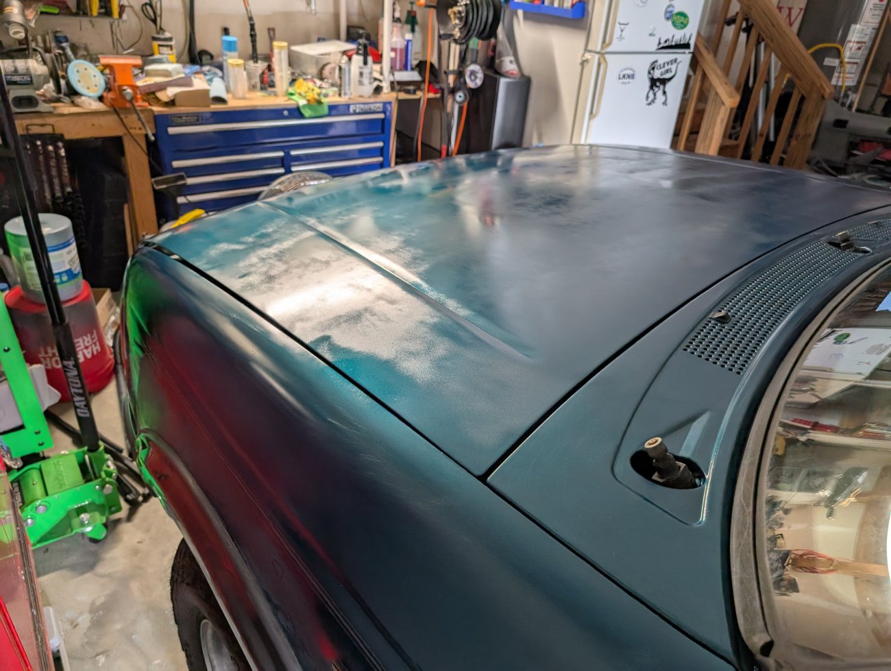

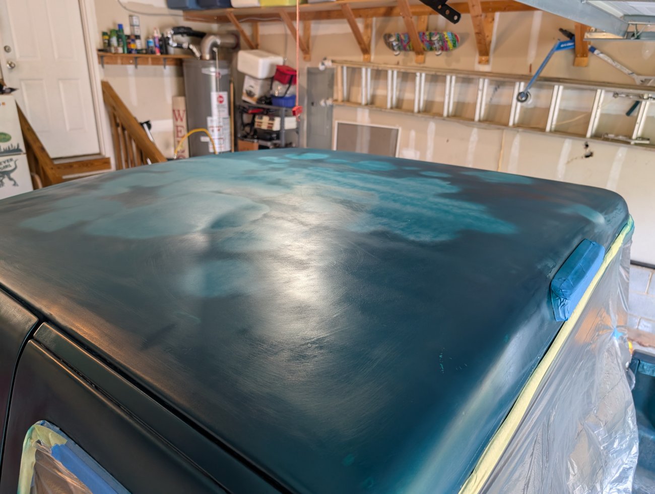

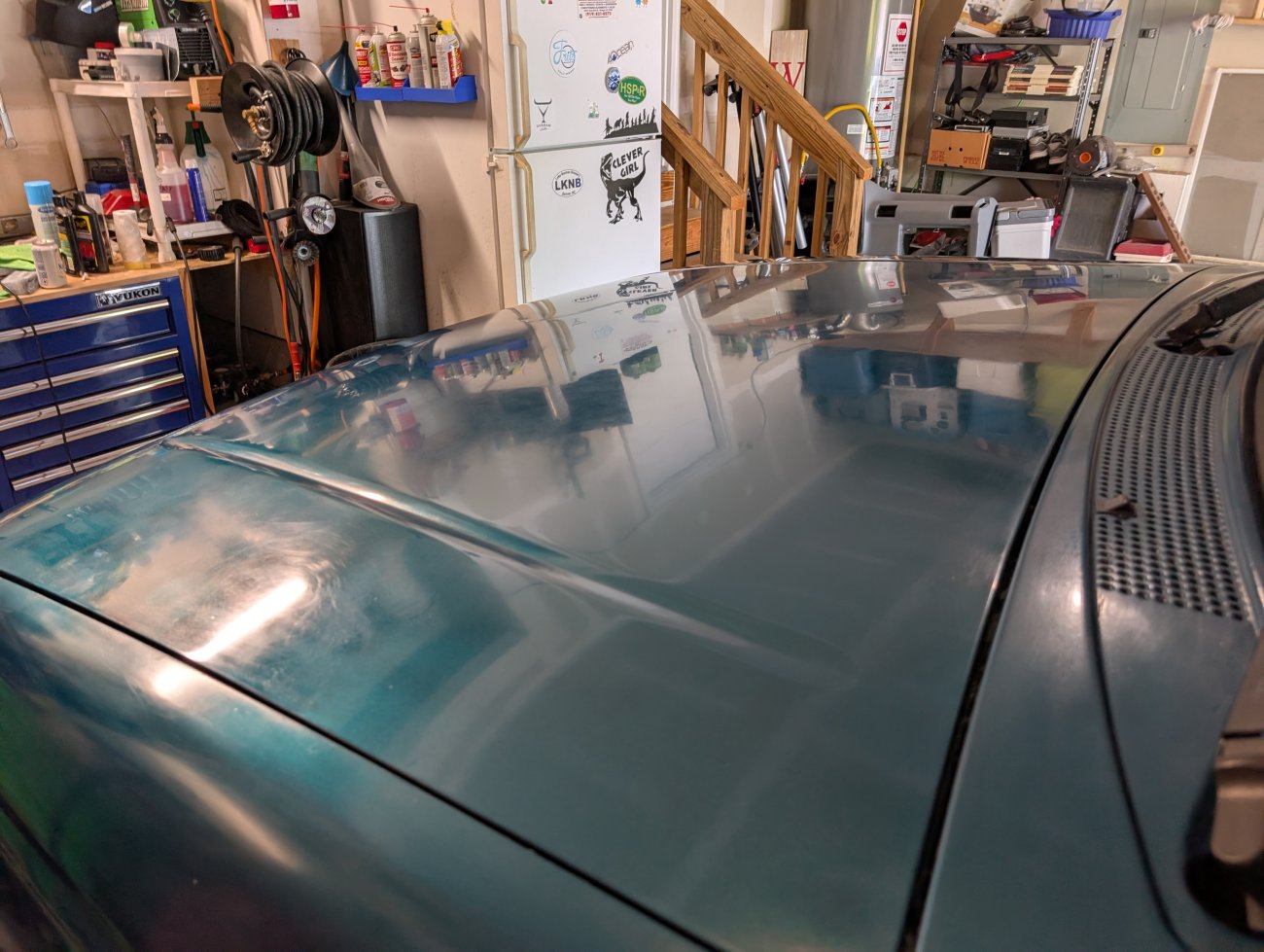

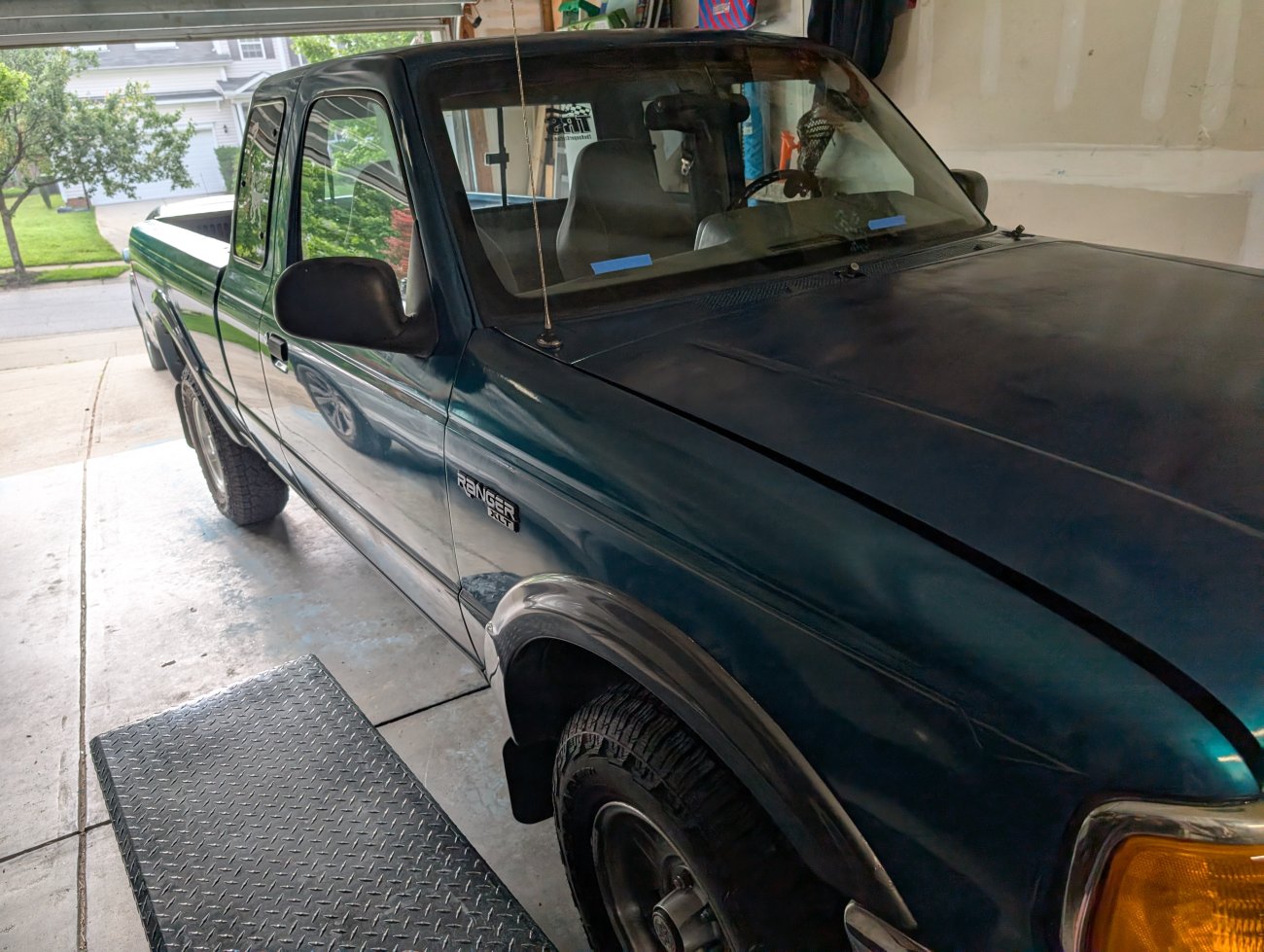

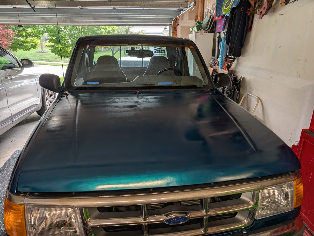

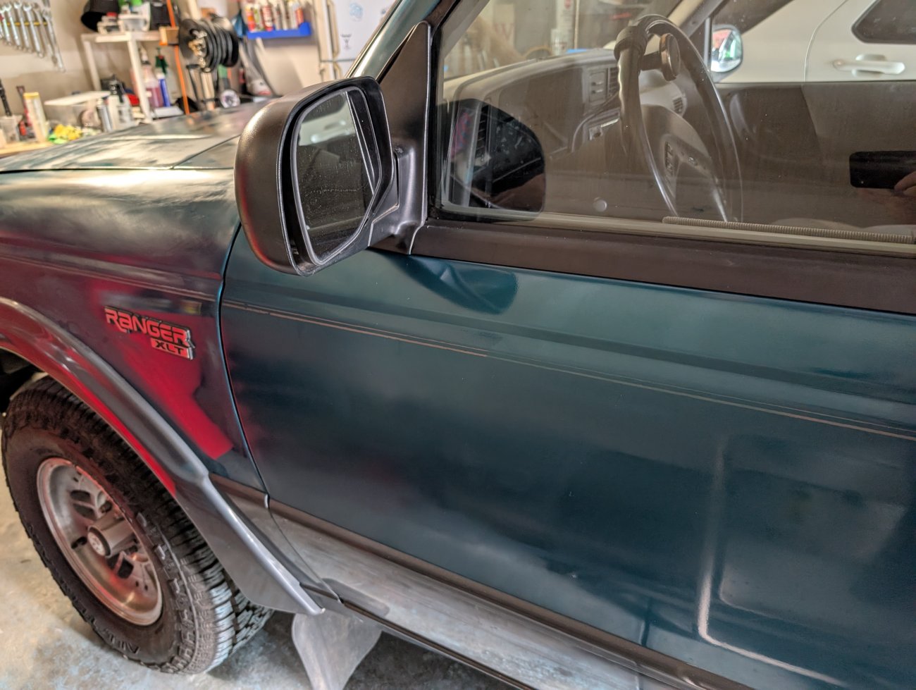

Still need to finish sanding the roof, fill the gap at the top of the windshield and sand the upper doors.
I was hoping to just paint the roof, hood and maybe tops of doors but I filled a spot on my door as well.

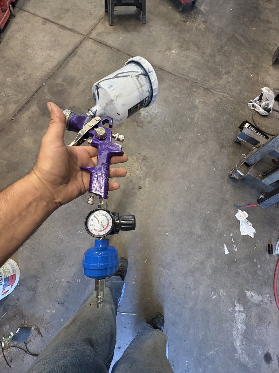

If you are going to use a spray gun, get a pressure regulator at the gun. That is where you will get the pressure set at correctly. To get the proper air pressure, have the trigger fully pulled to adjust the pressure. From the hose, get those disposable desiccant water traps. Depending on your humidity, you may need to change disposable with each fill up of paint. Otherwise you will get water dripping off of the end of the gun. Water dripping is not a problem on doors and bed side, the vertical panels. It is an issue when painting your hood and roof as the water will drop on the surface. Ask me how I know lol,

What's the gauge on your gun used for?
I'm guessing to control pressure at the gun instead of at the compressor?
(I say that because I have a similar gauge on the my compressor and it seems like it would make more sense to have the pressure reading at the gun for a more accurate reading).
@rumblecloud I have hose drops on both sides of the shop. It makes it easier to control the air pressure better. If you have a short enough hose,having the regualtor at the tank would probably be ok.

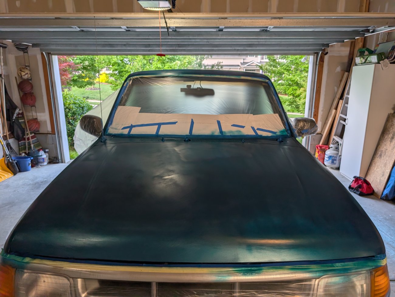

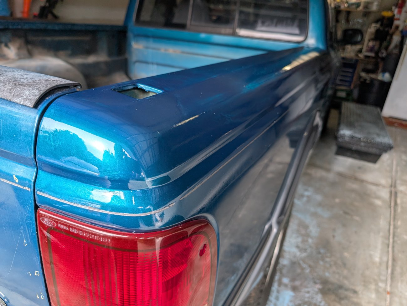

"Finished" sanding everything to 320 got it masked off and started spraying. I severely underestimated the amount of paint needed after I decided to spray more than I originally thought. 2 cans didn't get me very far, ordered 4 more but can't get them until tomorrow.
I think the color will end up pretty close. All the reading I did to prep for painting said sand everything to 320.
As I was tossing the empty cans I just happened to check the instructions and it definitely said to sand to 600 😱
I can definitely see my sanding marks still, maybe a couple more layers of paint will bury them, maybe not. Going to send it and clear coat it tomorrow either way. Will make for a good story and lesson learned.
Thanks for the link, I have looked all over the place for it and knew there probably was information on it somewhere. I still stumble into things and still learning how to use the sight.
I have seen 320 used as a finish sanding, sometimes it works and other times it does show. So now I finish off with 600 and not had any issues with scratch marks. It will look better than it did, and you will notice the flaws more than anybody else as you know where they are. Most people are worried that painting their truck or sanding it is going to melt away. It will still be there when you are done, lol. A few more times under your belt and each will get better. It is amazing what a paint job can do, and I think it is rewarding when you get it done.
For me as a rule of thumb and not counting doing the inside of the bed, 2-3 quarts is needed to do a complete truck. You are getting there.
Well, I finished it though I probably should have pulled back and re-evaluated. Sprayed 4 more cans of the dupli-color, probably could have used another 4...
Used a 2k clear coat spray can. First can exploded when I hit the activator button. Second can worked pretty well but obviously wasn't enough. Ran out of time and material. I'm out of town for the next week. It can cure and when I get home I will see if a cut and polish will improve it some.
At this point I'm going to call it a $250 learning lesson that cost me ~30 hours of my life 😂.
I'm hoping the polish will even it out some and I can live with it for a few years. If not, I'm already researching single stage paint systems.
@Terrys87 - what kind of spray gun do you use? I was initially thinking gravity feed, but I watched a guy have really good results with syphon feed.
Overall, it's "better" than it was at least. And again, I learned a lot

This last pic shows the part that came out the best. Paint laid down really well on that corner above the taillight.
Hey your truck is still there and did not melt away. It survived your first paint job. It does look better then when you started and looks better overall. Your tail light area is probably what it looked liked brand new. It is surprsing what a new paint job can make you feel when it is a really ugly truck and looks new again and to me is rewarding. The guy that taught me bodywork and paint would only use the siphon an he did insurance jobs which is usually about 5 year old cars or newer. He was 75 and had to quit at 80 due to his eyesight.He passed at 82.

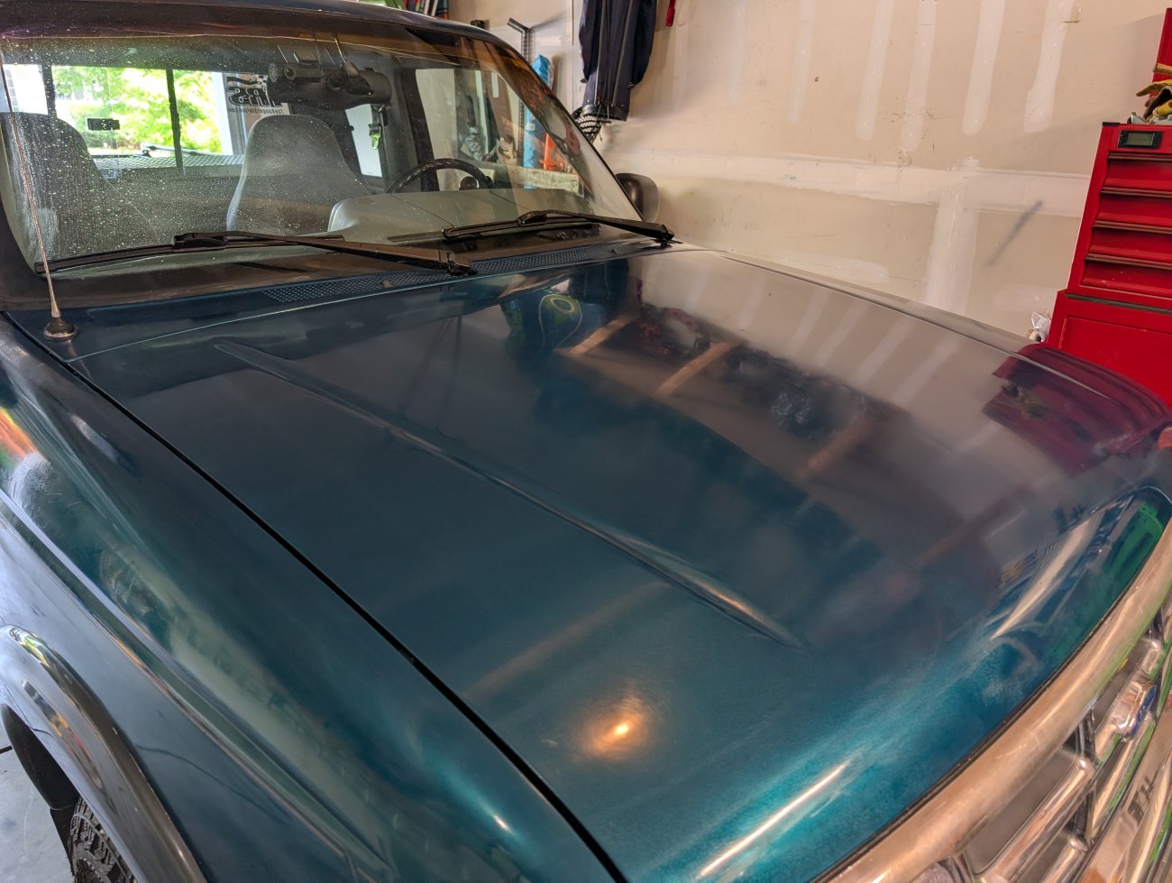

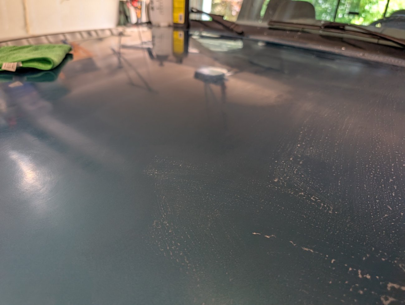

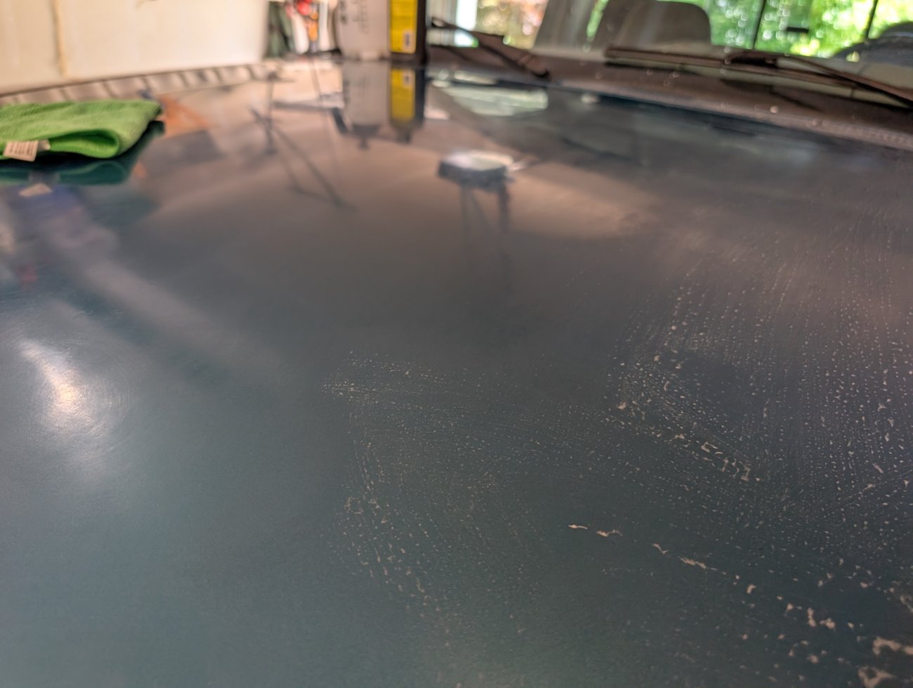

After 6 or so hours of wet sanding with 800, 1200 and finally 2000. I mainly focused on the hood and the doors and and the very tops of the bed.
Then DA and compound and finally some wax and I'm much happier with how it turned out.

It's definitely not perfect but it's so much better than it was. Didn't even pretend to touch the roof, too hot out.
