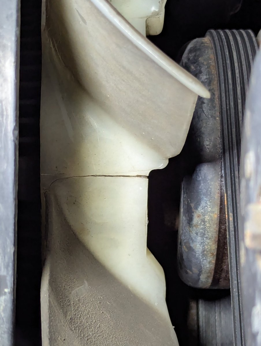

Working on the AC today and while fighting with the quick connections I noticed my fan was cracked up pretty badly
Jballard81's 1994 super cab 4.0 4x4 Restore
It's about this bad between each blade...
Should I try to find a metal replacement? Probably would be wise to replace the fan clutch as well while I'm at it right?
Yessing. Not a hard job, considering what you've already done.

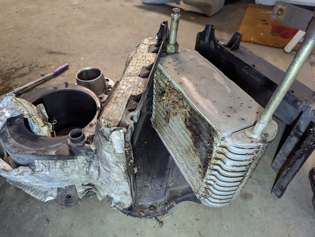

The evaporator is the only component I'm not replacing. She's a bit burnt from the leaf fire.
Also found and patched some burn holes in the housing

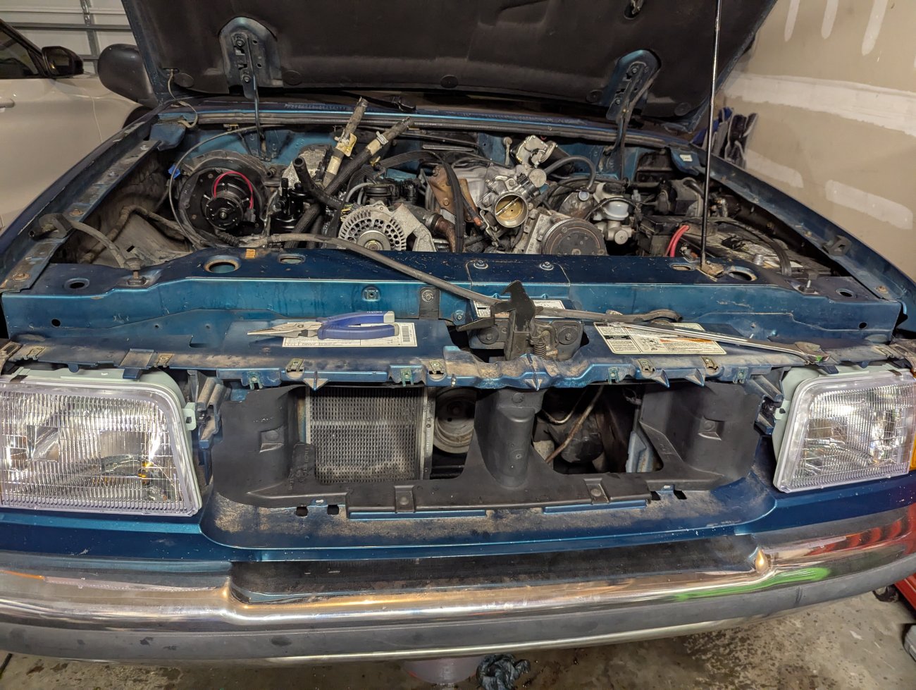

I wasn't able to sneak the condenser out from behind the radiator. It may be possible, but I figured I might as well make it easier and take the opportunity to flush the radiator.

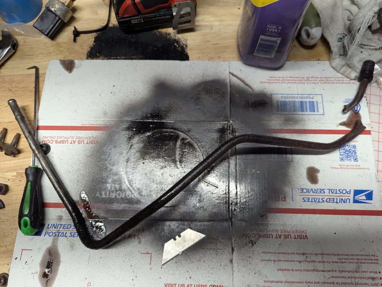

Lower transmission cooler line was seized to the nut. This goes to the auxiliary cooler in the front.

Not sure if that's a stock line, gotta check rockauto.

Pulling the radiator is worth it, as you can get a much better flush. Bummer about the line getting toasted, though.
If your tool budget allows, a set of flair fitting wrenches are well worth having.
I actually bought some flare nut wrenches in prep for brake work. I didn't even think to use one for this application. Doh!
Will definitely remember next time around.
The good thing about having a set, like on that frozen radiator ATF line, is you can set up two wrenches to do the "squeeze" (i.e.- squeeze the wrenches) to break the fitting loose, and there's no danger of rounding a flair nut or twisting something.

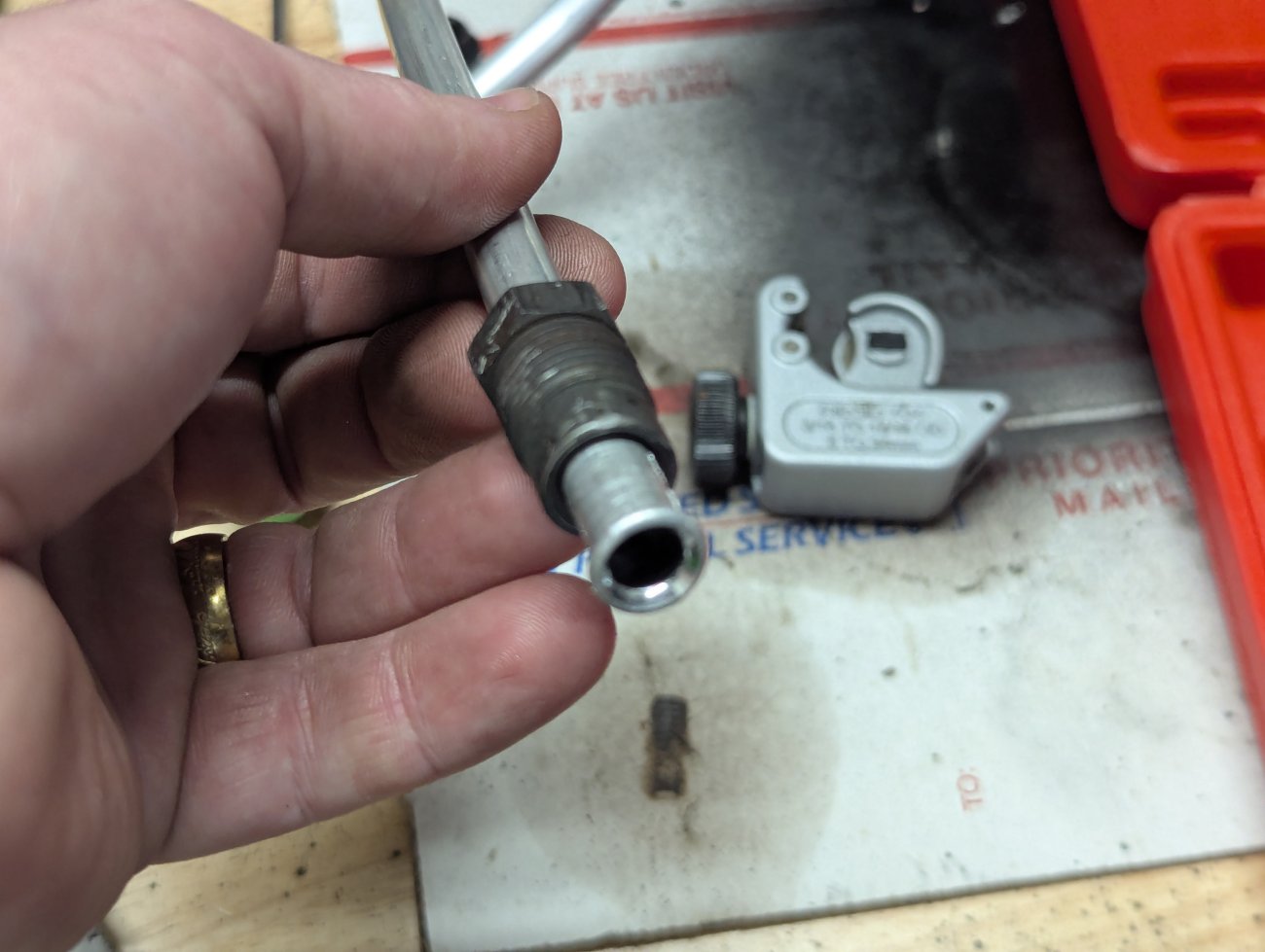

Bought some 3/8 line and the cheapest flare tool ($12) I could find on Amazon.
Read the reviews and found a gem: *the wingnuts give up easy, to account for that, use a vise grip to help them*
This was a super helpful tidbit.
One practice run then went for it and I'm calling it acceptable 😂
Looks pretty good from where I'm sitting. I bought a couple double flair tools till I found the right one. I little practice and I was able to do the rear brake lines. If that's your first one...you're good to go .

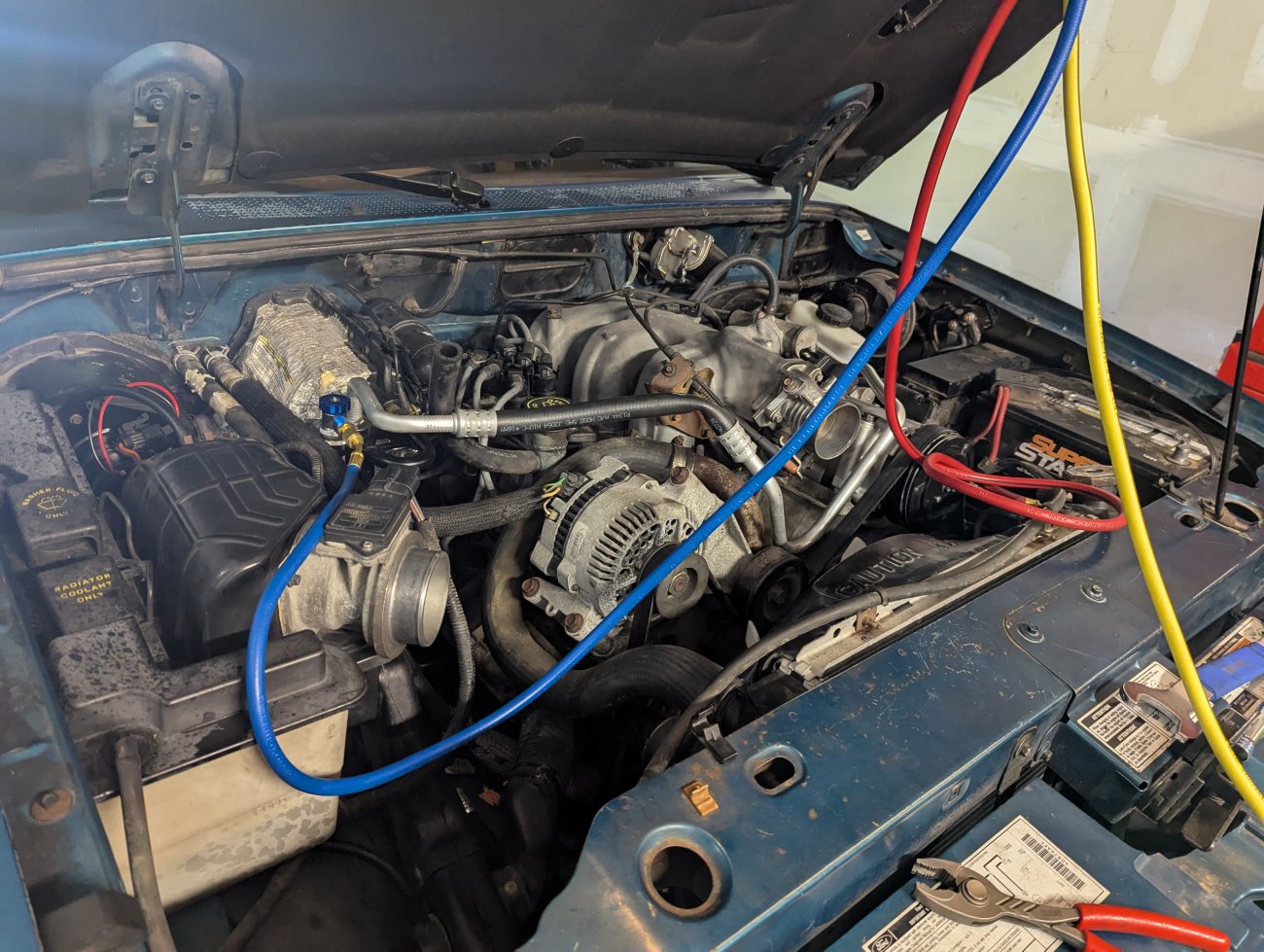

My 15+ year old harbor freight manifold set did a good enough job I guess. It held vacuum over night so that was the important part.
Very glad to have AC in the truck! I flushed the radiator out while I had it out and noticed with the AC that the system runs a little hotter than without which makes sense. Still in the normal range, waiting for it to cool down and I will check the coolant level.

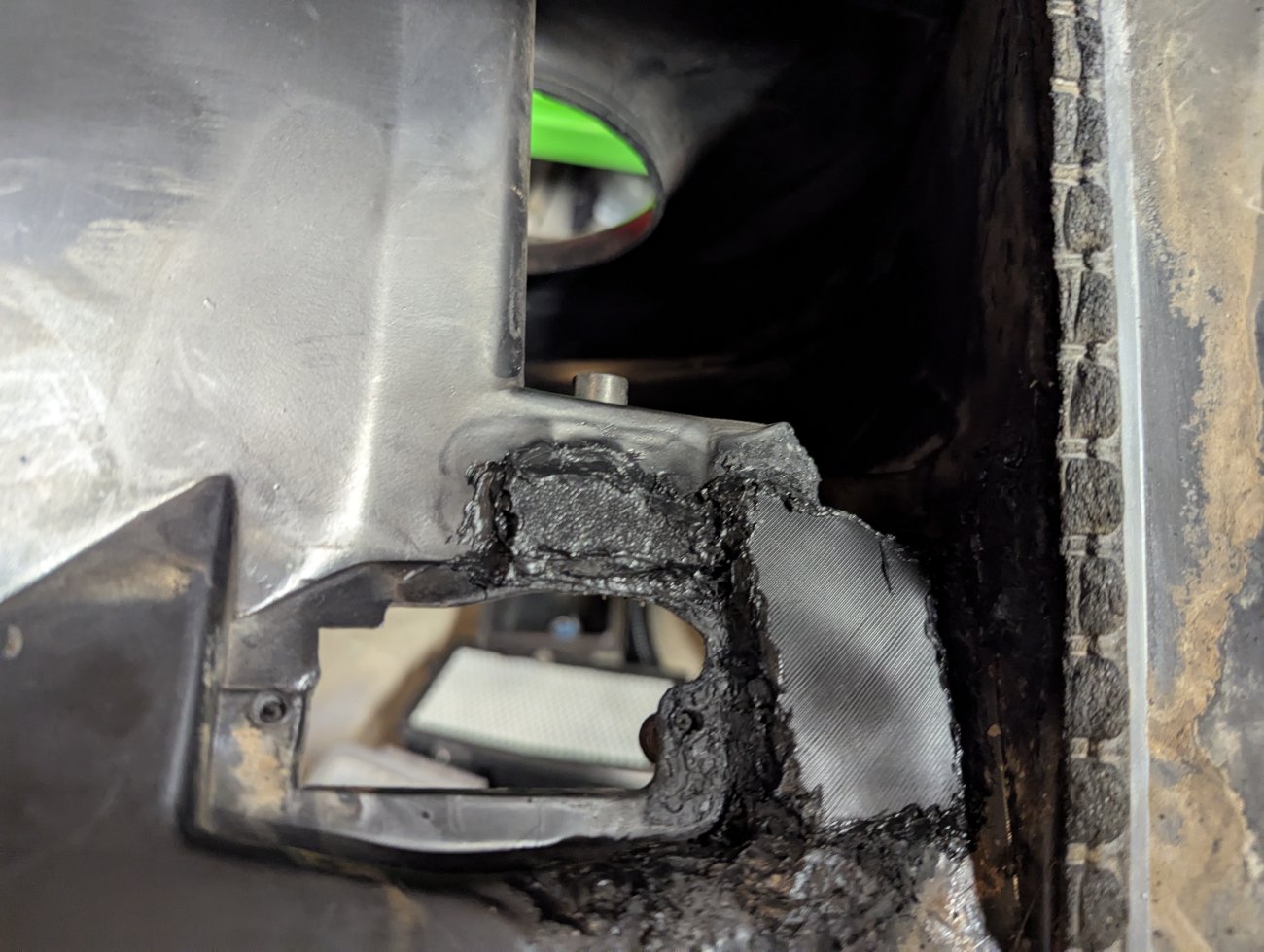

First attempt at body work and paint. Just slowly getting it going. Found that my hood support had separated from the sheet metal which was probably why the last body work failed:
I saw that 3M window weld would be a good option to fix it, so being the penultimate cheap ass that I am I bought the cheaper alternative which didn't harden enough 😂.
'fixed' it with expanding foam. Then hid my shame behind the hood liner. Took the bounce out of the hood skin so I'm calling it good enough. I have no doubt that my paint work will eventually need to be re-done anyway at some point in the future.

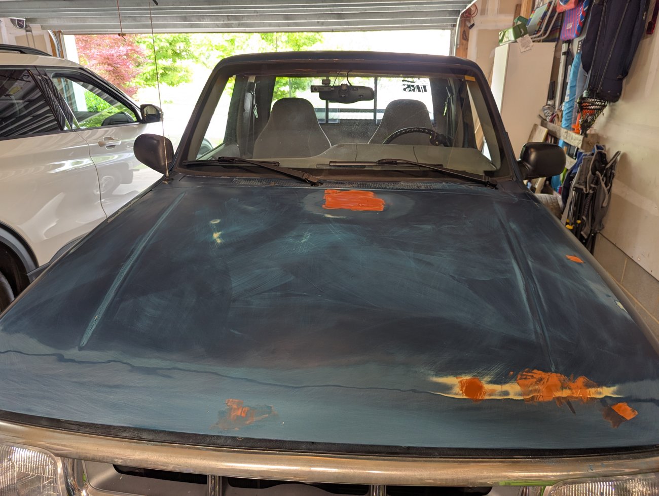

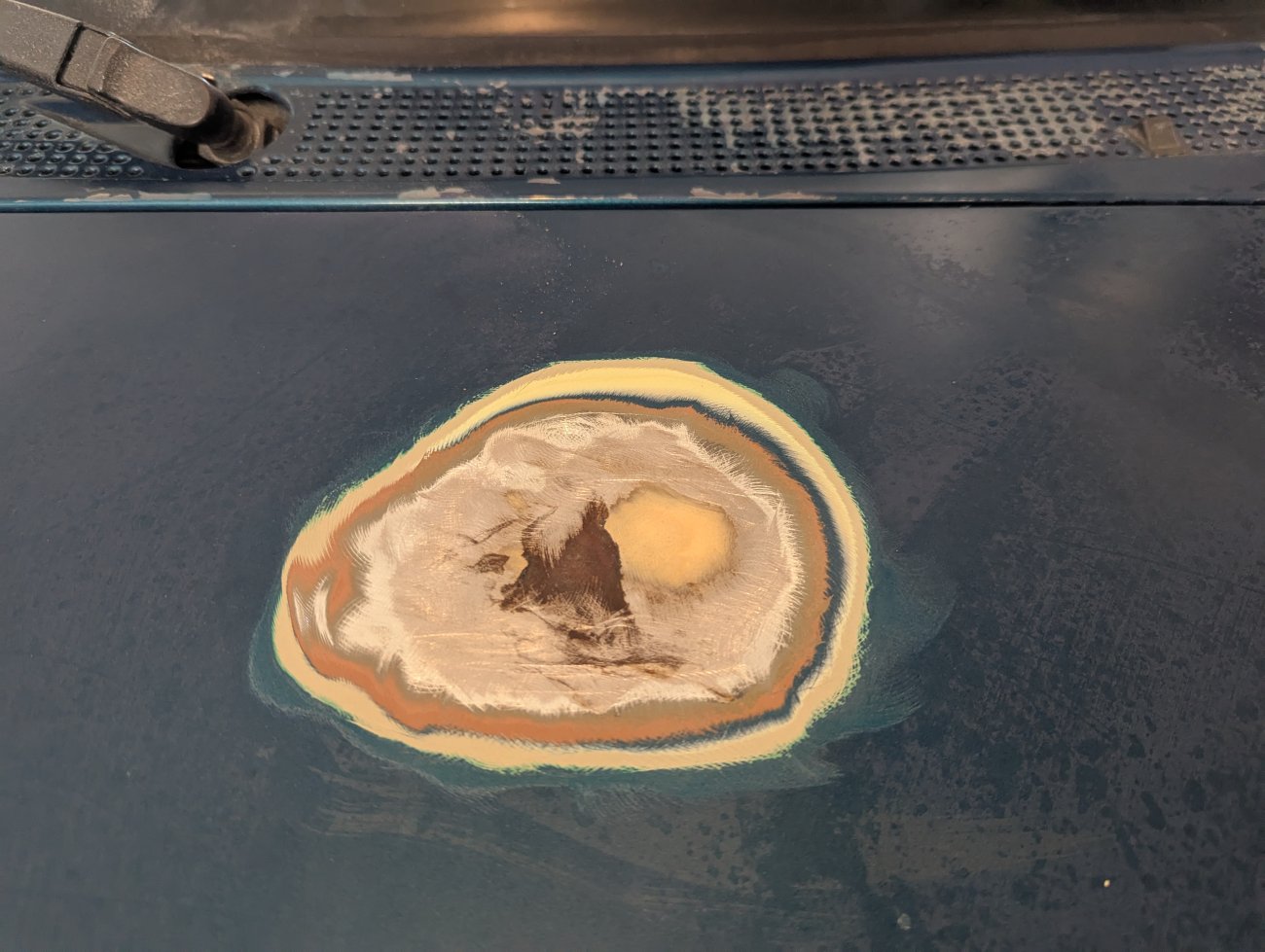

Main damage on hood:
Looks like the entire hood was skim coated so I'll just add some new filler and move along.

Rest of the hood was knocked down using 180 and small imperfections filled with icing. Needs to be sanded again to see how the filler looks.
Probably should primer the entire hood and then block it out to see how bad of a job I've done 😆. Or I could just primer the filler and spray.
We'll see how it goes.
