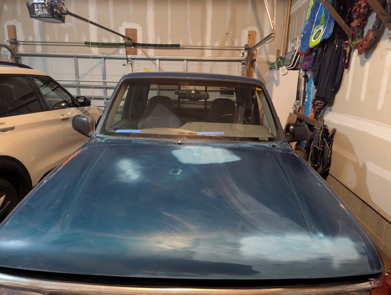

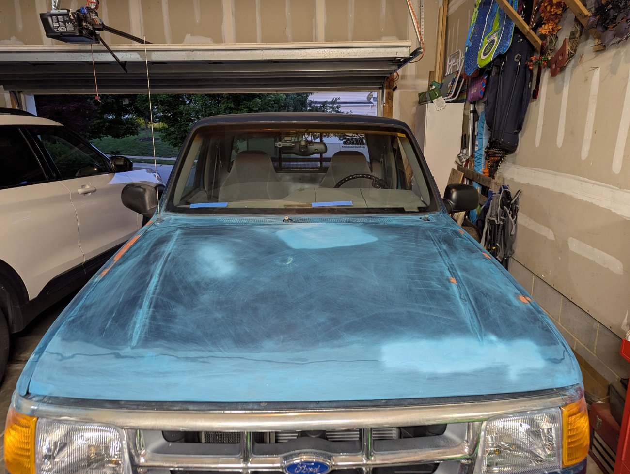

This is where mine is ATM. In the same boat with what to do nest.

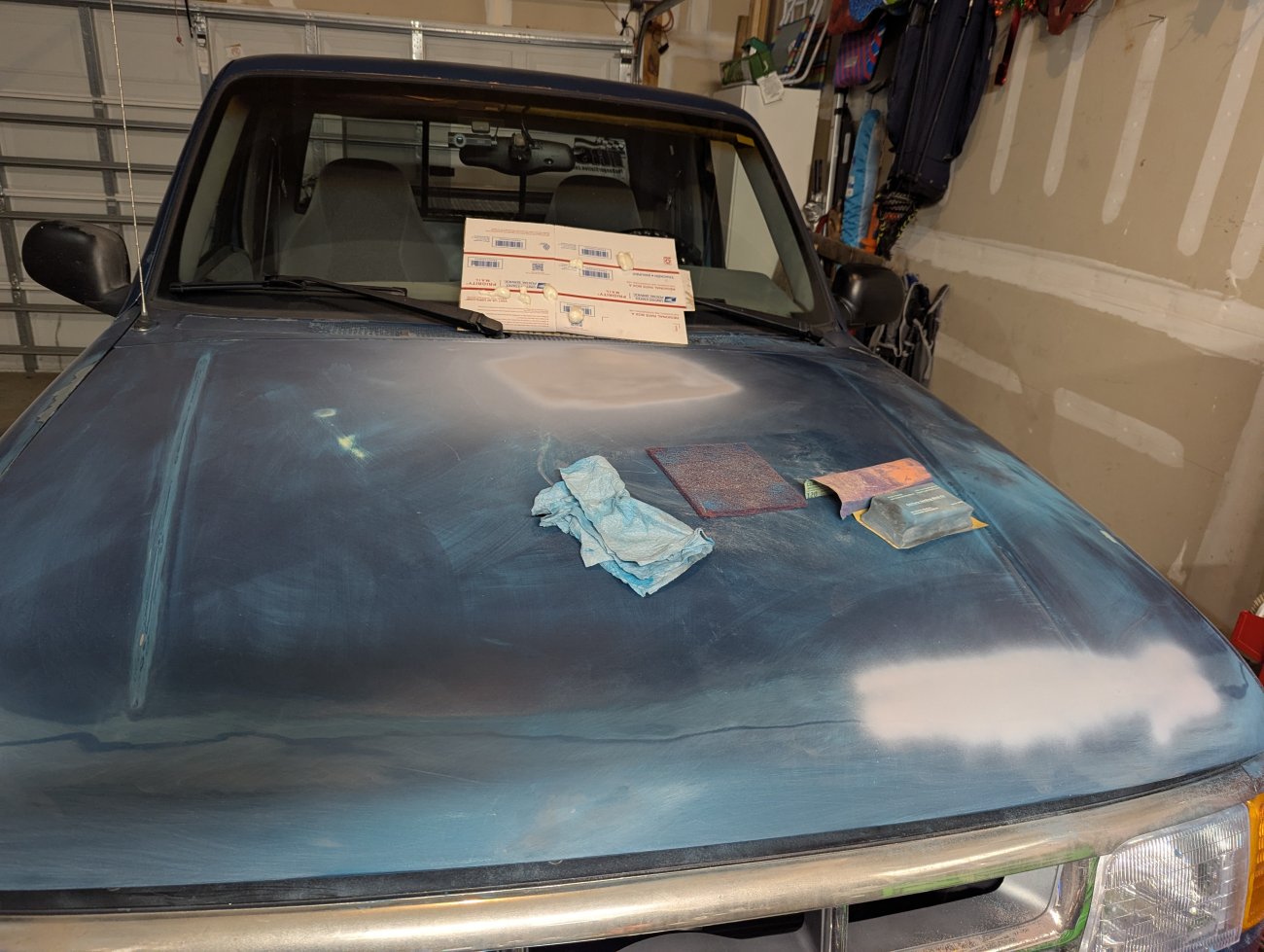

Sanded down the icing and then gave the rest of the hood a wipe down with red scotch Brite. I went ahead and put a couple layers of primer on the repairs only so far.
The entire hood needs to be sanded down to 600 grit according to the instructions on the dupli-color can.
Probably give the big repair a guide coat to get an idea of how good/bad it is then go from there.
Not to get ahead of myself, but the door bumper guards that I peeled off the bottom of the sides of the truck messed up the paint enough that I'm going to have to sand it down and repaint with something. Will very likely be reusing one of the greys I've tested over the last year for my interior.
The body work this far has been fun. Very, very time consuming. But fun.
Up to probably 10 or so hours of sanding at this point and damned if it doesn't look the same 😂
I make progress then find another spot that needs filler, so I add a touch of icing and keep going.
I imagine someone with experience would know how to find the bulk of the issues at once. Though it seems like the name of the game to fill, block, find issues, repeat.

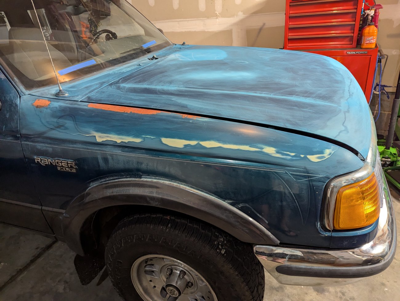

I've also already expanded onto the fenders. I plan on fixing paint on the hood and roof. Maybe another spot on the door. But everywhere else that is above the pin stripe will get the fading clear coat sanded down, hopefully not destroying the paint and then applying new clear.

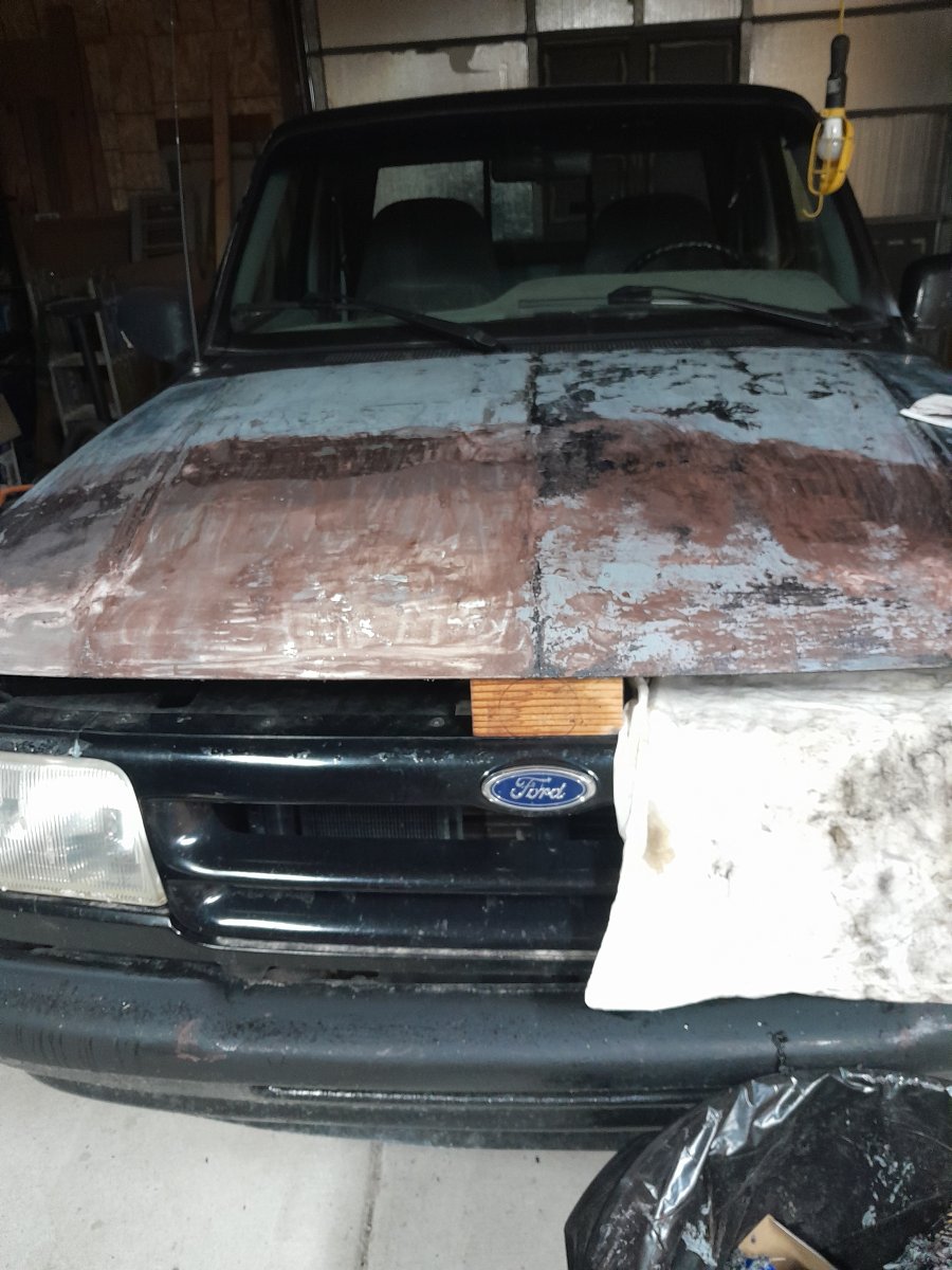

That's the method I'm using. I found the clearcoat difficult to remove by sanding alone. Right or wrong, I used aircraft stripper and even with that, it took multiple applications. I'm limiting my project to the hood for now with plans to move to the rest of the truck as I gain experience. My son-in-law is a paint and body guy so i have that small advantage for pointers as well as the experts here.

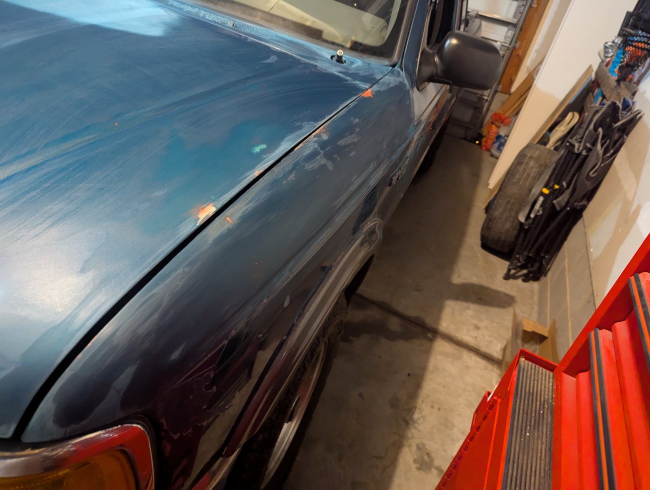

That clear coat is brutal. It's either flaking off or it's damn near impossible to remove without damaging the paint beneath.
I've had some success with 180 grit until I start to see color come up. The problem is the line where it's flaking, it's really easy to burn through the paint as I've clearly done in the fender 😂
My hope is that using the pin stripe as my line will allow enough of a "break" in the panel to not make the difference in new paint vs old paint too obvious. Either way, it will be an improvement and I get a chance to learn something.
I'm getting close on the hood and fenders. At least to my level of skills/effort.
I'm pretty pretty happy with it at this point honestly.
I'm not sure if I should try to finish the body work on the rest of the truck before starting paint. I'm pretty sure I should do it all, but I'm getting impatient already 😂

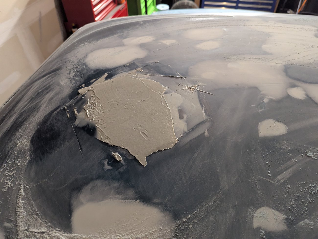

Filled and blocked the bulk of the roof. Didn't realize that the roof skin had separated from it's supports as well. I'm leaving it as is, my headliner probably won't make it back in if I took it out to fix the roof skin.
I want to apply a thin layer of fiberglass the next time the headliner comes out in hopes of making it a bit stronger and giving it some more life.
Roof had a bunch of bubbles/cracks in the clear. Way more than I originally thought. Took a lot of filler.

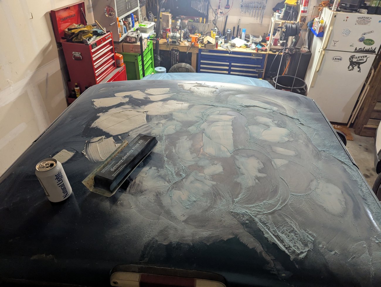

Took a lot of sanding as well. Picked up a cheapy interface plate for my drill to use sticker paper. That helped some but only had 180 so 120 with the block was faster.
It's only getting one coat. Will add a tiny bit more to the worst spot where it's still a little shallow, but the rest of the roof is good enough. Can't see it anyway.
Last bit of filler unless it looks really 💩 tomorrow. Would have to be pretty awful though 😂
If it's not perfect, that's fine. Due to the oil-canning of the roof skin it's not going to last forever anyway.

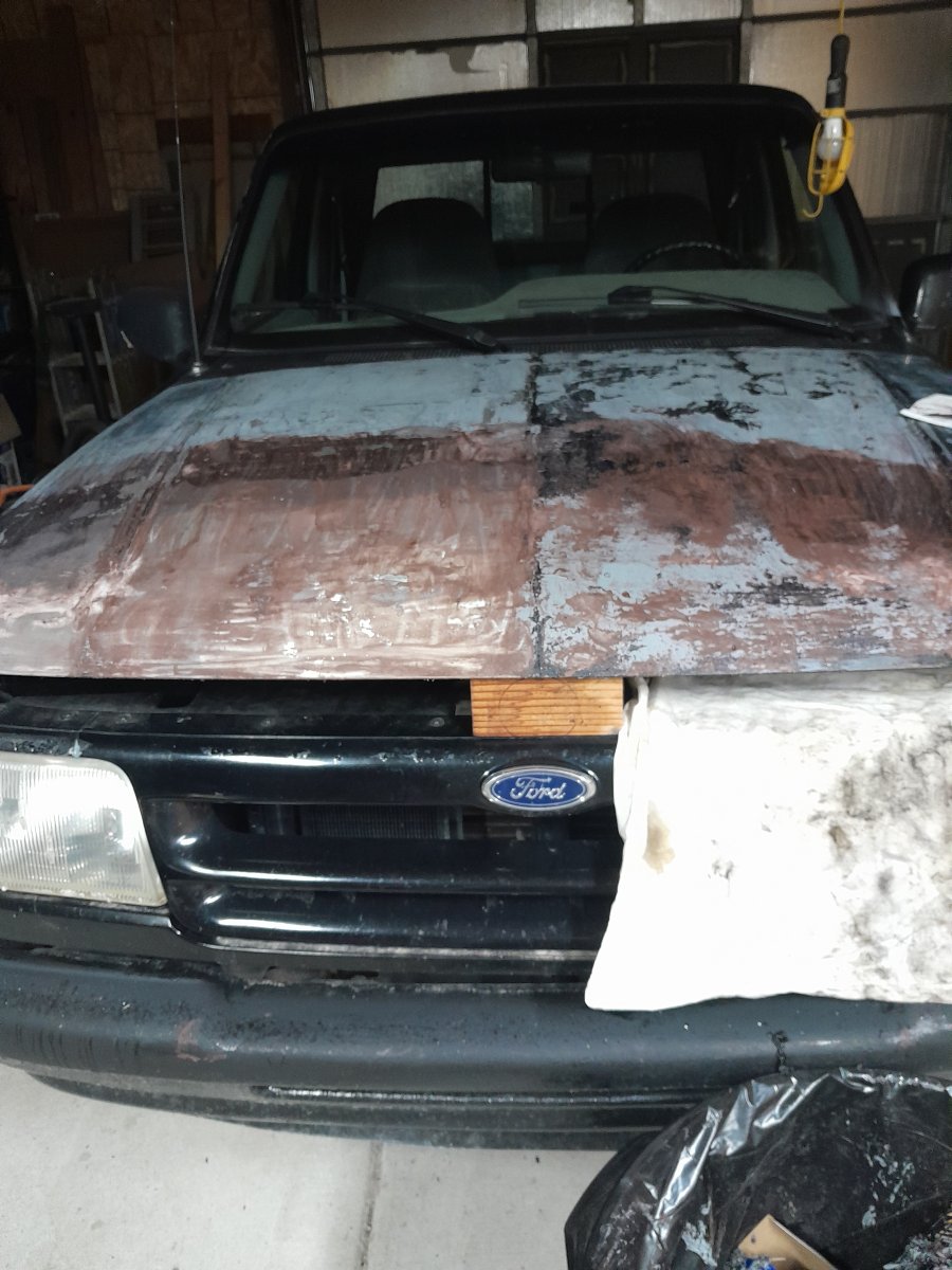

I'm making some progress with my hood. I had to go down to the metal on most of it so progress was slow.
