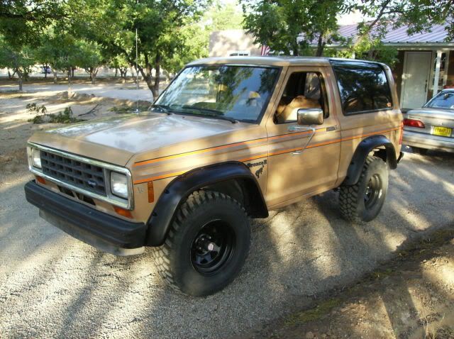

I'm not too worried about if the 35's will rub or not because i have cut fenders, and either lift would provide more clearance over the 35's than I currently have over my 31's.
Here's a picture to give you the idea
