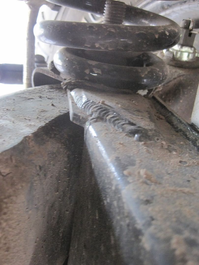

Can you get a better pic of the mounting ears at the axle? The way I see it above it looks like a notch right where it's welded to the body of the arm (bad), but maybe it's just the angle of the pic?
I don't think they look too bad, in person they look ultra beefy. I guess the boxed design doesn't quite have the flair of the tubed style arms, but the "cool factor" drop with the new style never crossed my mind:icon_rofl: The radius arms are pretty damn stout, each one if I can remember accurately was about 40lbs. My guess would be that the change in radius arm design was a cost cutting measure (the tooling for the tube arms was probably more expensive as are the raw materials most likely.) But the quality of the arms appears to not have suffered in the least. There is no comparison between these arms and the stock ones!
I am not sure what notch you are talking about, but regardless I will get another picture for you.

Are these the pictures you wanted?
Top:
James Duff or SkyJacker
Bottom:
Yeah, that helps. I see what it is now, it juts out at an angle where the ear gets wider. In the other pic it looked like there might've been a notch there.
Superlift's arms had a notch there, and low & behold, lookie what happens lol.
