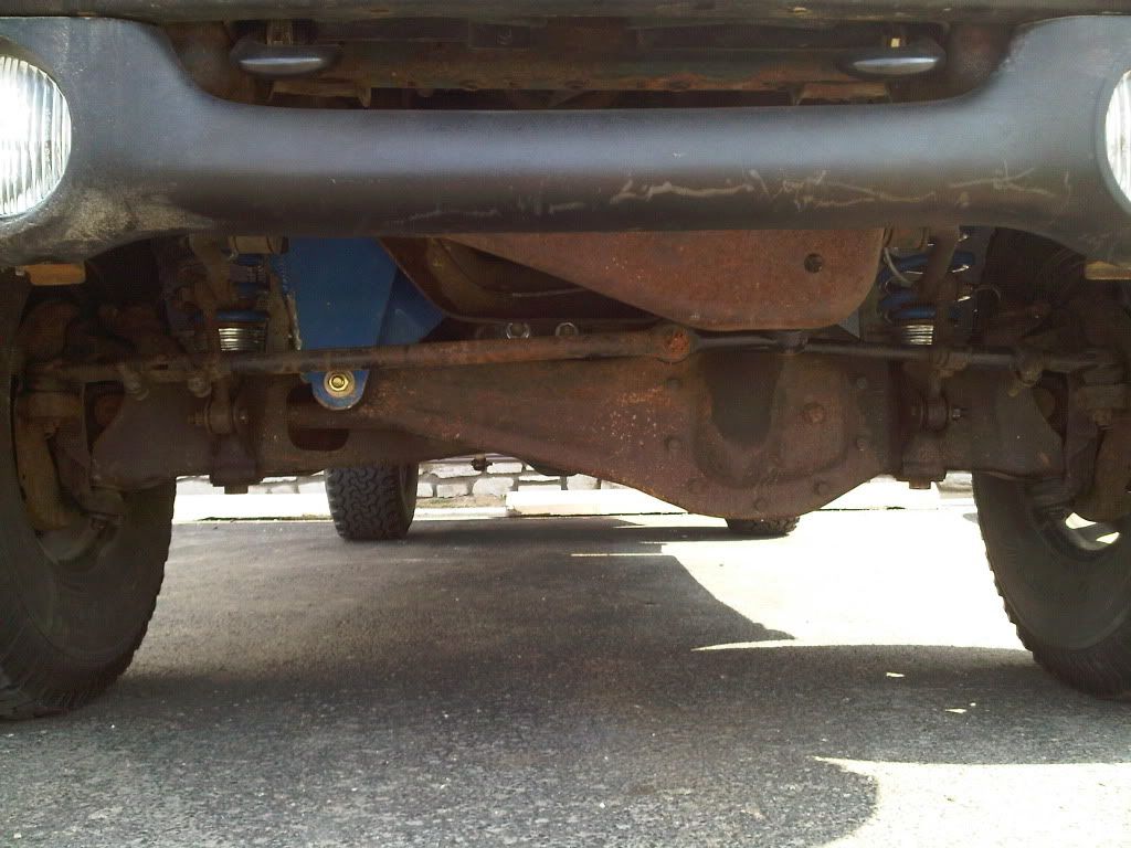

Yep, get the JD stage 1 and get a drop pitman arm. The drop pitman arm I got drops the steering linkage 2 inches, which is dang near perfect. Here's how my steering linkage looks with the drop pitman arm (and I had to use about 1" of spacers to get the height right because of my 4.0L supercab's extra weight so its still slightly high). Notice the steering drag link is nearly horizontal
Without that drop pitman arm the steering drag link would be at a steeper angle which would give you some crappy bumpsteer.
