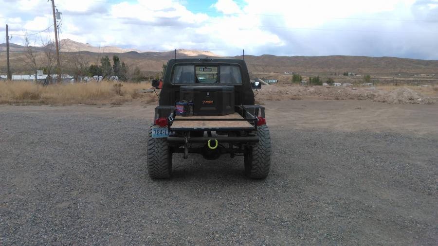

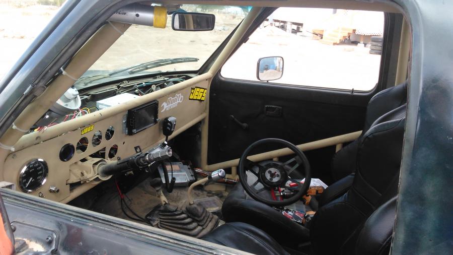

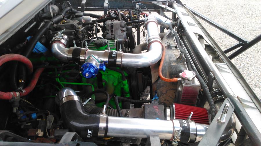

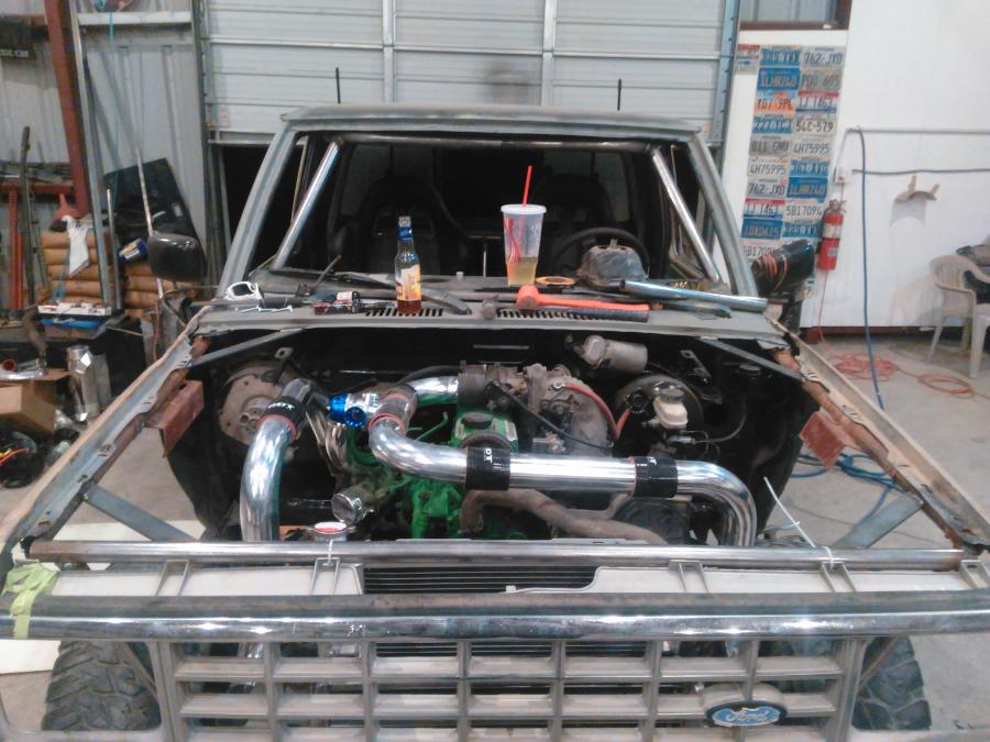

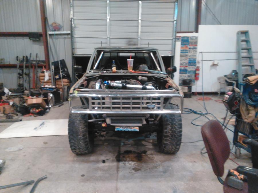

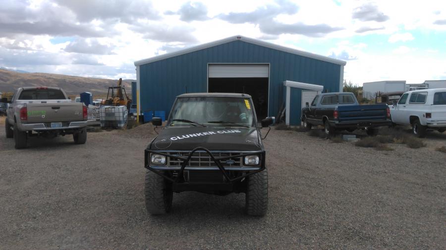

some progress on my 86 ranger and some info is its a 86 ranger chassis short bed 4x4 I started with I rolled it and put on a 87 cab just beat the crap out of it and decided it was time for a build, I ended up with this so far I lowered the floor 4" to make more head room hole new tubed front clip , 2.3t engine and wiring harness , roll cage , 33x12.50r15 tires , 3" exhaust and a lot more I cant think of at the moment just ask

the front of the frame is boxed in
linkin locked front and rear diff since I have manuel hubs I locked the front
monster tach
touch screen navi
sat speedo
jegs cage in 1 5/8 DOM tube
homade bed
drill steel 4" bumper
3" turbo back exhaust
4 point harnesses
new glass
ricer exhaust tip for fun
87 TC 2.3 swap and entire wire harness swap
front mount intercooler
mustang 5.0 injectors
gutted intake and port matched intake and exhaust
removable steering wheel,
duel core tig welded aluminum radiator
just a few of the things I an think of it is 230 am im at work thinking about it so figured id throw up some pics
I like it. How do you like the 2.3t in an off-road truck? I'm putting one in mine.
thanks yea was going for something different other than a 4.0 swap or a 5.0
swap, I ripped the cam seal the other day when I replaced the cam so I gotta fix that next but slowly coming along

Im a fan of your interior and dash setup can u post up more pics. I think im gonna do the same style setuo in my 1st gen but my cab is wasted idk if its saveable
Sent from my SM-G930P using Tapatalk
Yeah give me about 15 min so i can get to my computer i have about 6000 pics of this truck lol
