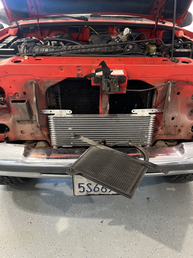

There should be some foam insulation strips on the sides of the AC condenser that sort of create a seal to direct air through the condenser and then through the radiator... if those are gone, the system efficiency will suffer. Check for a pile of leaves between the radiator & condenser as well. It might be worth pulling the radiator out and washing out the fins, they collect an incredible amount of dirt and crap that is hard to see.
Some trucks have additional air baffles behind the bumper and behind the grill that will direct air into the condenser. Yours should. Those will help a lot.
My Explorer and one of my Rangers were both getting uncomfortably warm with the AC on and both were missing the foam insulation. Explorer was missing the baffles (I think I took them out, but who knows.) I put new foam in there and replaced the baffles and both work perfectly now. The foam by itself made a huge difference. Air just sort of cavitates in there without it.
