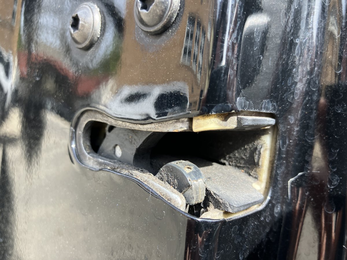

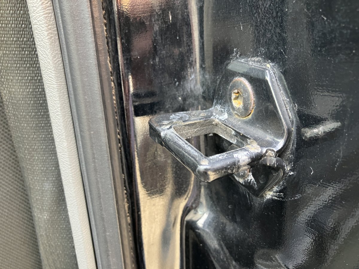

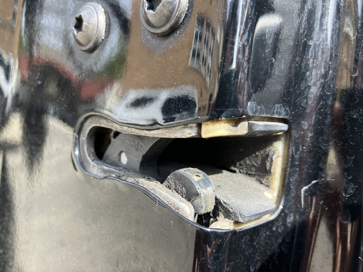

I’m not sure if they changed the design at some point, but the latch pin on mine is a black-painted metal loop. There doesn’t appear to be a place for a bushing to go, so perhaps the newer trucks just have doors that feel cheaper to close? I looked at a couple pictures from listings on Bring A Trailer just to see what the striker bolts looked like, and none of them had bushings. I’ll take some pictures, but they don’t seem particularly worn.
Gaskets are probably a better bet, especially since I’m getting a fair amount of wind noise. I saw an old post about inserting small diameter vacuum hose into the gasket to avoid the PITA and cost of replacing them, so maybe I’ll try that.
Definitely changed at some point then. Mine is a single stud with a plastic bushing. Seems like it would still need some kind of cushioning somewhere.
If you don't hear the doors rattling, how do you know they're still on the truck?
Here’s what my latches look like. Nothing here looks particularly bad to me. I’m not getting any up-down play in the hinges, so I don’t think that’s an Issue. I’m wondering if it makes sense to try some type of diy bushing out of pvc pipe or something. It’d have to be pretty thin. The gaskets do seem pretty flat.

that looks fine. maybe its just the door gaskets?
