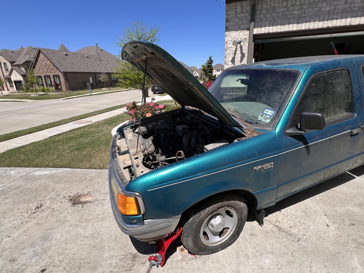

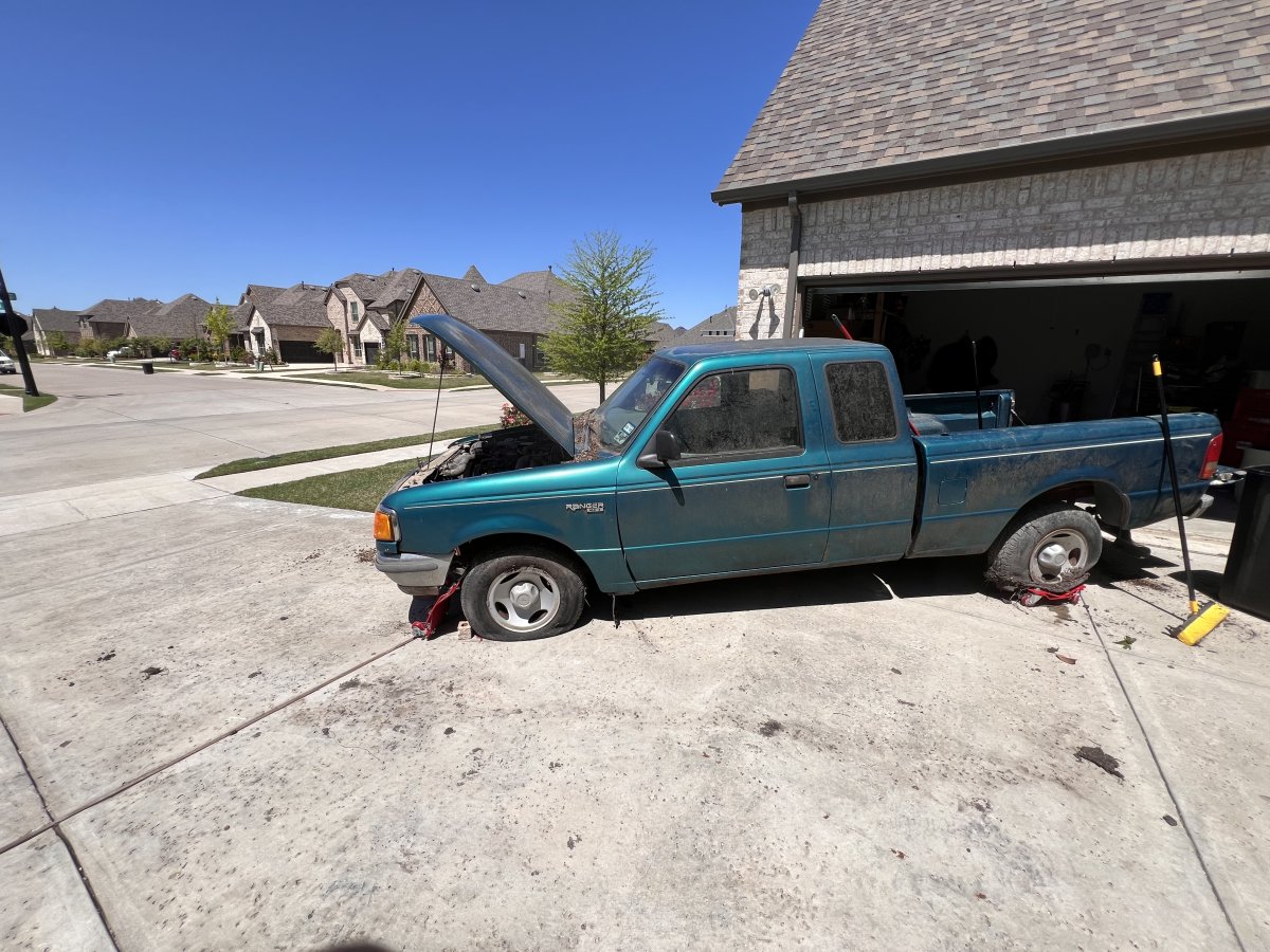

The tow truck dropped the Ranger off earlier today. Getting it in the garage was...interesting with four absolute flats lol
I made a list of items to get done to bring it back to life. Would love some feedback on any items that are missing and/or that are not needed.

Do you have any air compressor at all? Try pumping air into those tires just to ease moving the thing around.
