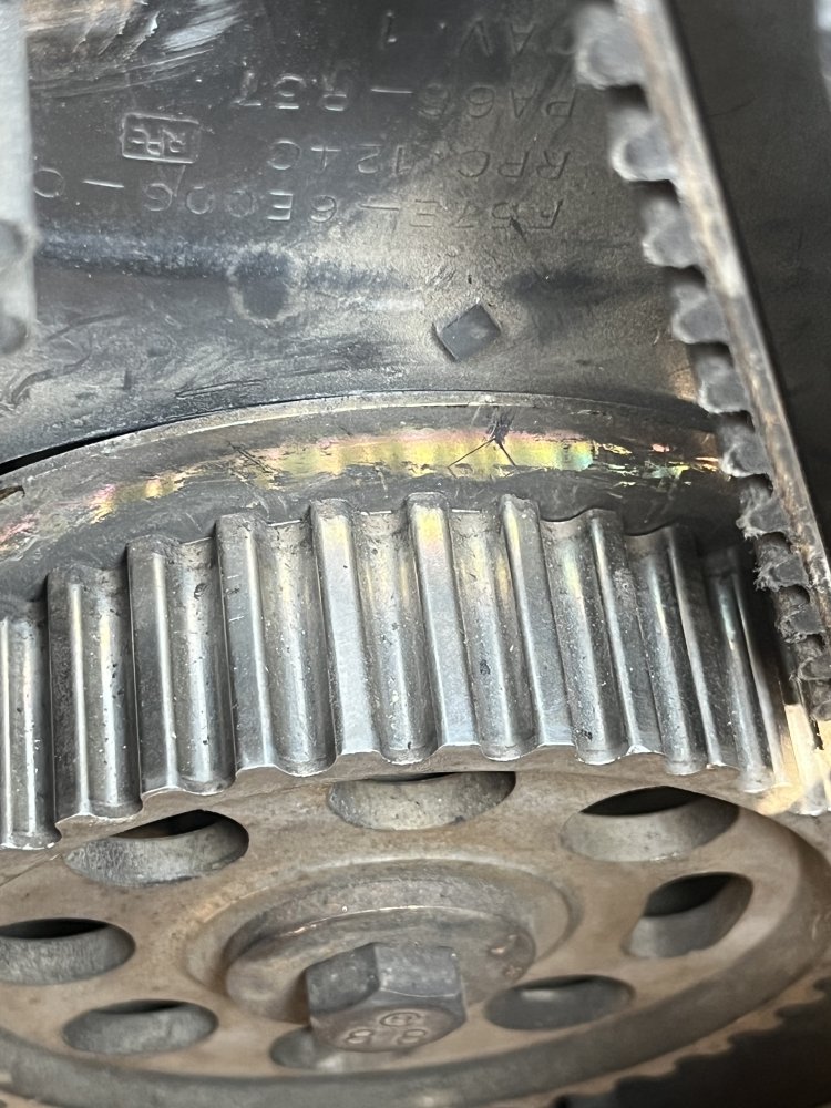

It keeps jumping a tooth or multiple teeth once I tension it I think it’s something to do with the oil pump it has some play only where the teeth are sopposed to line up though.

I was out of town for the weekend. On a '96 you need to line up the oil pump pulley as well as the cam pulley, one's a triangle and the other diamond (both have both shapes, your picture has the diamond lined up, don't remember which that is).
I would pull the codes too if aligning the timing doesn't work. Roseburg is way away from me, if you were local I would help...
The best way to check the timing marks is to line everything up with the tensioner just on spring tension then rotate the crankshaft two rotations until it's marks are lined up again and make sure the other two are lined up then tighten up the two bolts on the tensioner so it's solid.
