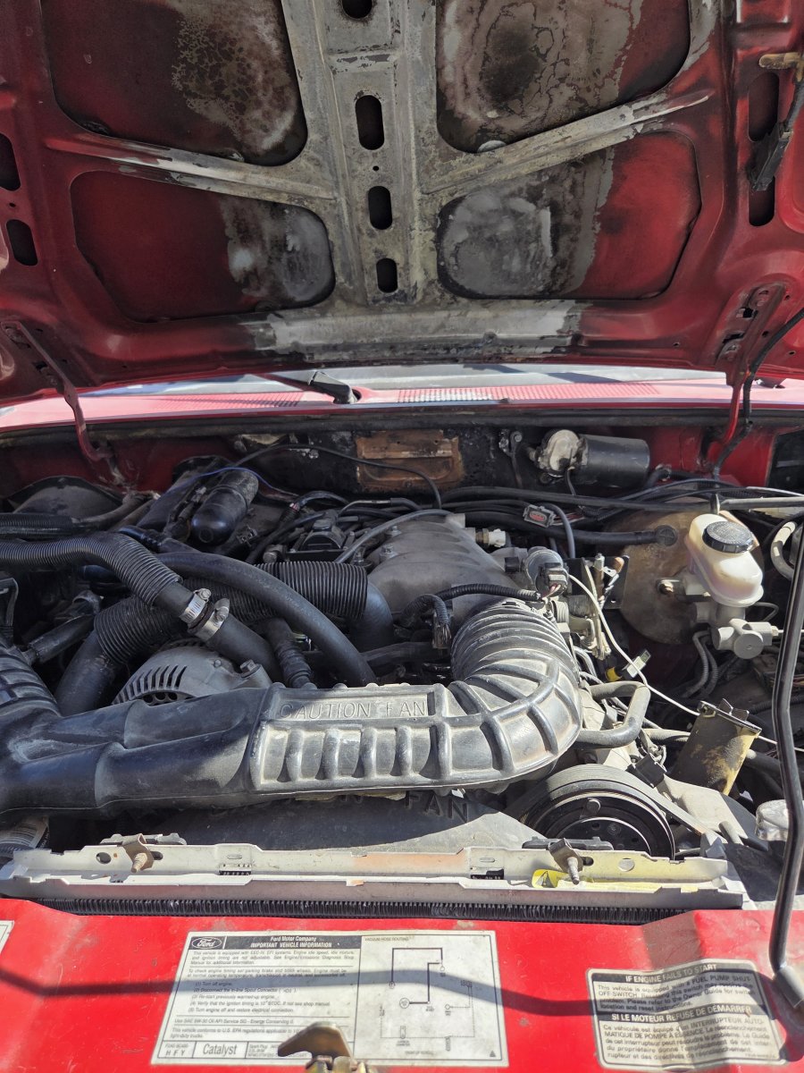

ok so as you can see by the hood about where it burnt. I think they replaced the intake and pulled & swapped one of the heads. Also if you look at the starter solenoid one wire is off and when you put it on and turn the key to on, the starter cranks. nothing when disconnected. Chasing wires is a long process but i have time now so.....?

Aside from the lack of pointy ears it looks like a Vulcan to me...

The small wire is from your ignition switch. It should provide power only when the key is in the run position. This tells the fender relay (solenoid) to pass power from the battery to the starter.
I see one sensor on the intake unplugged.
I see one wire harness unplugged.
I see a white wire going to ground on the engine intake, and maybe going to a fan controller or DRL (Daytime Running Lights).
I thought I saw the 2 pointy ears somewhere under there. The solenoid wire normally when connected tells it what to do but in this case when its attached it engages the starter as soon as you turn the switch to the on position. in this case i am not sure if it actually engages the coil ect... I can jump it across the solenoid but i'm not sure its in the run position. guess i could put a plug in one of the wires and watch for a spark. tomorrow i will work on getting the other 3 plugs out and start a compression test. If the valve timing is not correct will it not do a good test? 30 years ago I could pull it. fix it, and put it back together in the same day. Now I have to spend half the day remembering why I was out here if front of the Ranger.....
well at least I now know what eng it is! Thank you all
