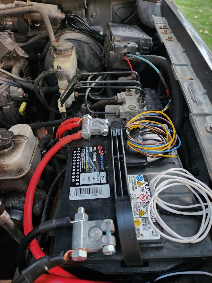

My winch is hard-mounted. So I hard-wired it directly to the battery.I've done lots of research and found at least 10 conflicting answers, so I'll ask here. What do you guys use for wiring on a winch? Mostly looking at 12k stuff since that's what I have, but am open to suggestions from anyone. I'd really like to use Anderson-style connectors and run something to the back to allow the winch to be used that way. I would probably also make/buy a set of jumper cable adapters.
For a removable setup, at the front, I would recommend wire the same size as what comes with the winch. Or whatever they recommend in the directions. For the cable going to the rear, It may be wise to go up one size to reduce resistance and voltage loss over that length of circuit. Not sure how important that is in this case. If all you ever do with the winch is short bursts with time in between to let wiring and motor cool, then that may be unnecessary. But if you think it will see long pulls, the bigger wire is a good idea.
With the wire sizes involved in winch wiring, I would not recommend soldered splices and connections unless you are good at doing it with a torch. There aren't many consumer grade soldering irons/guns capable of supplying the heat for that size wire. Properly sized and properly crimped connectors with sealed heat shrink is the way to go.
