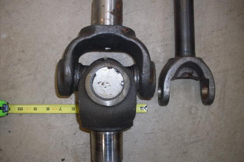

5-ton on the left, chromo d60 stub on the right. thats what it takes to turn a 500# wheel and tire combo.
So...now we are comparing 5 ton axles to the D60 and D35/44?
