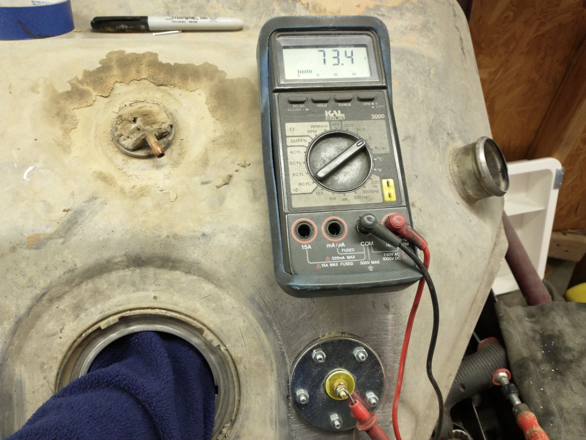

Issue #2 is fuel sender resistance changed with Ford from the 1986 to 1987 model year. Early senders were 73 ohms empty, 10 ohms full. Late senders are 16 ohms empty, 158 ohms full. The vast majority of stock EFI pump/sender units have the late resistance scheme.

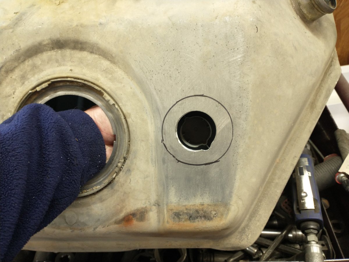

My solution was to remove the fuel tank and drill a hole for an aftermarket fuel cell type sender.
75557

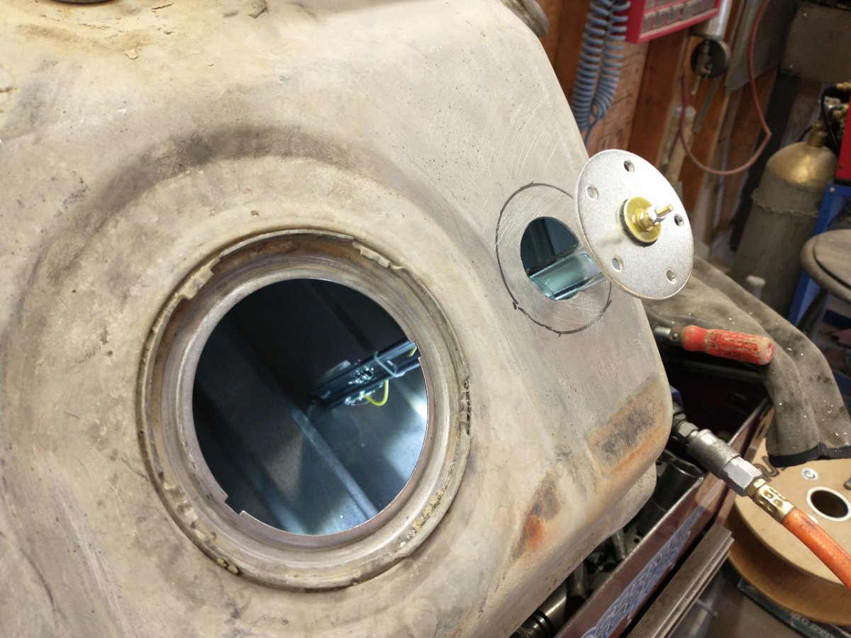

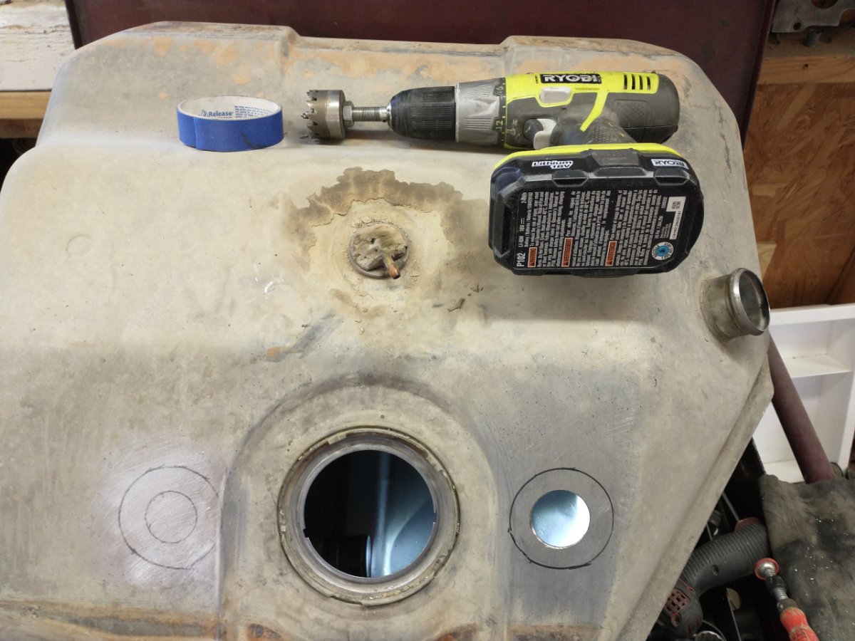

You have to make sure there are no fumes in the tank before drilling. I drained the tank, wiped the inside with a towel, let it dry overnight, then stuck an air hose in for fifteen minutes until I could not longer smell fuel before drilling. I held a paint can cap against the inside of the tank to catch sparks and swarf from the hole saw.
75558
75559

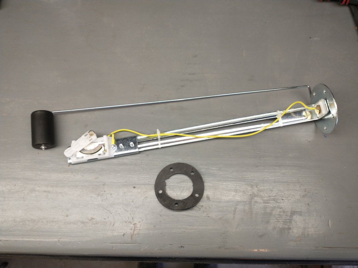

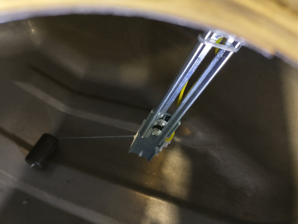

The sender is universal and will probably be too long and need cut to size.
75561
After all drilling I vacuumed the bottom of the tank, checked empty/full resistance and bolted everything together.
