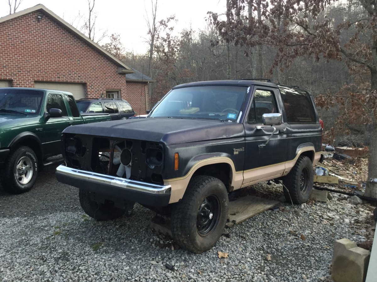

As it sits, 1988 Bronco II Eddie Bauer. 2.9 block under the hood (just the short block), A4LD, 1350e, 3.73 gears in open/open D-28/7.5”, 30” tires, 2” suspension lift, slated to get a 1” body lift too.
My original plan (after I scrapped my first attempt at going 4.0 OHV) was to do a sort of resto-mod all around and try tweaking the 2.9 (free-floating rockers, headers, MAF conversion, etc) plus a shift kit and valve body work to the A4LD. Back when I started fixing it up, I bought a pile of parts, so either in the truck or around the property I should have nearly ever piece that I need to do that short of some interior stuff. I’m talking wheel bearings, U-joints, every brake component for both axles, engine V-belts, AC stuff, sensors, seals, gaskets, body mounts, suspension bushings, shocks, etc. I ended up having some health issues and the project got put on hold a number of years ago. I’m really annoyed at it still sitting with a pile of parts so at some point after I fix the dump truck, I’d like to get back to this thing.
The past few days I’ve been working on getting this thing prepped to move, it’s in the way where it’s at in the driveway, it’s going to be a good few months before I can dedicate time to it, etc. Finally got the drivers side extended arm positioned and welded (still needs plated but it’s solid enough for now), have to secure the transmission and body yet. So I’ve been kinda climbing all over this thing to prep it and I’ve started having some thoughts. Especially considering a few things that I’ve decided on changing from my original plans and in light of the fact that drivetrain parts for this are starting to become a bit obsolete. Also, I’ve discovered that mice and bugs have been using the short block as entertainment plus some water has found it’s way into the cylinders, so at best I would probably have to pull the block, pull the oil pan, clean things up, and put it back together. At worst, the block needs rebuilt and/or is junk. I’m also suspecting something is broken in the transmission, hopefully just the parking pawl, but possibly something more because park doesn’t hold.
