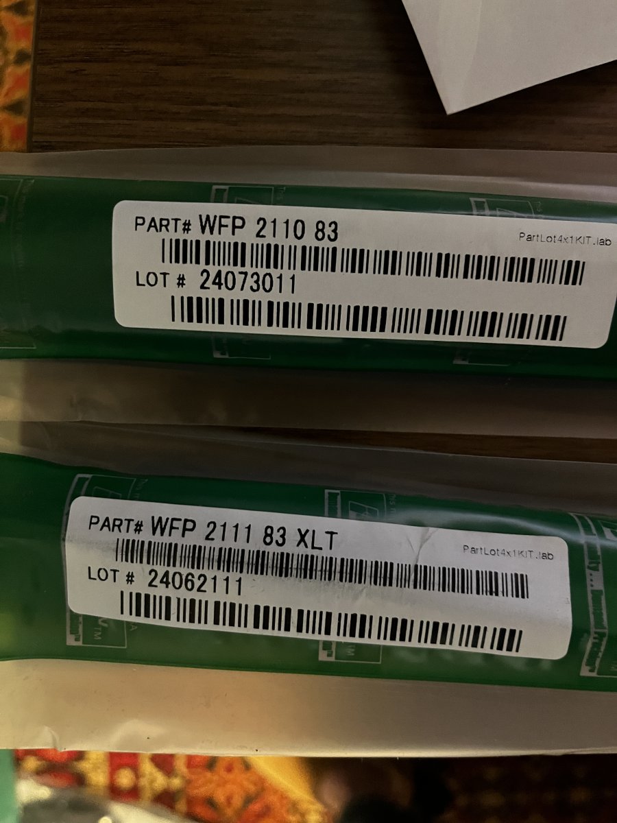

Thanks - Yeah I was talking about getting the old parts out that are the following

I have been running into that.
I have an XLT with no triangle vent window.
Bought a set from Precision and the trim for each side read differently.
And used the option of no triangle and XLT
I got two different part numbers in the set.
Returned it and exchanged.
Got the same two diff part numbers.
No I just assume that is correct. We will soon find out in a week when i try to install.
