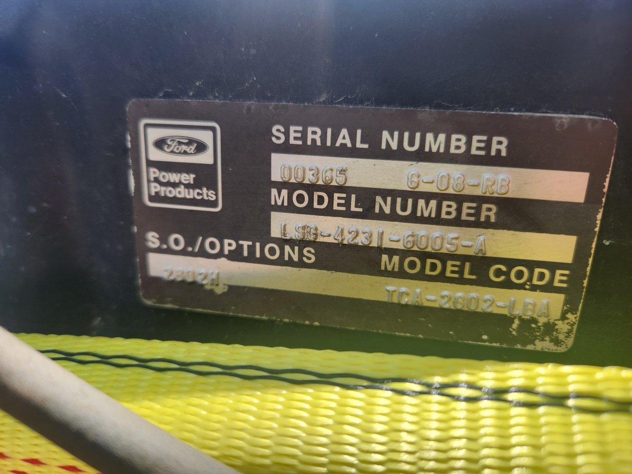

This plate is on the side of the valve cover. Don't know if anyone can decode any of this stuff.

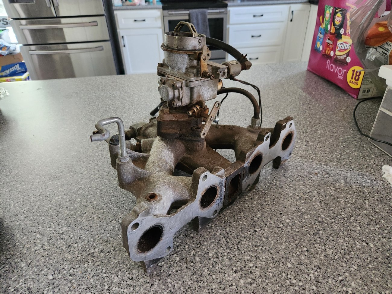

The generator intake with it's Zenith carb.
Generator intake with 1bbl Zenith carb

I see a difference in the intake runners. One is round, one is d shaped.
both intakes look like they can be taken apart into pieces, where the carb mounts. maybe you can run the original generator one with the upper parts from the mustang intake and than use the 2100 carb?

It's my understanding that you can use the D-port intakes on the round port heads. Is that wrong? I hoped to use the D-port intake as it's the only one that supports a 2 bbl carb. The generator intake is cast for 1 bbl. This image gives an idea of how the ports overlap:
I don't pretend to understand what's best for power. I'm sure the port mismatch will cause some issues with flow, but don't know if it would outweigh being able to go 2 bbl.

as for the inktakes, if the bolt pattern is the same it's likely close enough, check that and the coolant port in the middle
