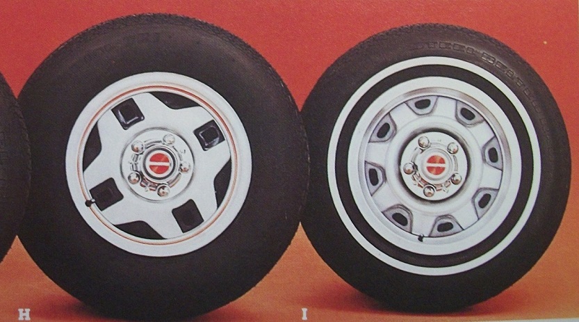

Picture from an early Ford sales brochure, these are the steel (road) wheel styles used on early Rangers and Bronco II's:
The "4 spoke" steelie on the left was used on 1983 to 1987 trucks, Rangers and the Bronco II, in 14" and 15" (the B2 was 15" only, I believe).
The 8 spoke steelie on the right was much more common, and came in 15" and 14". It could use a chrome trim ring, as shown here. This style was used on '83 to '91 Rangers, 1984-'90 Bronco II and '91-'92 Explorer (later two, as 15").
I don't know what styles or sizes that any of the other Ford models used (i.e.- Aerostar, F series, etc.), and I think that the Ranger bolt pattern was kind of unique.

Actually the ranger pattern is kind of commonish in Ford land. Last I knew the mustang is still using it.
