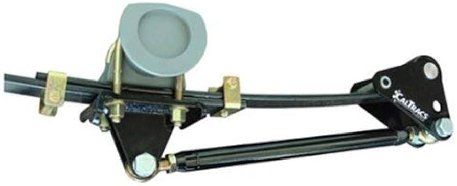

Just FYI, the James Duff bars won't work (without modification) if you're still planning an axle flip to lower the rear. The brackets won't work:
For spring under axle setups, Caltracs would be the best off the shelf option:
I'm sure you will enjoy those traction bars. They're not that expensive either.
