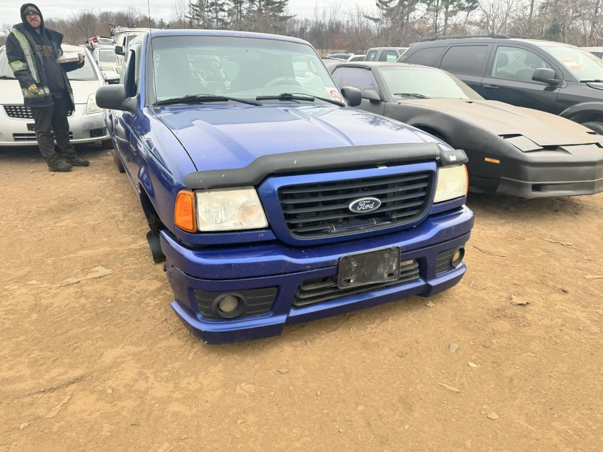

I just saw that you're Canadian, a Ranger STX is going to a Toronto pick n pull soon.
If you're desperate to get your hands on one maybe you can figure it out, but I've asked the folks on the Ontario Ranger facebook page to snatch it for me in exchange for a profit but no luck.

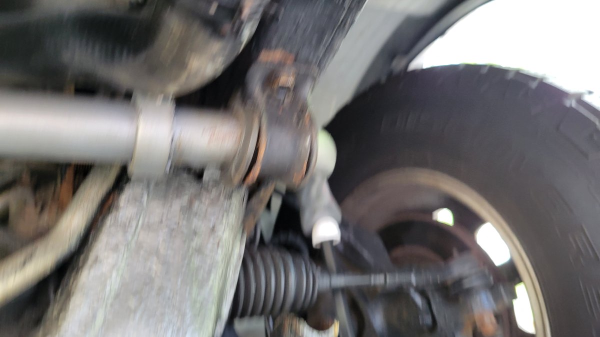

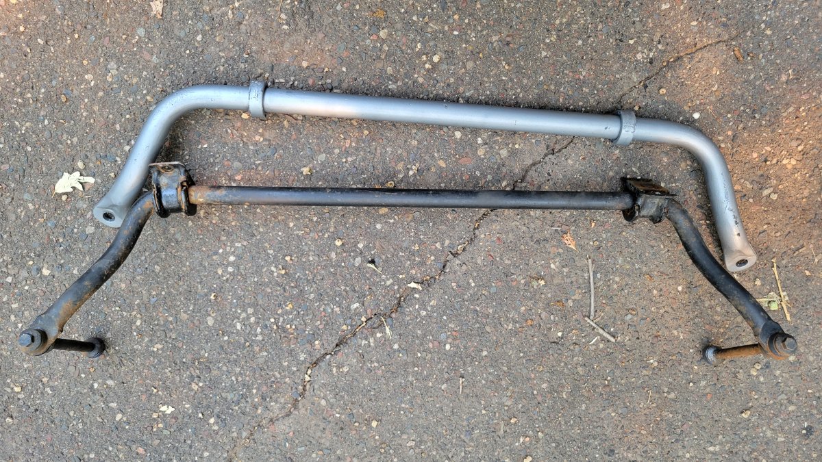

No, some bars are different. I just added a photo which might explain.
Here's a very bad photo of the Explorer bar mounted in the Ranger front end. I used the old brackets but squeezed them down tight around the thicker bar. Note also the new link pin with the white polyurethane bushing.
